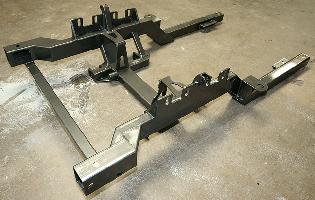

I have a sufficient pile of parts to start the process of turning Penny in a road warrior.. I'm just so damn ready to have a car to drive.. HARD! lol
Here you can see the 21st Century Street Machine Subframe, C5 parts, double adjustable Varishocks and AGR rack/pinion.. woot!
I have figured out my LS2 woes, the special T56 is in the house and brakes are on the way from Wilwood.. Afco is busy making the radiator and parts are flowing in.
Car is at a great shop in San Diego (Best in Show) and the she is just about ready for the new firewall and larger trans tunnel. After that she is off to party in Vegas with the guys at ATS then back here to get the front sheet metal hung.
So many details to keep track of but at least there's progress

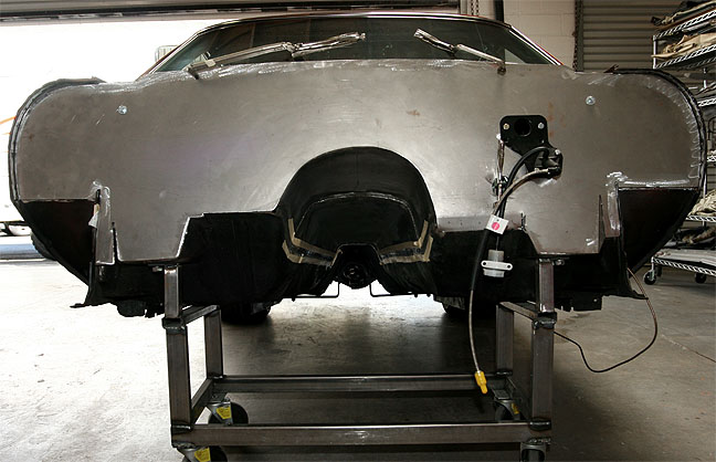

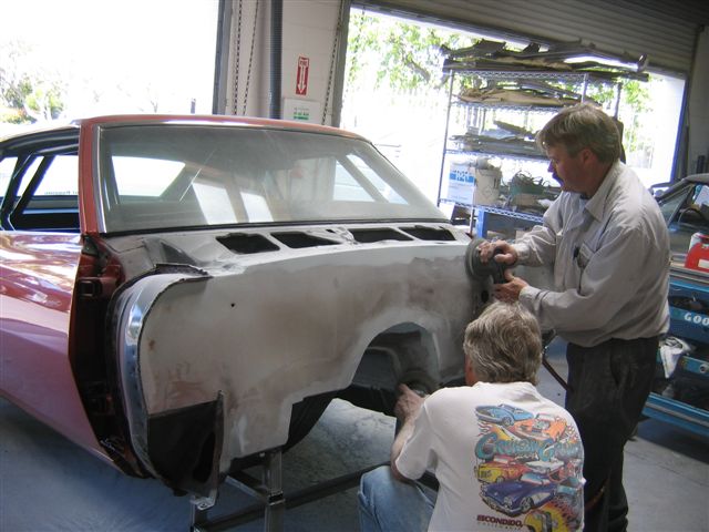

Originally Posted by Roger Poirier
Steve, What front sheet metal, When you shipped it out a few weeks back in had the front fenders on it. What are we talking about here? Why a new firewall? Did you have to move it back to fit the new engine?
Questions, questions, questions...
Well, you know how I just can't leave well enough alone
we pulled the front sheet metal and we are completely smoothing the firewall.. the only remaining holes will be for the MC and the steering column, even the wire block is gone. the inner fenders and firewall will be shot in body color. I also have a core support closeout coming from DSE. I haven't decided what color I am gonna paint it.
The only mods needed for the subframe was a slight enlarging of the trans tunnel for the T56 (21st Century supplies the pre-formed parts).
The shop just recieved in their new tool to cut heavy gauge steel so my firewall should start next week.
As she sits now..
