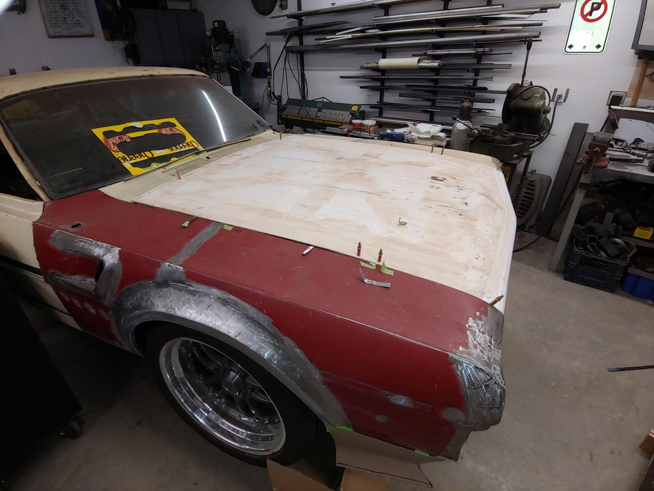

More progress... good times. Started building a fiberglass hood for the Torino way back. Had a plan of fiberglass hood and making it a cowl hood for space for the intake I was going to build. When I had the car on the ground to get an idea where I was at I laid the hood and cowl on it to check it out.
It just looked wrong.
So back to thinking about what to do....

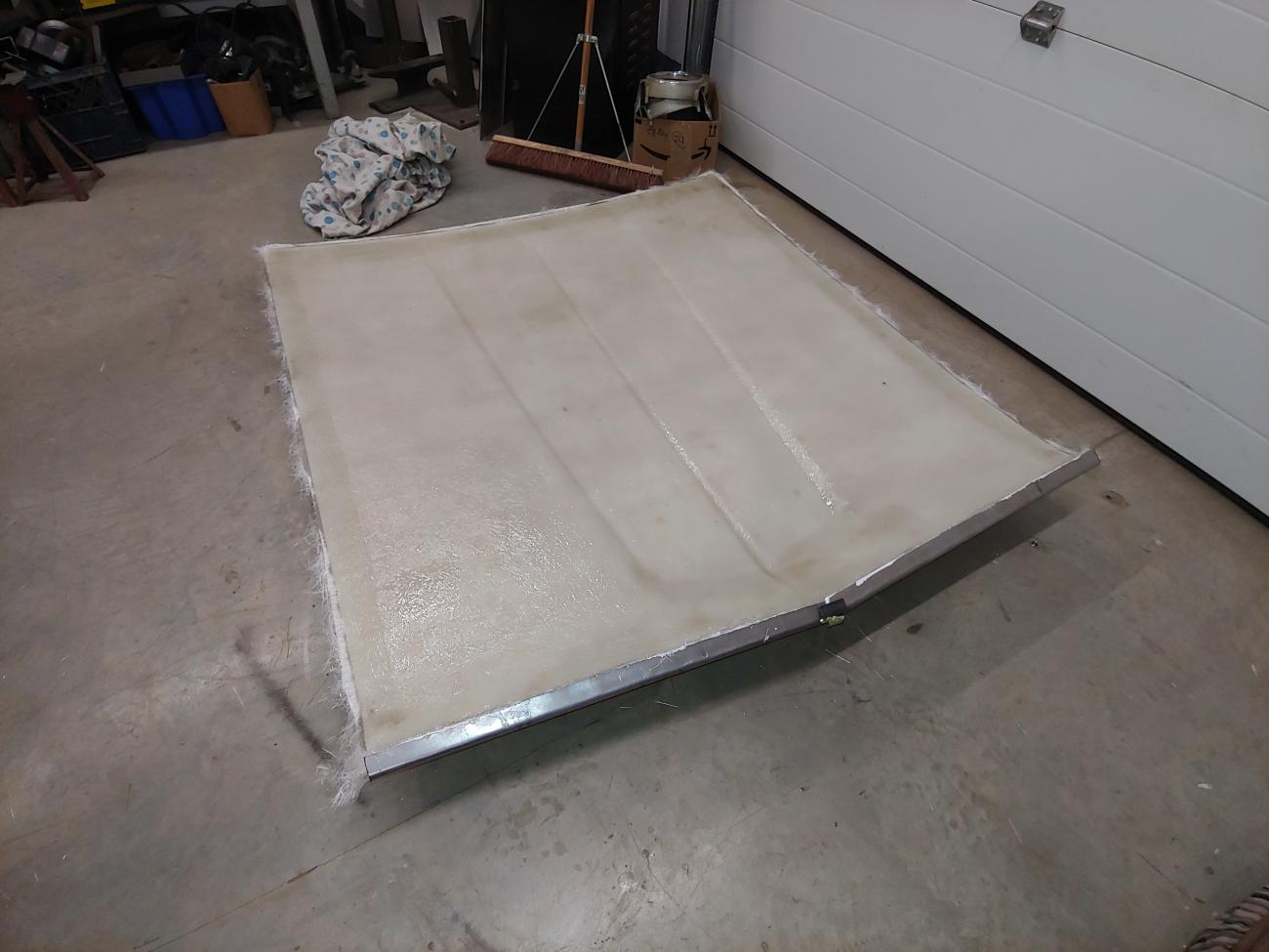

Checked into just buying a stock flat fiberglass hood. The truck shipping to Canada was insane so I had to make it myself. I can't justify buying a hood that's going to get modified anyway... might as well make my own exactly how I want it.
I did have a stock steel hood that I split the inner from the outer to use as my molds. Just grind off the pinch weld, clean it up and lay down the gel and glass.

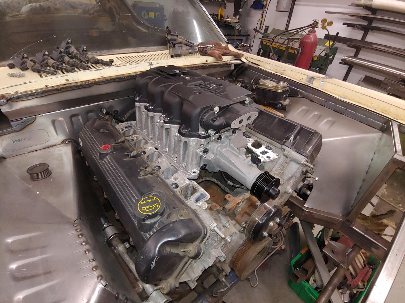

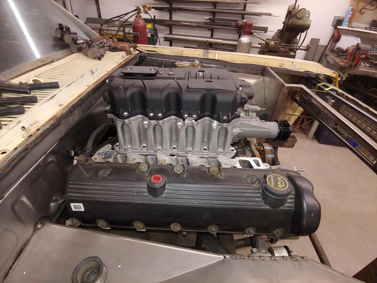

This is the M122 sitting on the engine. Its off a Caddy. It has an 8 rib belt drive and the V10 has a 8 rib drive on some applications so that will be easy. Besides making an intake the alternator will need to be relocated on a custom bracket.
The Caddy intake is cast as part of the supercharger. I will cut all that off to make room for mine.
Also in these pics the firewall and inner fenders are coming together.

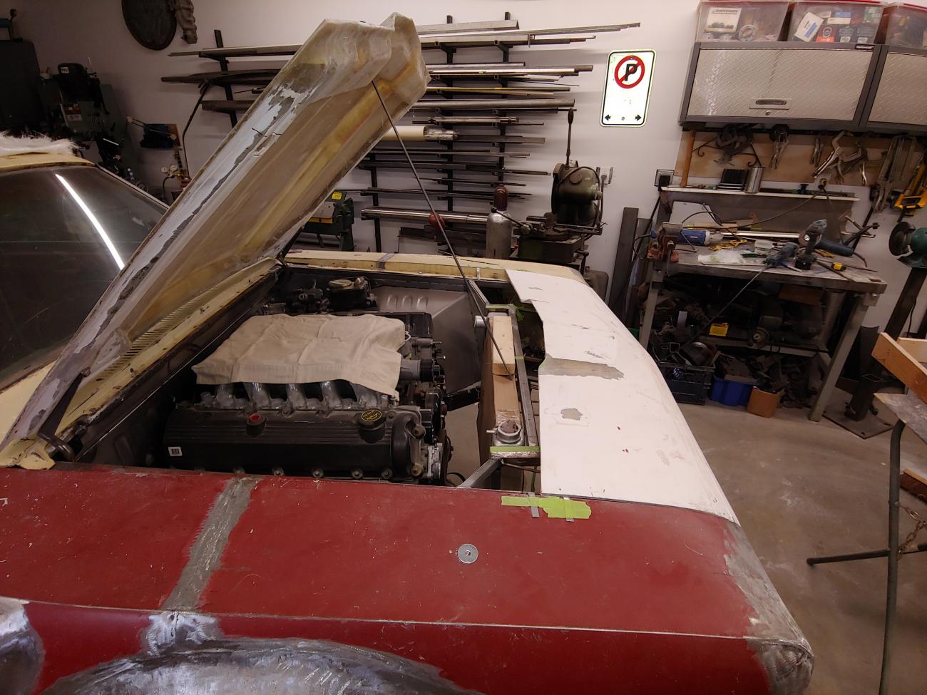

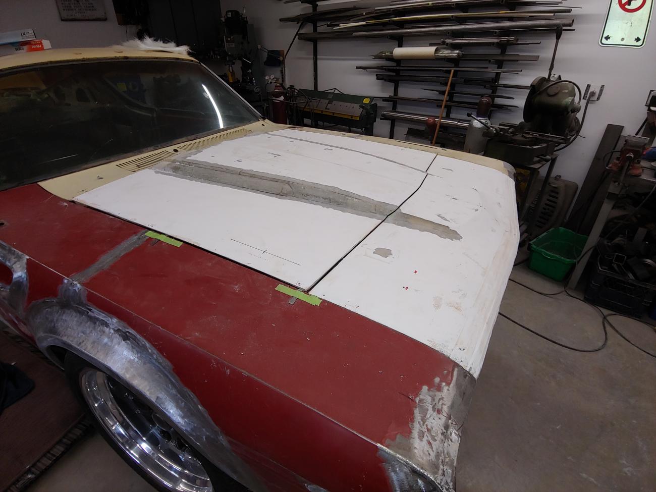

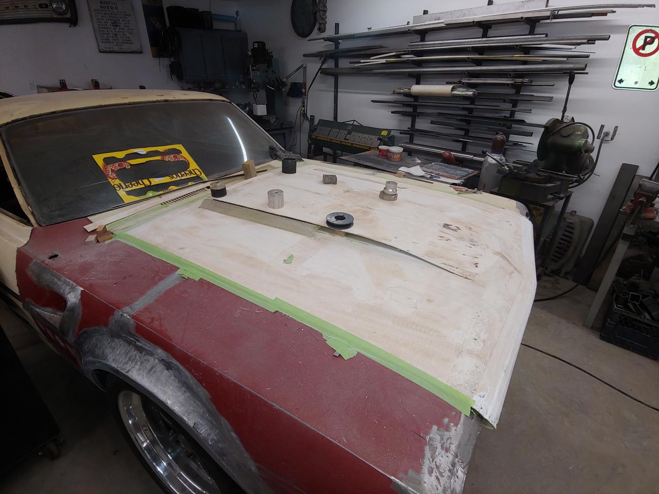

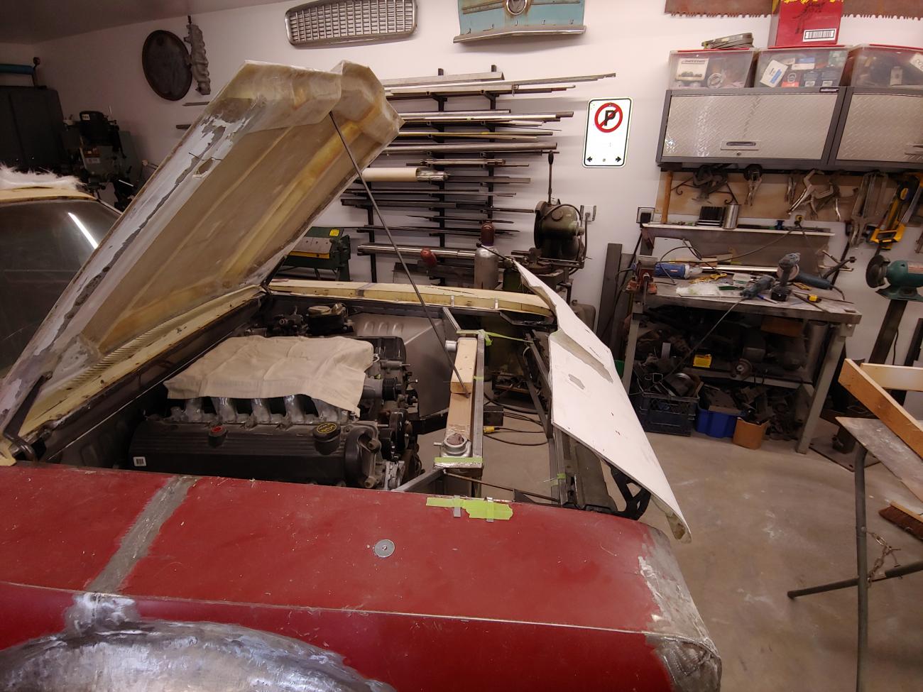

Had a good weekend working on the Torino. Made some real progress on the hood. Its all roughed out and now ready for the fine tuning on the finished product. I'm very pleased with how it turned out especially since it was made with no proper mold.
As you can see in the pics its a two piece setup. The engine section must open first before the front can be opened. The front is just access to PS , overflow bottle and airbox. I wanted the look of the Talledega with the header panel but didn't want the length that it has.
