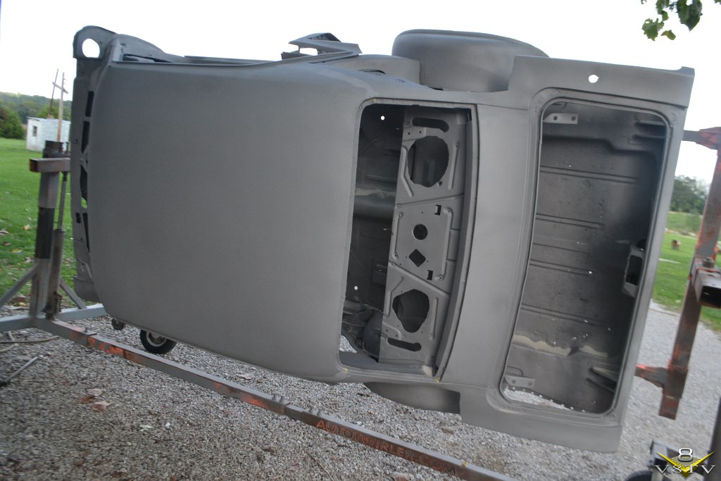

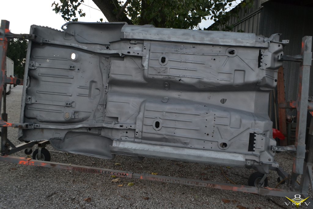

Well, the car finally made it back from the media blaster. I got pretty nervous waiting for it's return. Yesterday I was finally able to go see everything the blasting revealed.
Kelle and Kevin both went over every inch of it with me and explained their game plan to fix it all. I couldn't help but to wonder, how many shop owners these days spend that much time with their customers? I could see one of them doing it but BOTH of them?? I know I'm the customer and all but somehow, I almost felt guilty.
I'm confident that everything will be fixed properly and then some.
Of course we knew several areas like the dash and quarters needed to be replaced. It looks like we will also need some floor pan work and the rear tail was hiding some secrets under bondo.
That rear shelf will obviously need some work because I think finding speakers to fit those particular shapes may be problematic.
All the main structural portions including frame rails and rockers are very solid. The trunk floor needs to be replaced along with the rear panel and trunk floor braces. The rear seat area is solid as can be.
The dash is toast.
Luckily, the dash corrosion did not get into the firewall proper so a new dash kit will take care of all the decay in this area.

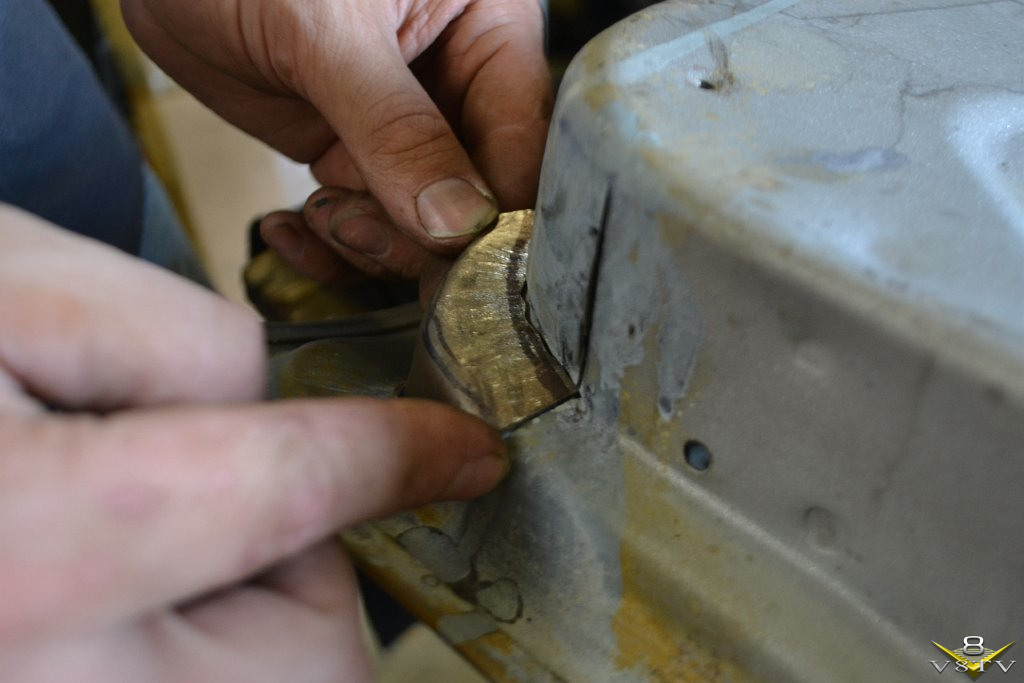

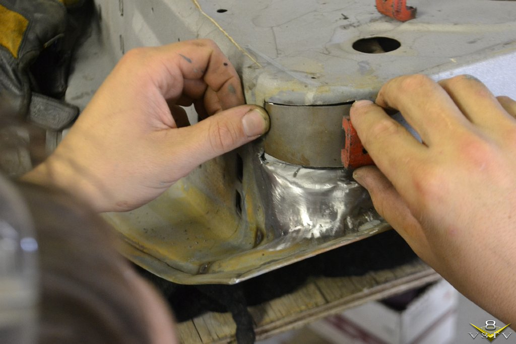

The corner of this door structure needed some TLC.

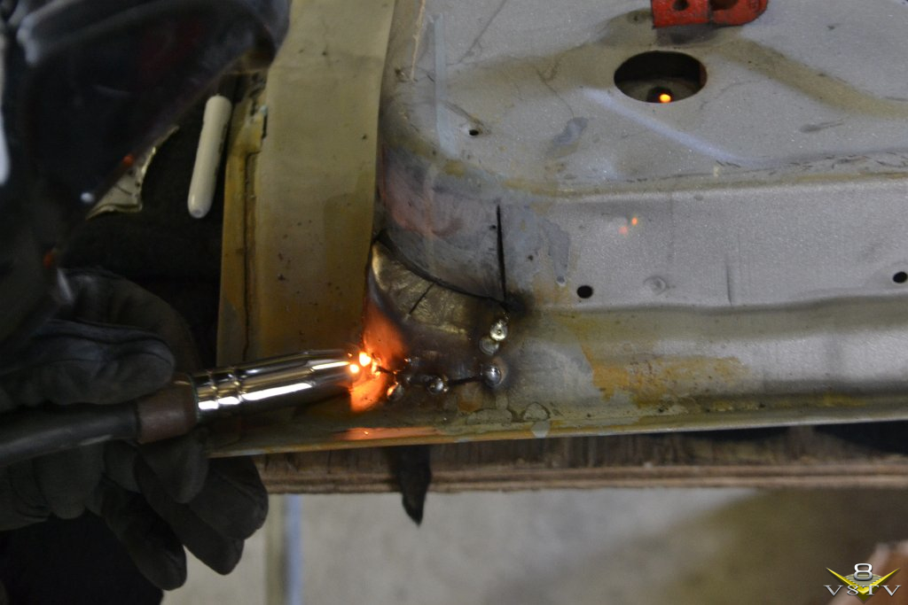

Those are Nick's talented hands carefully testing the fit of the patch he made for the first tier....
Welding it in...
Ditto for the top tier...

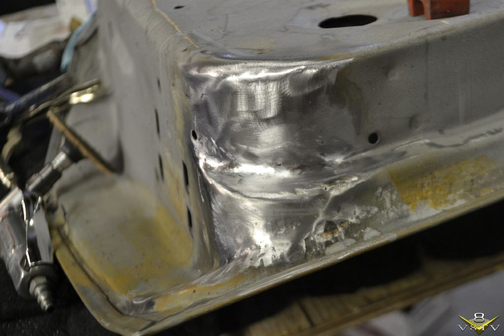

A little clean up and Bingo, no more rust here.
Looks like it was kissed in the rear at one point. Another reason I'm glad the major repairs will start by first putting the tub on the jig to assure everything is right when it all goes back together.
They walked me through their strategy of being very careful about their sequence of cutting things out and then replacing them to assure critical geometries are not lost and so that panel alignment is no harder than it needs to be.

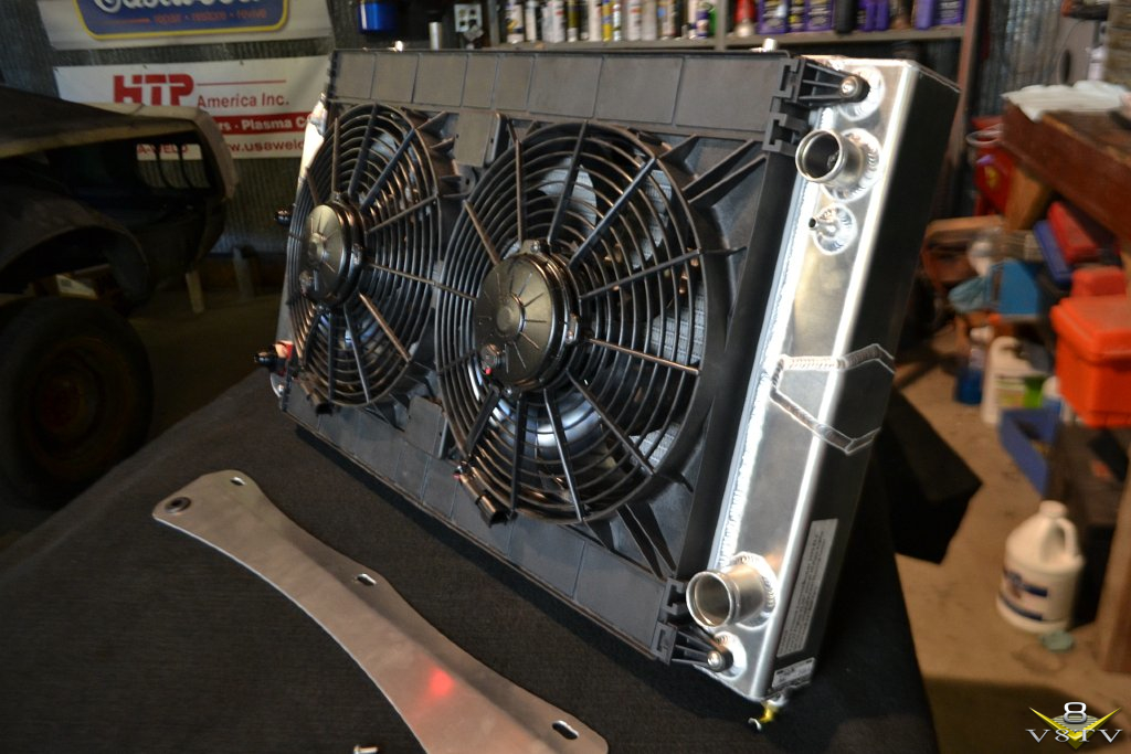

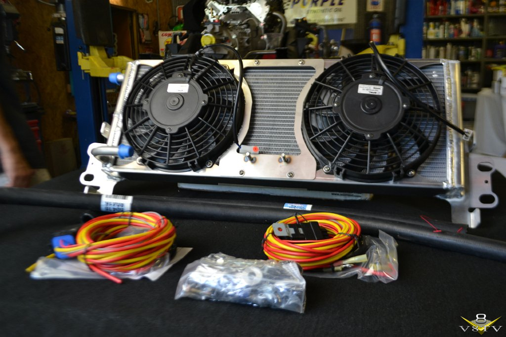

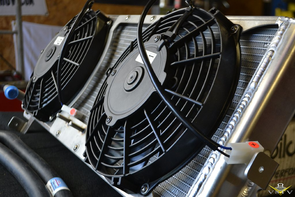

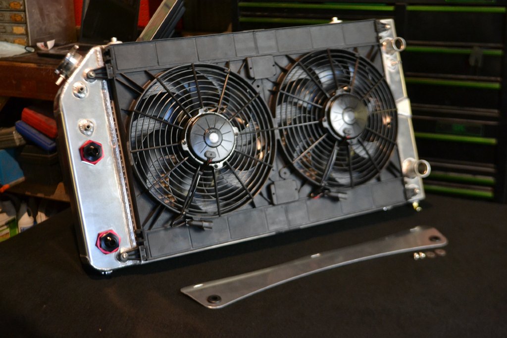

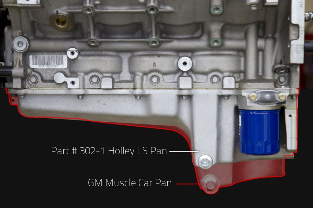

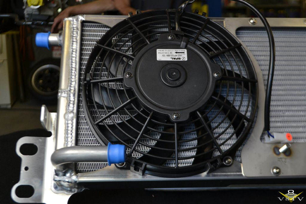

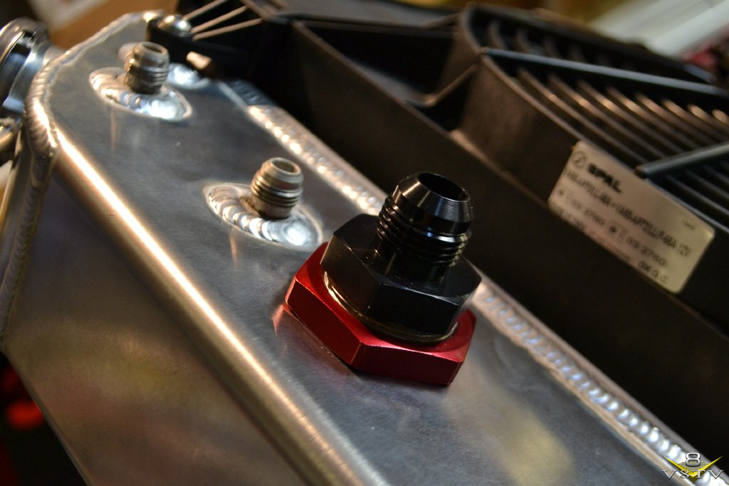

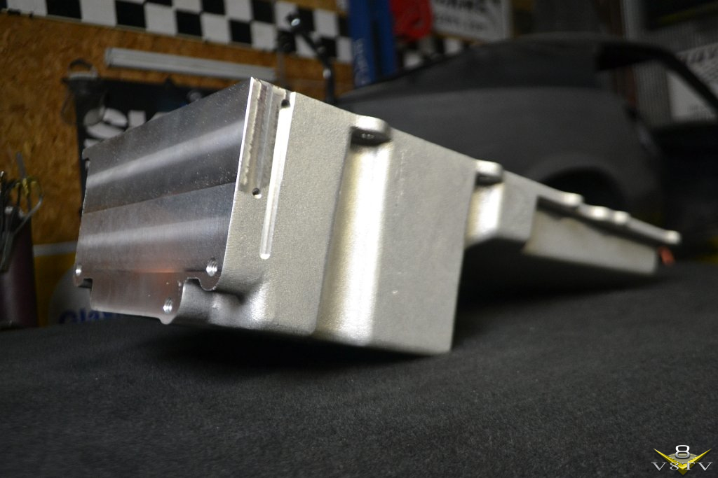

Some more parts have been coming in. Even though we only plan to see something north of 700HP from our Lingenfelter massaged LSA motor, we're specing all major components from fuel delivery to cooling to be able to handle at least 900 HP. (You never know what the future holds should GM introduce new direct injected versions of the LS engine that we all can't live without...or something like that)
Here is our C&R cooling module complete with fans designed to handle up to 1000 HP and drop right in to the first gen. Camaro. It has the oil cooling and steering fluid cooling built in.
Here is our GT 500 intercooler module also complete with fans.

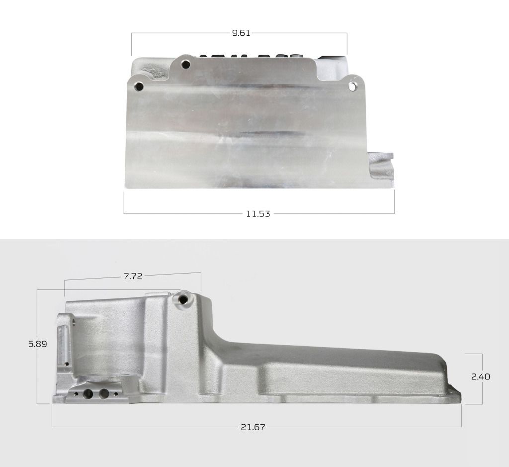

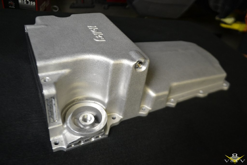

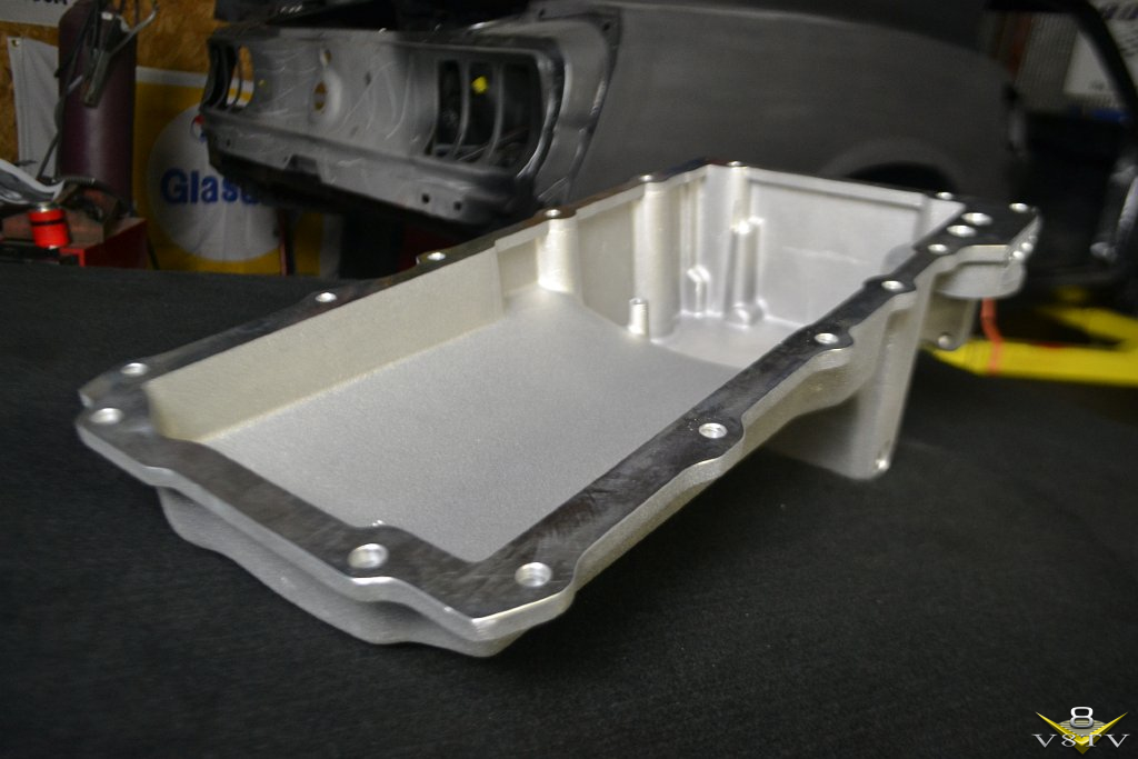

We decided on this Holley oil pan to gain some needed ground clearance.

Is the radiator meant to hang from the top of the radiator support using the bracket shown, or does a lower support bracket need to be made? 1st-gen radiators mount with a side flange to the radiator support vs. the later (bettter) cradle design.

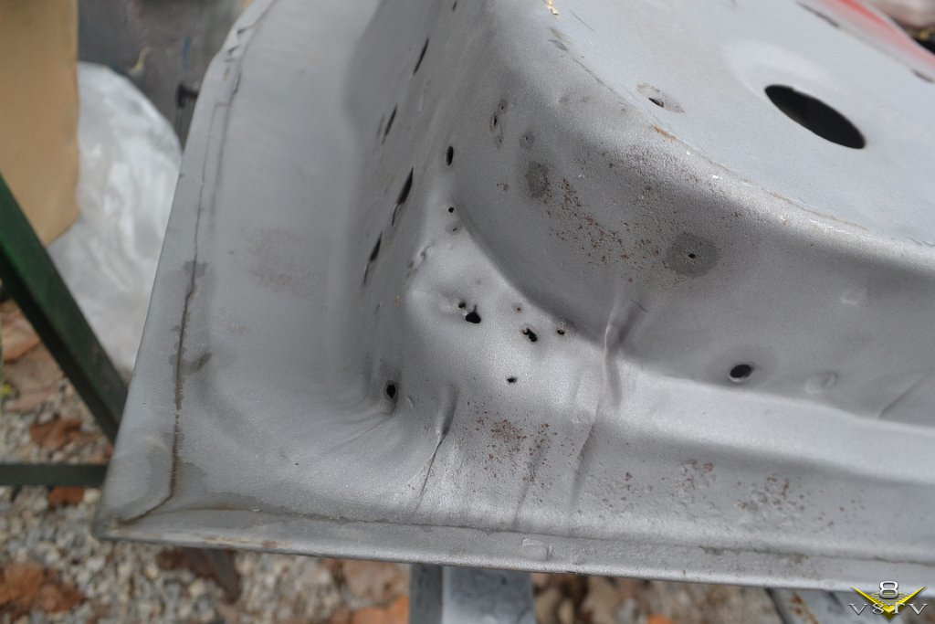

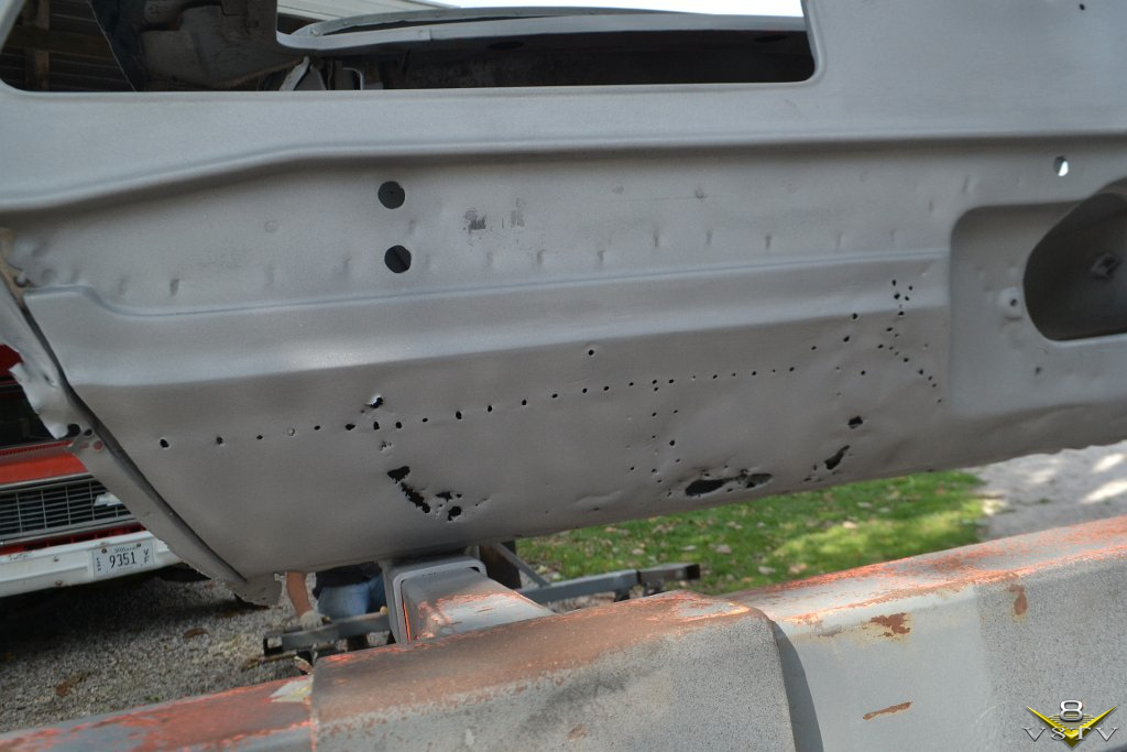

[QUOTE=Lous69;435517]Well, the car finally made it back from the media blaster. I got pretty nervous waiting for it's return. Yesterday I was finally able to go see everything the blasting revealed.

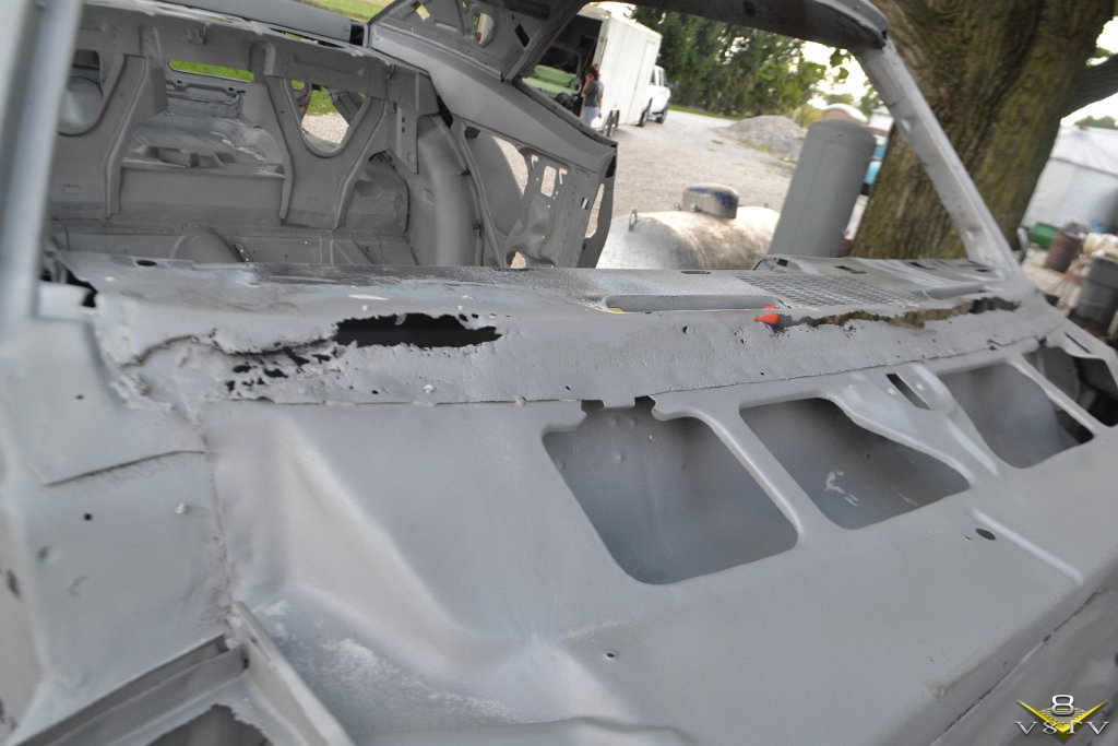

Hey Lou .... you can definitely see 98% of the car after blasting, it's the other 2% you can't see that you should be worried about. Like this cowl to firewall junction ... see the pits were the rust has eaten away the cowl?
I would be skeptical of the firewall junction right below the rust where the seam sealer holds rust.
Just saying ...
