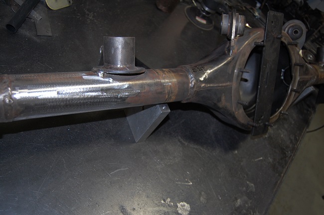

The 9 inch rear we had picked up on the cheap turned out to be for a g-body...brackets are not even close. so...off they go. Looks like we'll be doing scratch brackets and a 3 link rear.

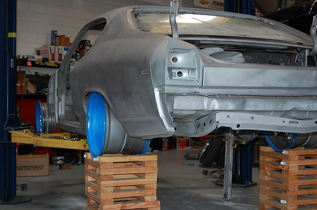

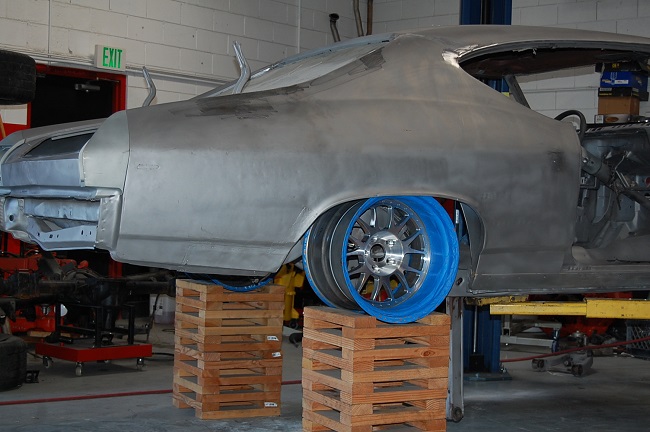

Wheel fitting to measure rear end width. We will be trimming the lip, adding to the wheel house and doing some frame modifications. Shooting for 1/2" to quarter and 1 1/2" to the tub/frame

Always make then tell you what it fits and do this before letting them know what you have.
Anyway, car's looking good, Vince. Is 1/2" to the outer wheel well a good goal to shoot for in general with a car or does it really matter on the car? Didn't know how much clearance needs to be accounted for with rim/tire/suspension flex etc.

Trey tire clearance seems to be a never ending debate. Presume the rear has a locating device and the wheels don't flex (much). The tire when pushed hard will move a bit. I've seen as little as 3/8" but don't trust it, so 1/2 to 5/8" would be my minimum.

It really depends on the car and the suspension. We ran 1/4" on a 66 Chevelle and no issues. It's the inside space where you have to get right. Driveway articulation dictates the 1" minimum.
This car will be running a watts link.

Trey, on a second gen, you would need more room due to the outer wheel house protrudes in an inch. Moving the outer wheel house almost flush with the quarter panel would open up that room.
