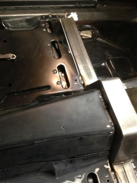

Everything's permanently welded from the seat pan back. Thankfully all the fitting and refitting paid off. Seat pans are level!

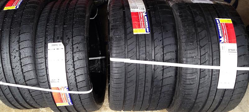

Found a nice surprise when I got home.
  #84
Old 06-26-2013, 11:27 AM
Oh man could I use those! Nice.

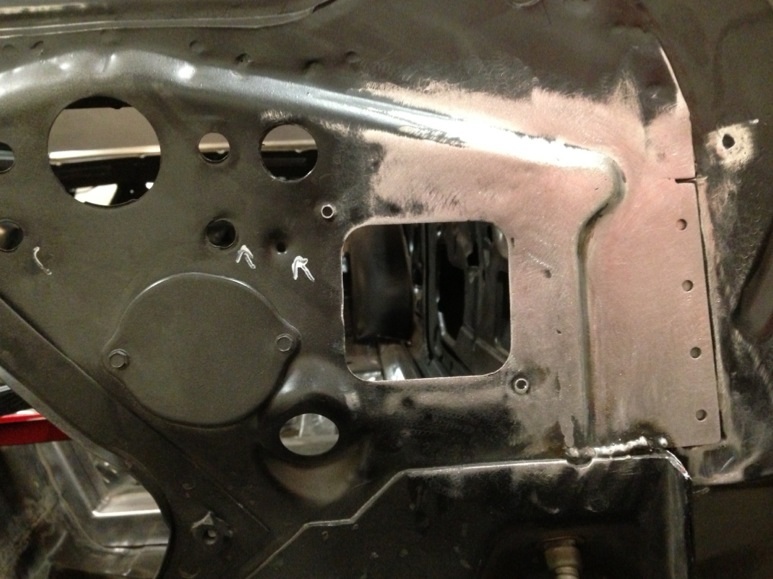

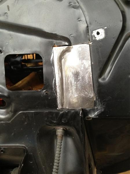

Firewall was torn where e-brake mounts. I made a thicker patch out of 16ga.

The original tore where the metal was thinner around each stamped recess so I made one recess out of heavier gauge metal. I'll finish this up when I finish the cowl box.

Wow your are doing some great work on this!! nice tires, what sizes are you running?
Rick
  #88
Old 06-27-2013, 09:55 AM
MX145 MX145 is offline
Join Date: Dec 2012
Location: Pacific NW
Posts: 441
245/40R18 and 315/30R18.
