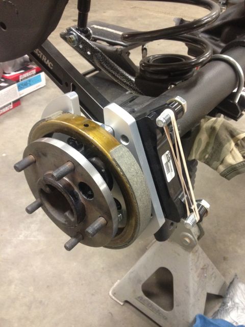

Default axle shafts
the flanges on the rear axle shafts were almost 6.5" in diameter, but baer specs a max dimension of 5.9" for proper fit within the rotor.
the machinist turned them down with his lathe yesterday.
it looks to me like there is enough material behind the wheel studs for this to work alright, but i'm certainly not an expert.
does anyone have any input on this one?
thanks so much for your help.
danny

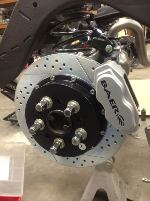

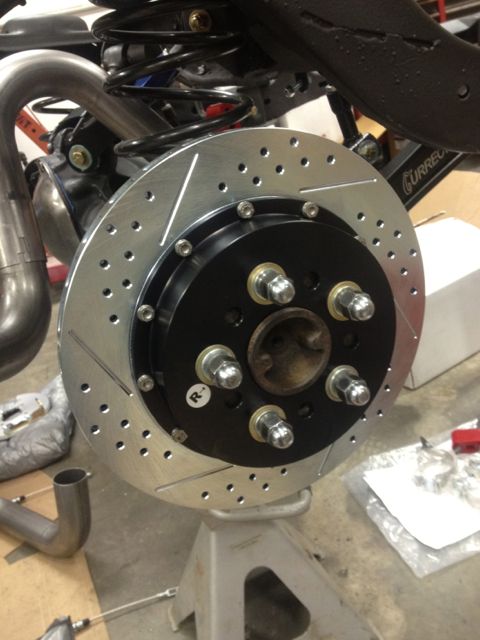

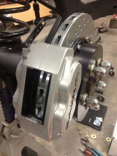

Default rear brakes
here are a few photos of the rear brake install...
thanks for your interest!
danny

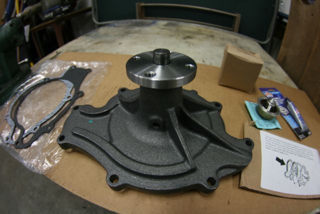

Default waterpump
this is flowkooler high flow waterpump #1622

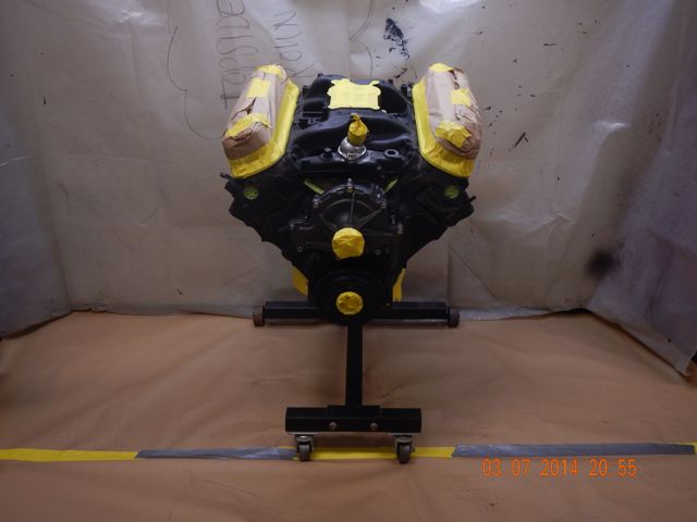

Default engine paint
pontiac blue
