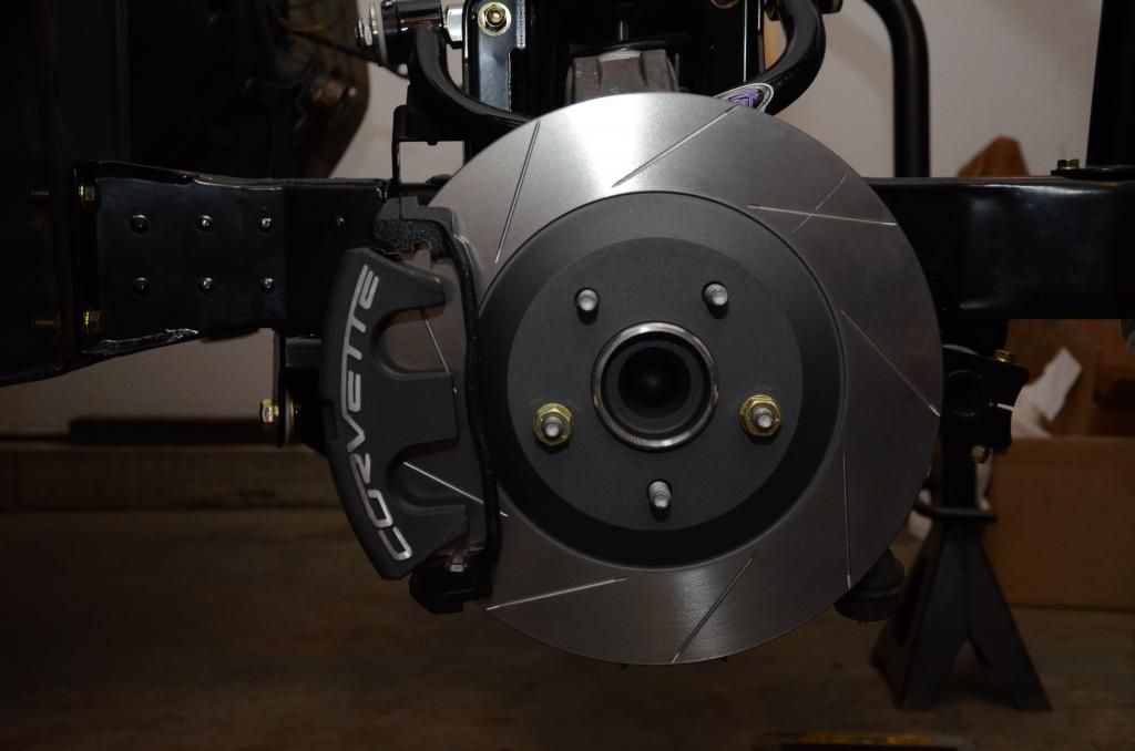

Kore3 presents came today! Let me tell you Tobin is the BEST around. Everything was packaged nice, he has a wealth of knowledge to share and won't steer anyone in the wrong direction.
Mocked up the 325mm DBA slotted front rotors and c6 calipers.
Check out the machine work on these backing plates. I went to school for CNC and ran CNC for a number of years and still love to see the manufacturing process.

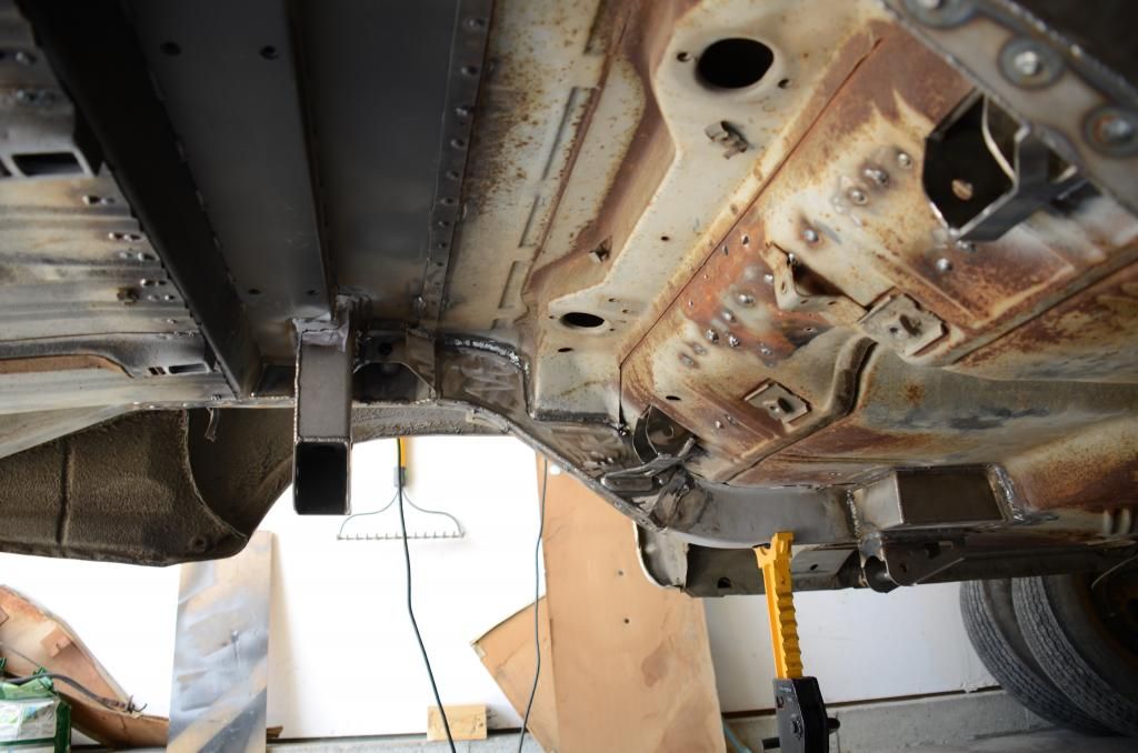

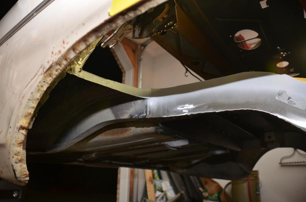

Thanks to my brother helping the last few days, we made some pretty good progress.
Dp90 on axle housing and in misc parts that won't be accessible once installed.
Torque boxes and lower brackets installed.

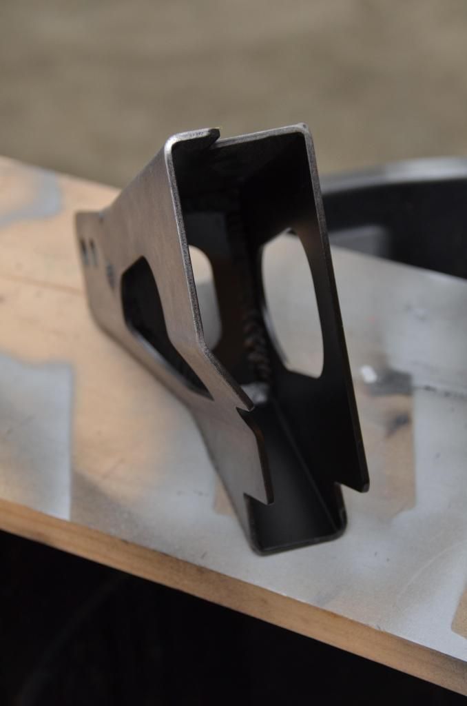

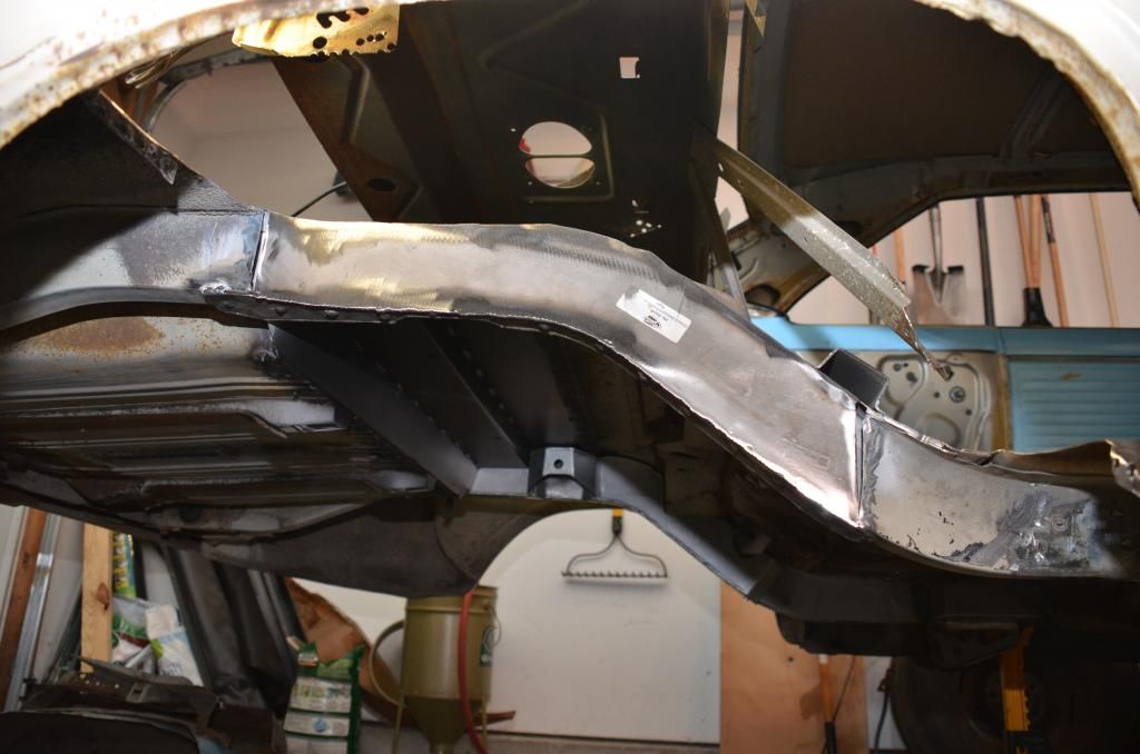

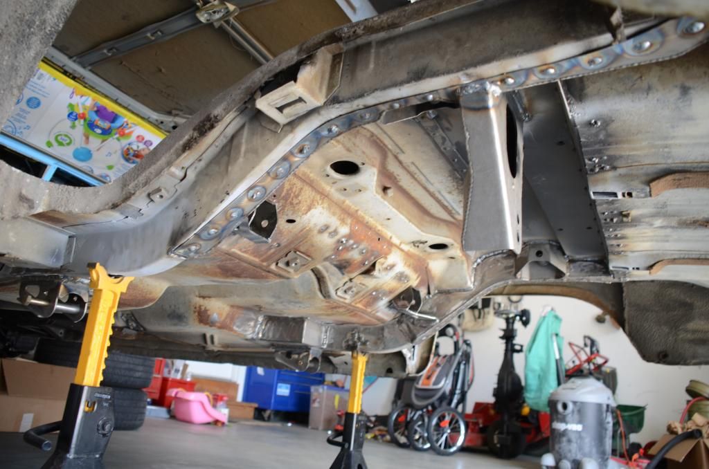

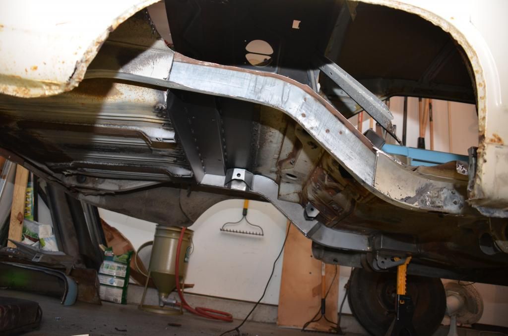

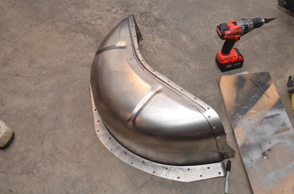

Narrowed the passenger frame rail for mini tubs
Flange fabbed and welded in front and rear
Ready to plug weld
Inner rail plug welded and tacked into place
Tub installed

You and me both! I need some reassurance that I installed the 4 link right,
Driver side rail is narrowed and welded, also drivers mini tub is tacked in, just need to finish about 40 spot welds, and grind for a few days. Then it's ready to get off those jack stands for a while!
