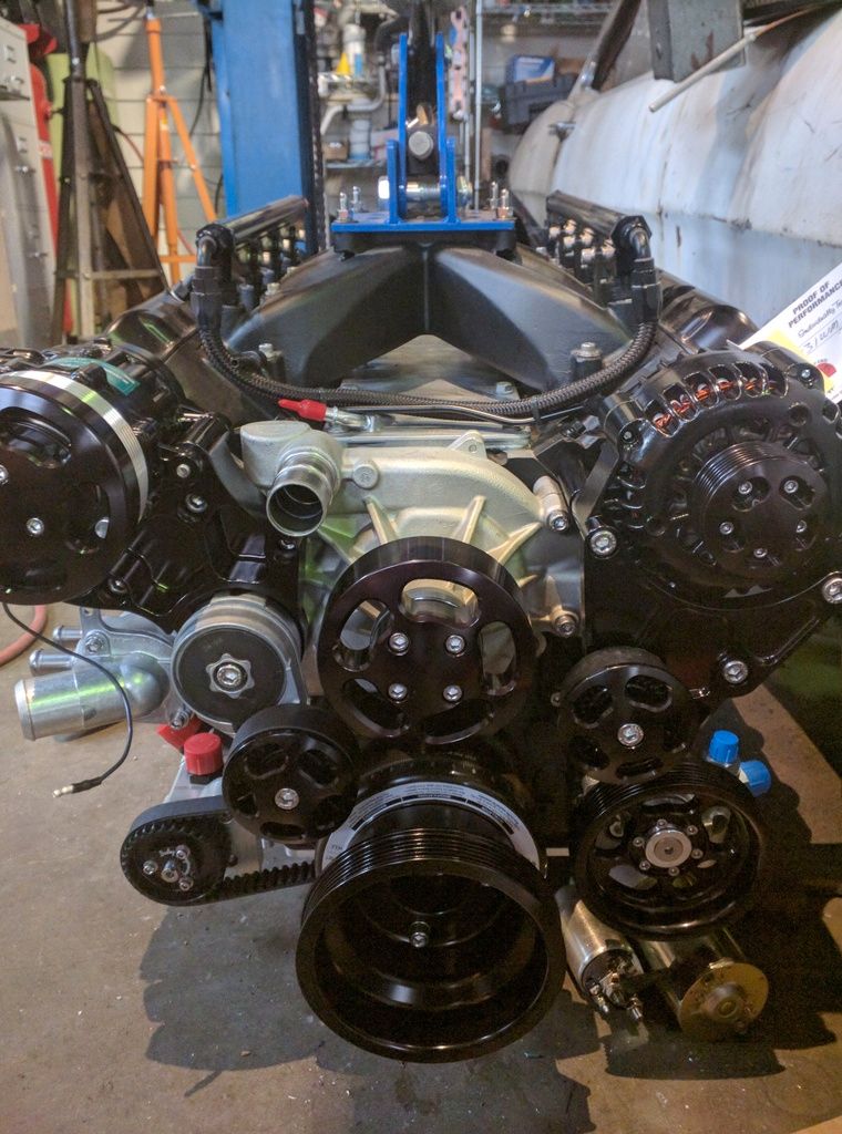

Wegner setup and Dailey pan/pump installed.

When I got the dry-sump pump mounted and attempted to install the motor, the pump ended up wanting to occupy the same space as the motor mount. I knew interference was inevitable...
I've been wanting to push the motor back for a while now. This situation finally gave me the excuse to do it.
The motor got pushed back about 12.5" from the existing motor mounts.
The new motor location is setup to give me just enough room to install/remove the dry-sump pump belt.
