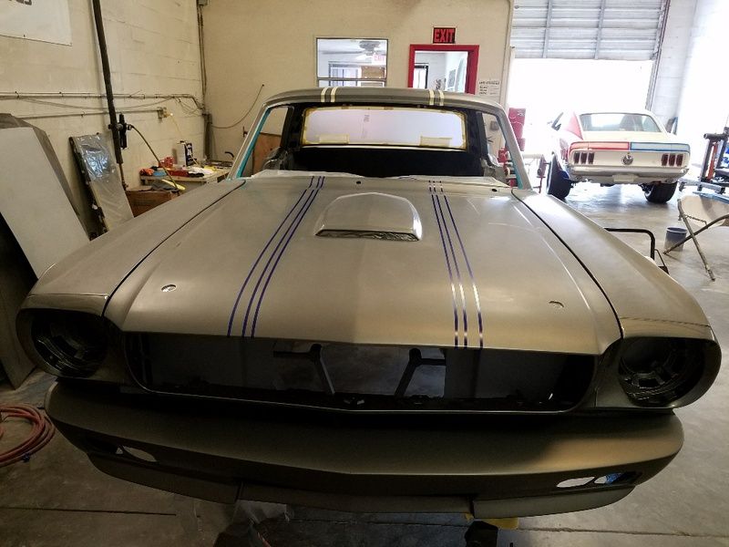

02-11-2017, 10:48 AM
GPR
Join Date: Jan 2010
Location: Port Richey Fl
Posts: 660
Thanked 12 Times in 11 Posts
Brian covering the engine compartment the other day getting it ready for pepper gray.
Yesterday I sprayed 3 coats of ProSpray pepper gray

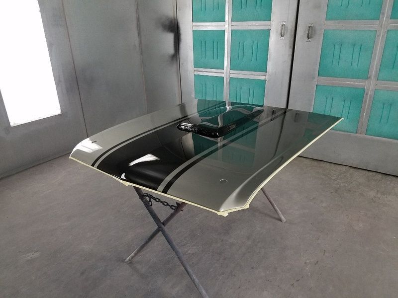

02-11-2017, 01:24 PM
GPR
Join Date: Jan 2010
Posts: 660
Today I sprayed a couple of coats of SPI Universal clear. The next step will be to wet sand and lay out the stripes and spray more clear.

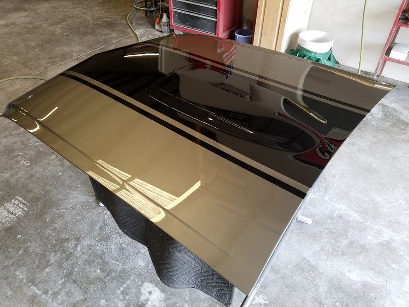

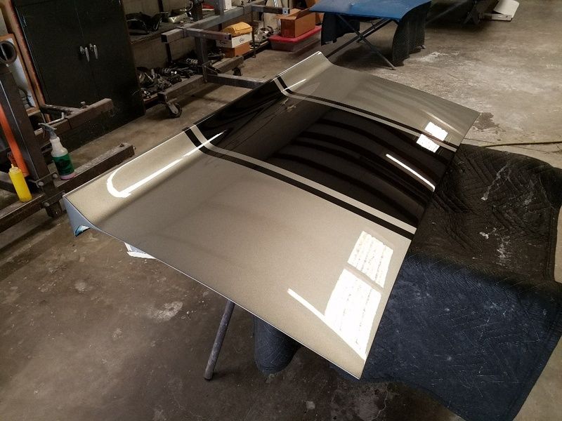

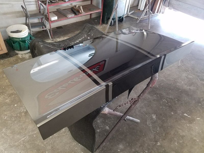

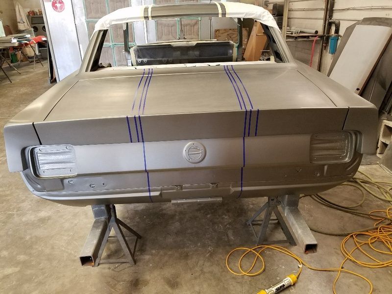

06-12-2017, 12:18 PM
GPR
Join Date: Jan 2010
Posts: 660
Brian started laying out the stripes on the body
Five coats of clear wet sanded and buffed
