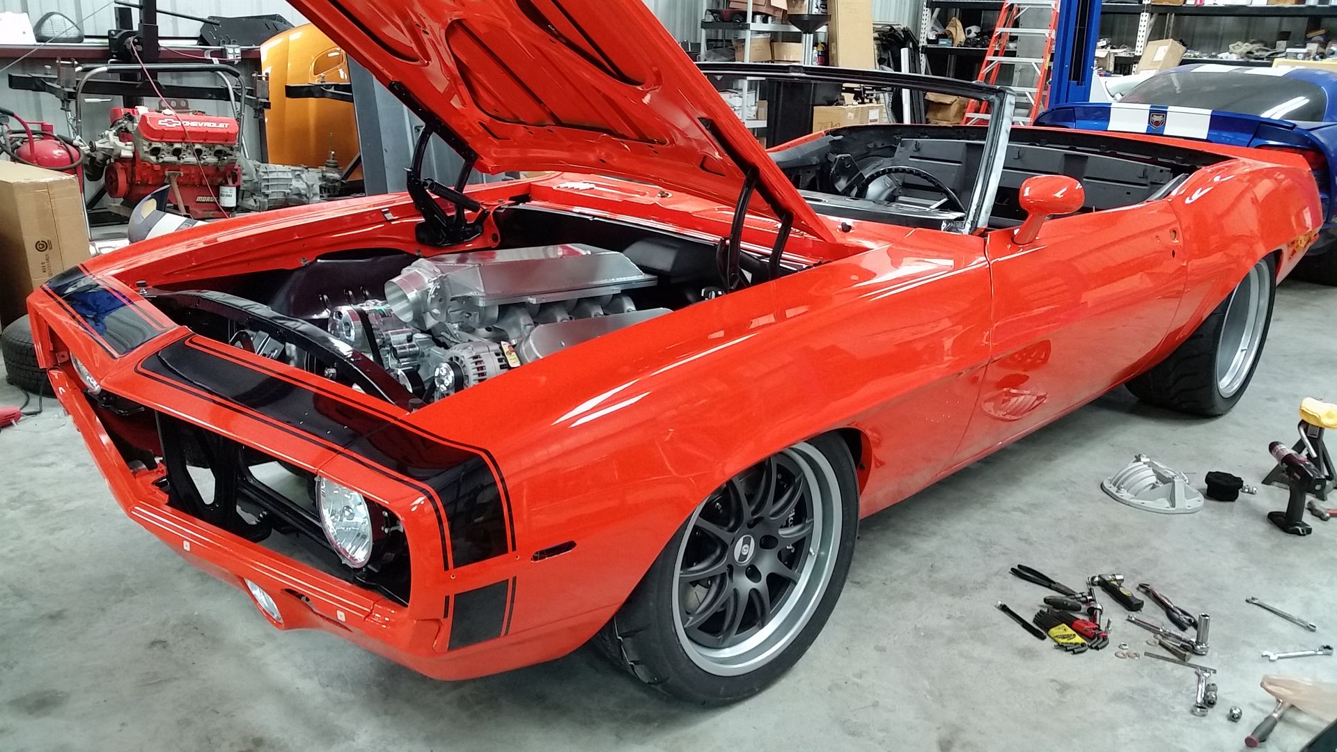

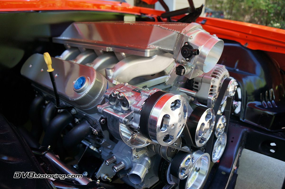

Its only been a few days since my last update, but it has been a busy few days!
-Installed Ram Clutch (part 98931HD, single disk ceramic/bronze disk material)
-Installed engine into engine bay
-3M Scotchbrite brushed the intake manifold and valve covers, sprayed them with Dupli-color clear engine paint to seal them.
-Intake manifold was too tall at the throttle body mounting flange, so I had to cut it down and reshape the flange to clear the hood. I removed about half an inch from the flange, and flipped the throttle body upside down. It should actually work better this way, since my throttle cable comes from the driver side anyways.

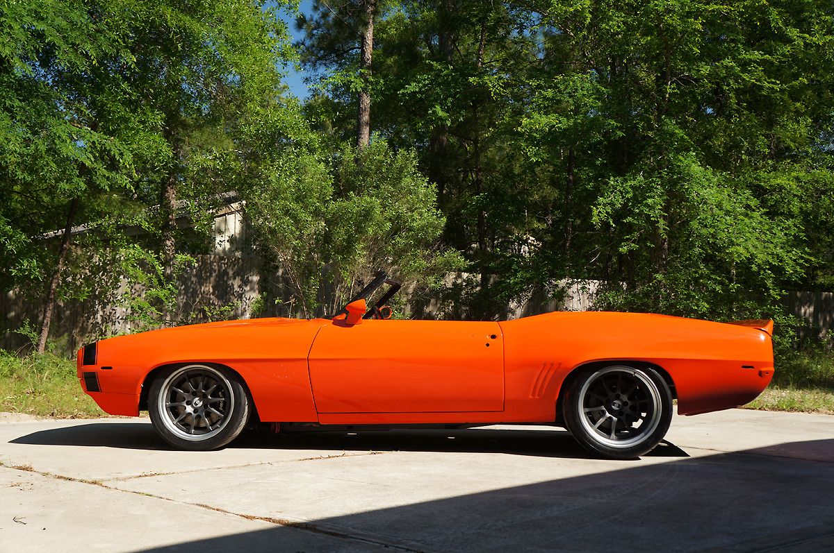

Forgeline GZ3 wheels are one of my favorites. I also had a set on my '14 Viper TA, and love them. I did things a little different than most, went with a Hyper Silver powdercoated lip. I do not plan on having any chrome on this car, but wanted the appearance of silver color instead. All emblems and rear bumper will be done in a similar Hyper Silver color. Centers are Matte Graphite. I designed the centercap logo, and had Forgeline cut them for me.
Forgeline GZ3
18x8.0 front with 245/40-18 Toyo R888 tire
19x12.0 rear with 345/30-19 Toyo R888 tire (wheel has 6.0" lip depth)
Matte Graphite Center
Hyper Silver Lip and Inner
I put the wheels on the car, and pushed it outside for some photos. It was finally great to see the car on the ground again, with nice wheels. It has been over 2 years since it had decent wheels on it.
