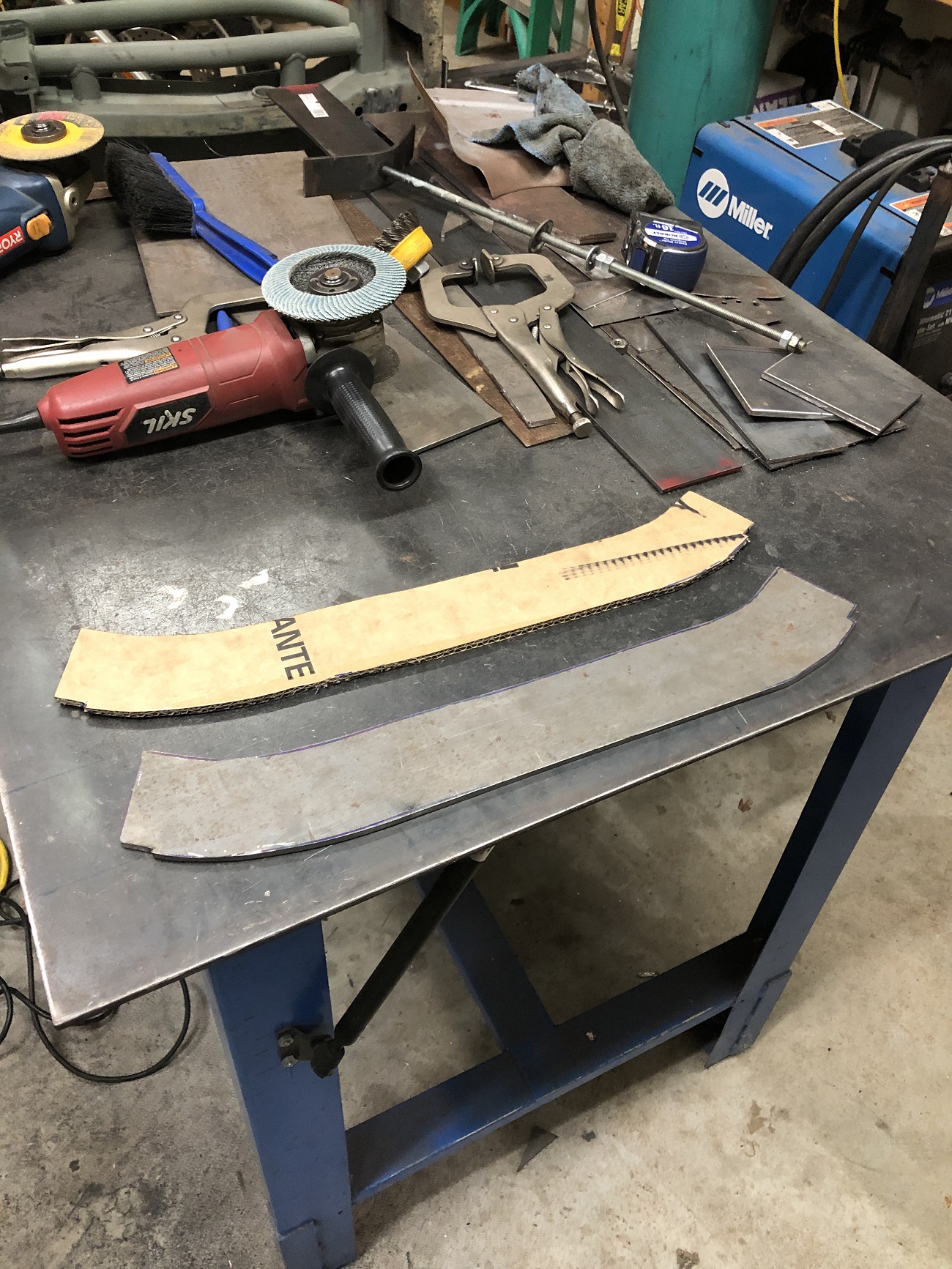

Default Front Subframe - Part 1
I did this work back in November of 2019 but have not posted it here yet. I had taken my complete, rolling front subframe out of storage to begin prepping it for paint. In the process I discovered some significant rust on the engine cradle/crossmember that required repair.
This was a little more difficult that it appears in the pictures because I had to perform this work in sections in order to keep the suspension geometry as close to original as possible. This repair involved the structure that supports the lower control arm mounting pockets. For most of this work, I left the OEM control arms installed to help with stability. I used three, 3/16" steel ribs, shaped to the existing cradle. Two of them were welded directly to the control arm pockets. The steel I used to cover the bottom of the cradle was also 3/16" thick. As I said, I did it in sections to help keep the structure dimensionally stable. This also allowed me to use T-fillet welds between the cover pieces and the ribs, allowing full weld coverage of the joints. The center rib was welded in place first to allow two additional brace plates that would connect internally to the front rib.
