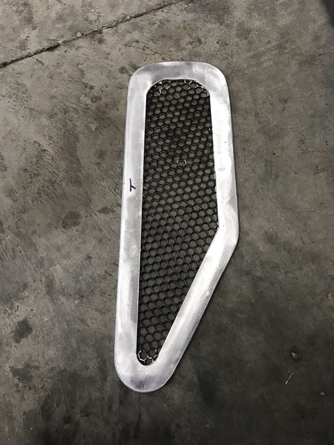

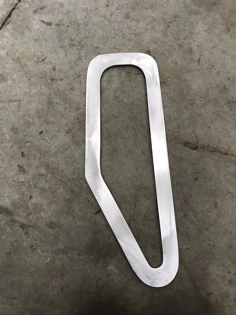

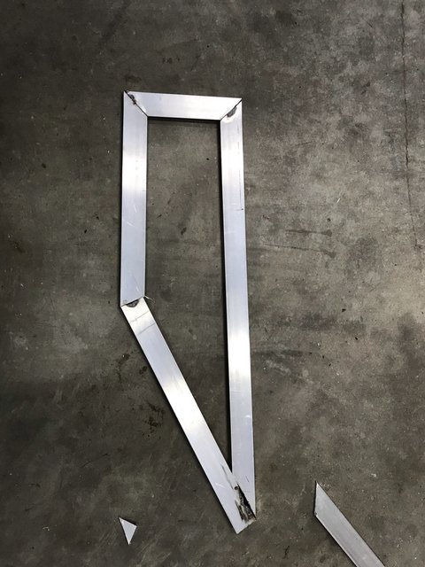

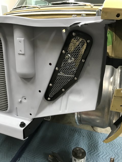

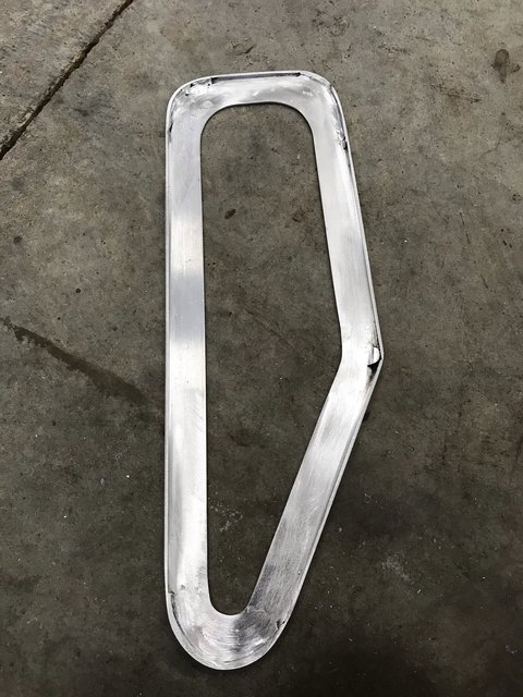

Thanks Brian, I am working on a plan to route CAI to the left side. The hole I cut in the core support is going to provide a air intake. I am building a screen to cover the opening. I started with some aluminum angle 3/4 x 3/4 that iI ripped one side down to create a recess for the screen. I cut and welded the pieces together added the screen then capped it with 3/4” wide flat stock. Here are a few pictures that might make more sense.

Looks great! That should work nicely!

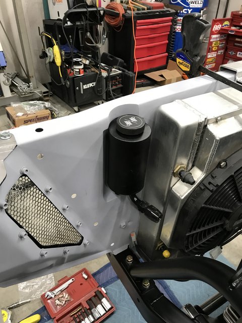

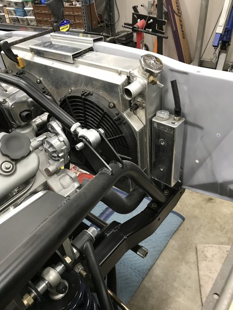

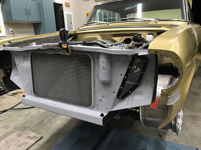

Been pulled away for a bit and haven’t had much time, I have the core support in primer and mocked up the overflow tank, PS tank, air intake screen and the lower radiator mounts. Still have the upper mount to complete.

I really like the air intake screen. That looks great. Good job!

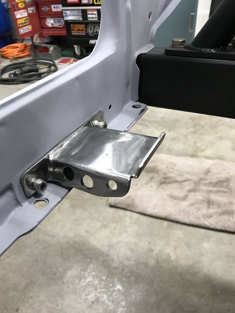

Built a aluminum hold down for the radiator. Trying out some dimple dies.
Bracket for the accelerator pedal.

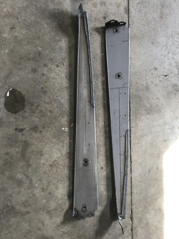

Then on to the fender supports.
