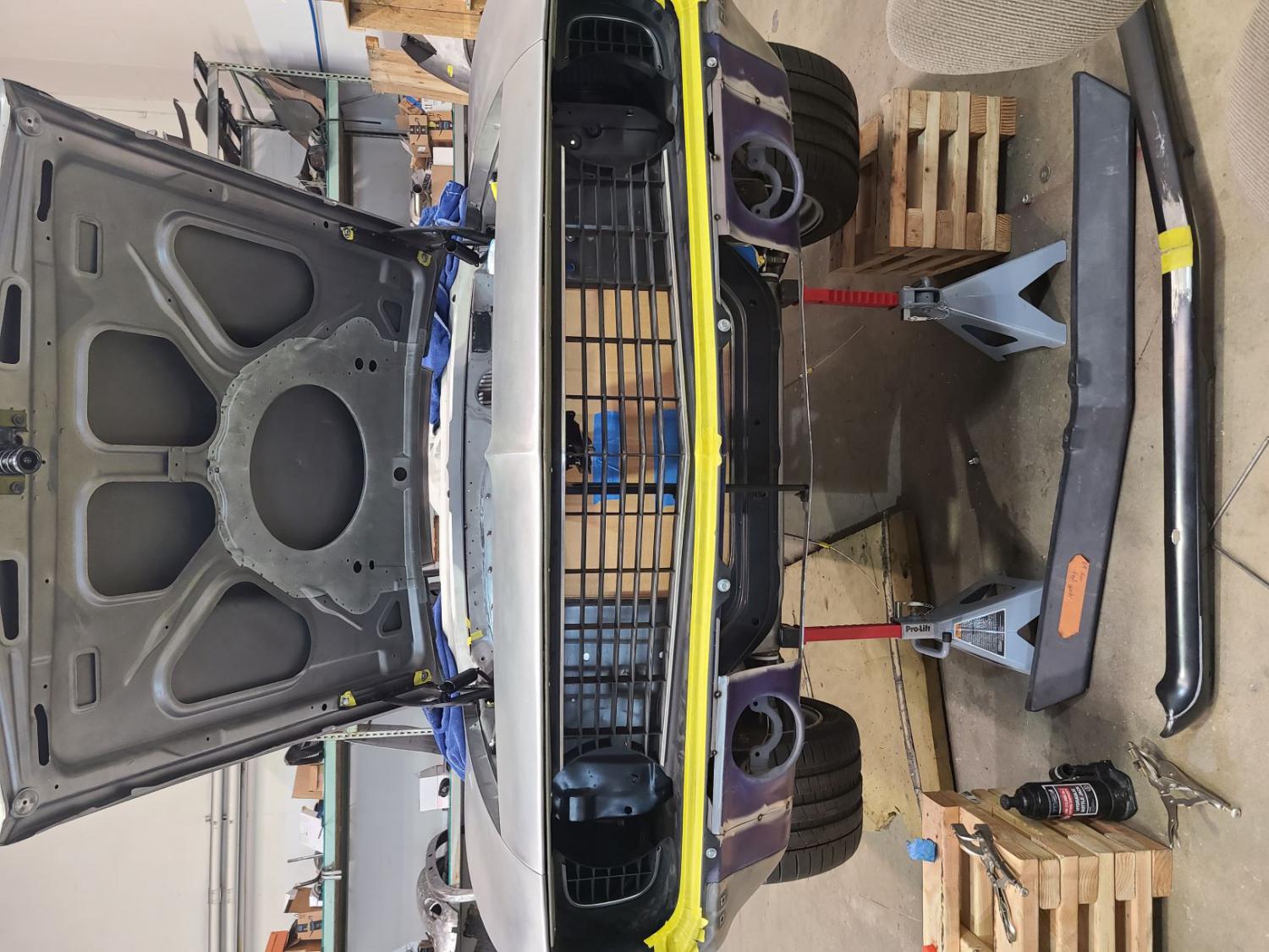

Front Valance:
We had ordered an aftermarket carbon fiber front valance but wasn't up to the fit and finish we were expecting so Kennedy fabed it out of the original and mounted the engine oil cooler from a C6 Z06

Impressive work going on the front valance, nice pathway for cooling the brakes.
Are you going to incorporate the signal lights in the headlights or do you have something else planned? In for more updates.
