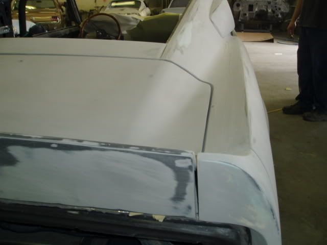

I inspected the car today. They are not as far along as I would like them to be, but the work looks very good. There is still so much that needs to be done!!!!
Trunk fitment:
