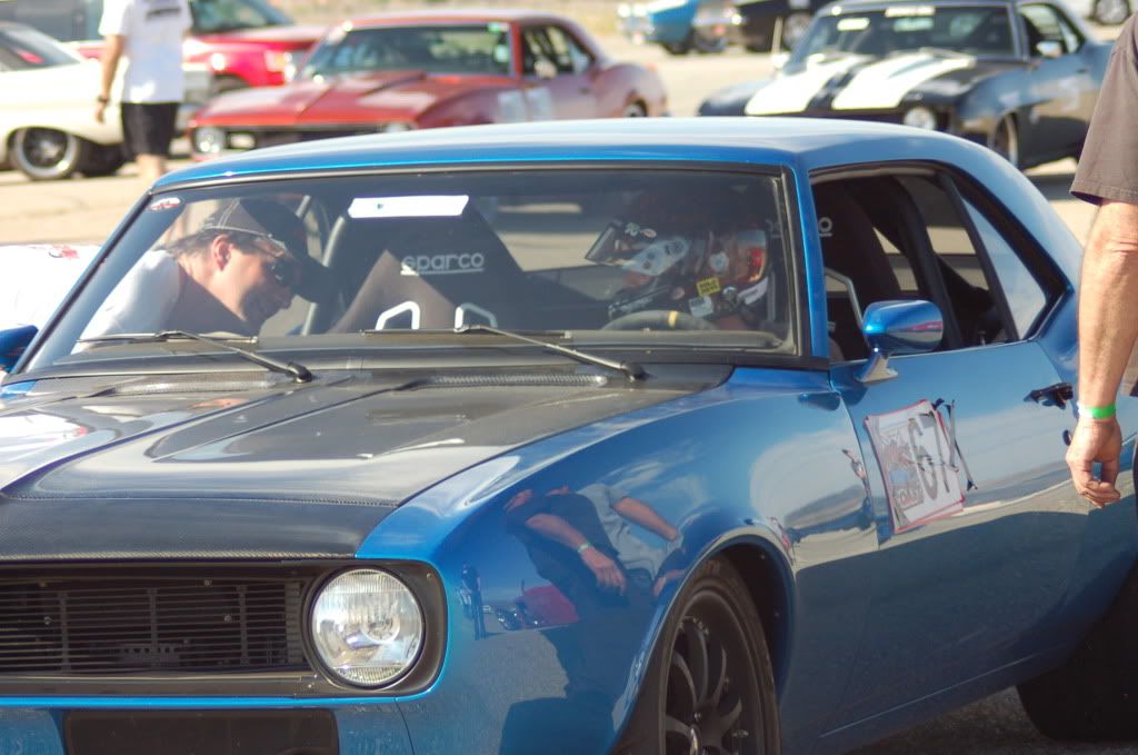

Here are some action shots of BB @ RTTC!
Had some of the best drivers in the hot seat!
Mary Pozzi!
Brian Hobaugh & Guy Ankeny!
Mike Maiers!

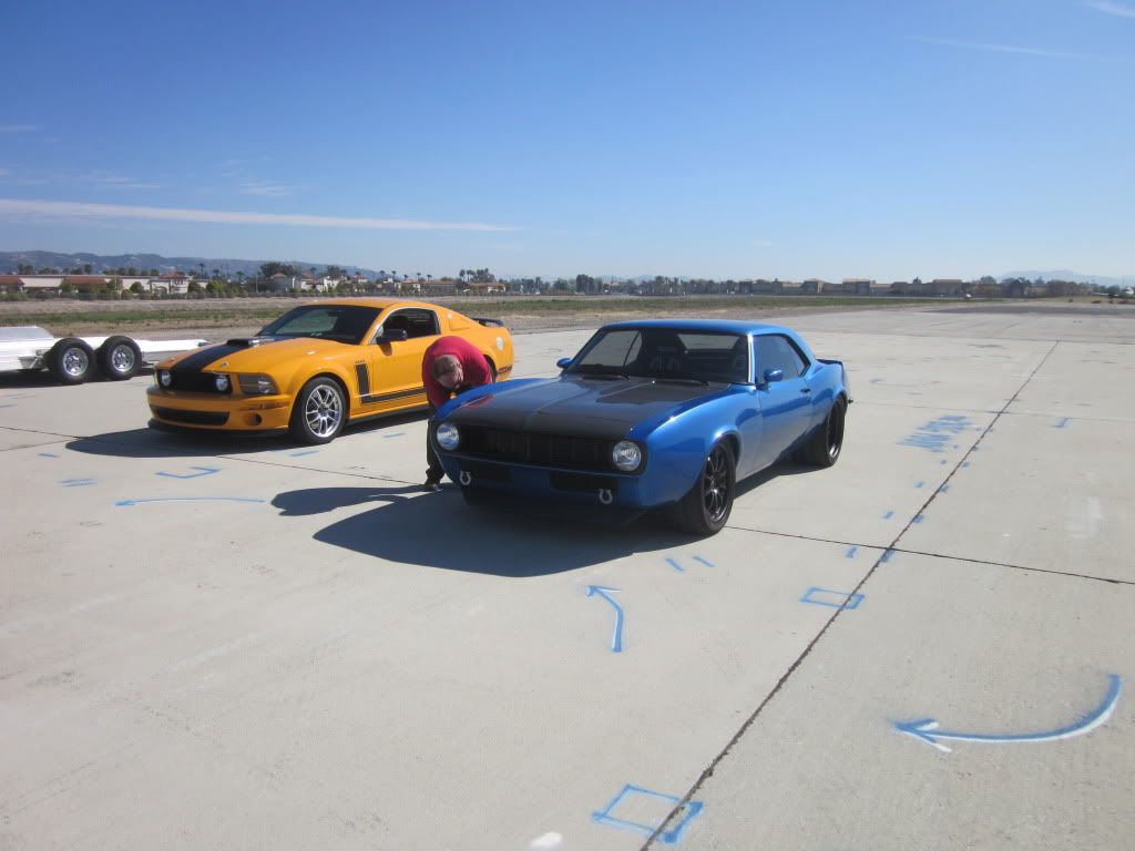

Testing & tuning @ the Camarillo Airport today...
BB's new shock re-tune & spring rates have made the car much better.. I even layed down a decent Auto-X time in it today.. We got the car back to its orginal ride height.. Looking @ maybe 1 inch lower on all four corners.. We got plenty of suspension travel..
The Mustang was tested today for a guide to see where we could make improvements.. This car is awesome as it is.. But new shocks, tires & wheels, custom sway bars & lowering it is on the list for changes..

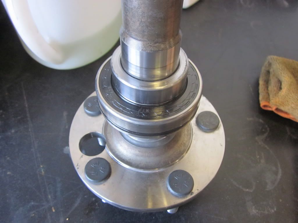

The one thing I knew we were having is piston knock back on the rear.. Auto-X is where I have experienced it the most.. plus also blew another set of ring & pinion on the car… Here are some pics of what is happening You can see where the axle stop is grinding into the seal plus has a ring that is creating a surface that I am not liking.. The rear end is out of the car! Floating rear is going into the car!

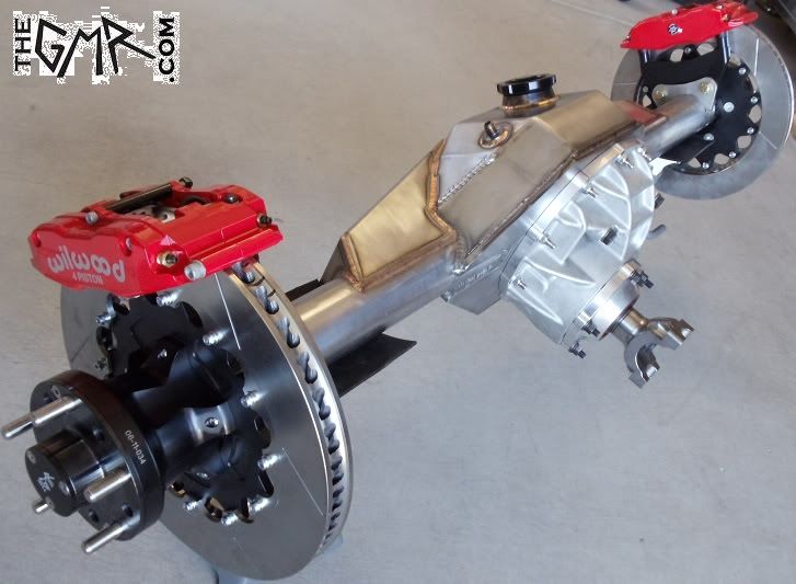

I meet with Jason & Jay from the THE GMR today! They brought in some parts for me to take a look at & see if this is the route I wanted to go to on BB.. The quality of their parts are top notch! Jason is picking up the rear end tomorrow morning to convert it to their floater system.. Plus got a few more of their parts going on the car.. JCG will be working on some other projects with THE GMR here pretty soon!
