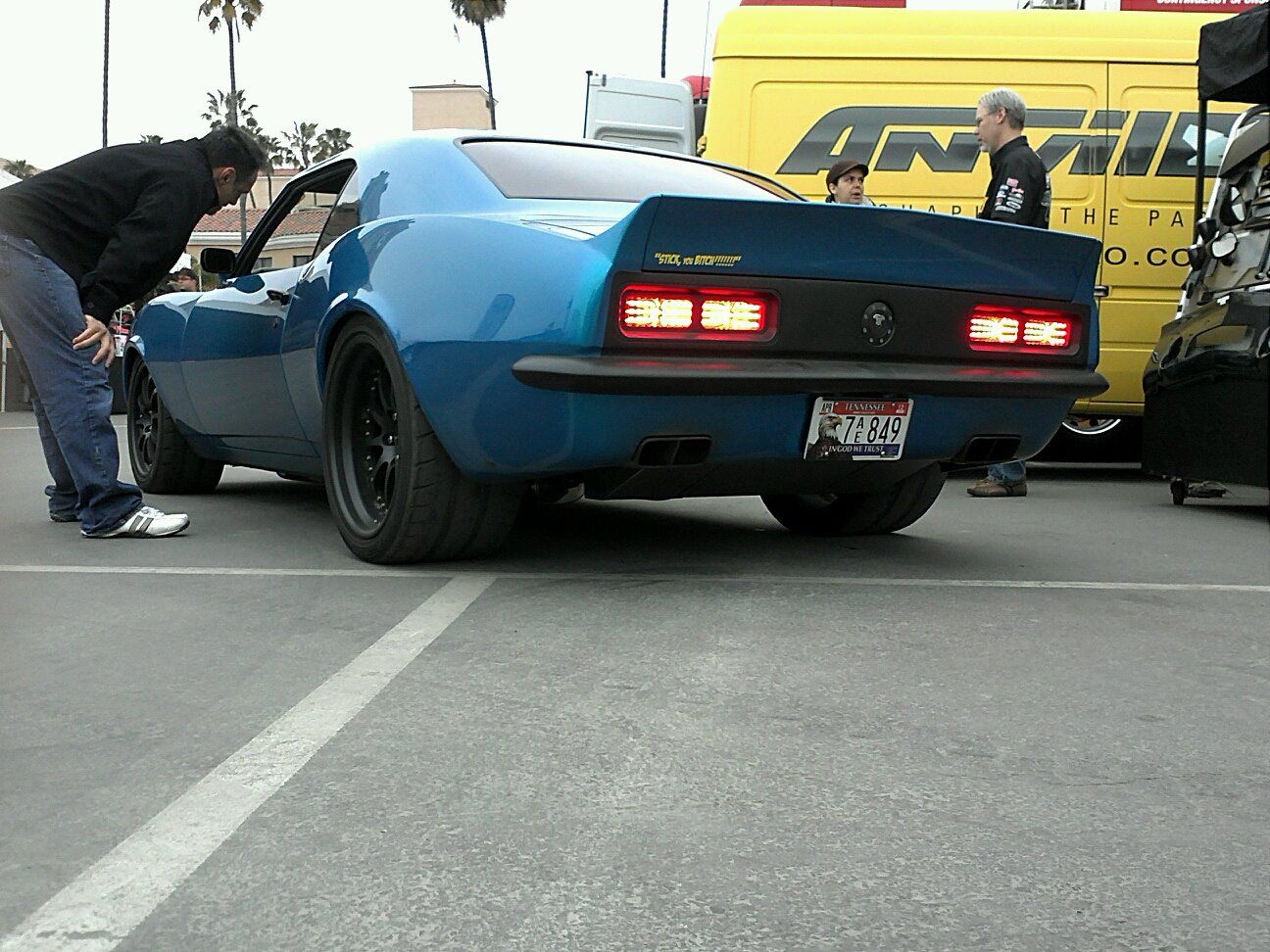

I want to thank Matt from Anvil Auto for giving a spot to park BB while we were @ Delmar this past weekend..

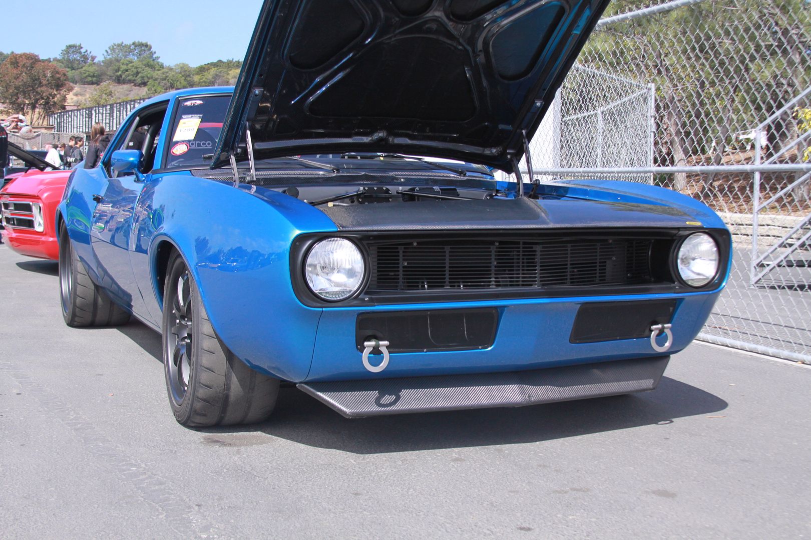

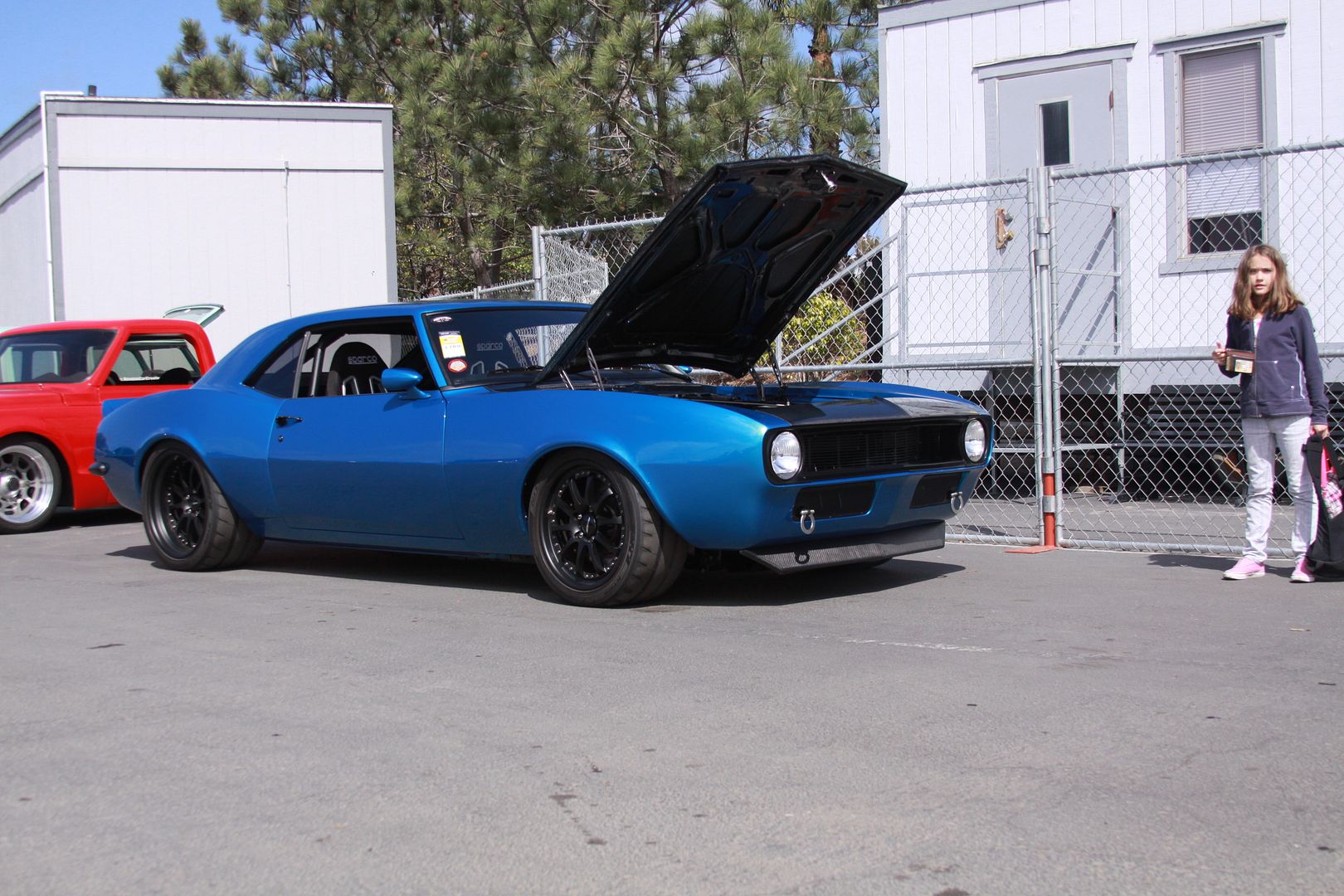

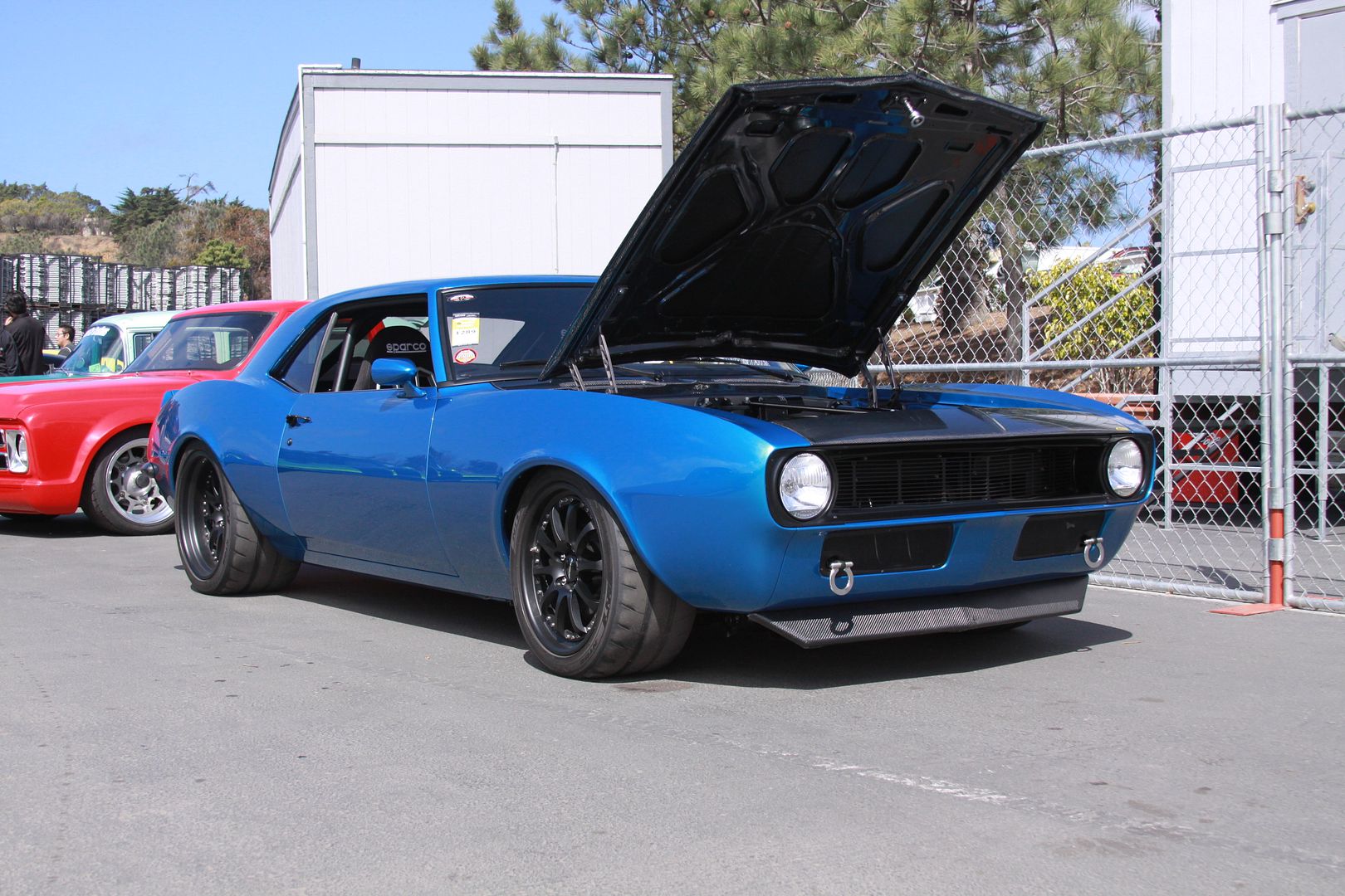

Chris, I must have had a mental block......I don't know why I didn't think to post them for you. Here you go Bro.
Nice pic .. I know the guy who took it...
Great to meet you Chris. Enjoyed the conversations.

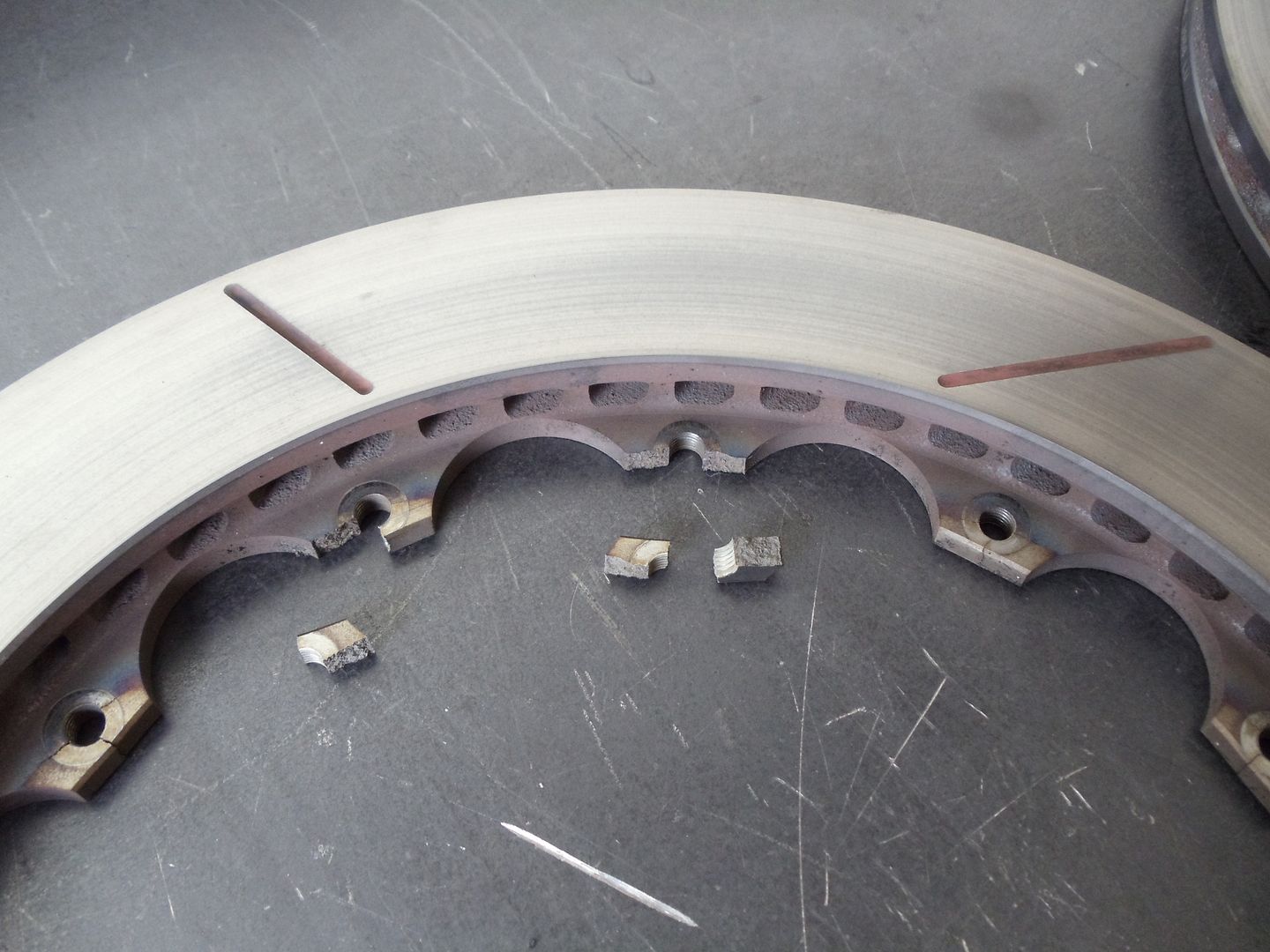

Here is a little step by step on how the conversion is going on BB. We are using just about everything we can minus the axles, ends, and parking brake for now.
Start - Original setup

When we first started running the car the brakes were working great… Then we started running the car hard with all the testing & tuning & knew we were having knock back issues.. so when took the diff apart & found we had more issues going on than we thought.. Jason just sent me some pics o f the rear rotors… With all the clamping force & knock back going on.. we were cracking the mounting tabs on the rotors…
Advise guys! If you plan on running a car as hard as we have been lately.. update to a floater rear or just keep the floating calipers.. I will now incorporate rotor check on my safety list before I take car out & run it hard..
