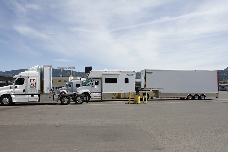

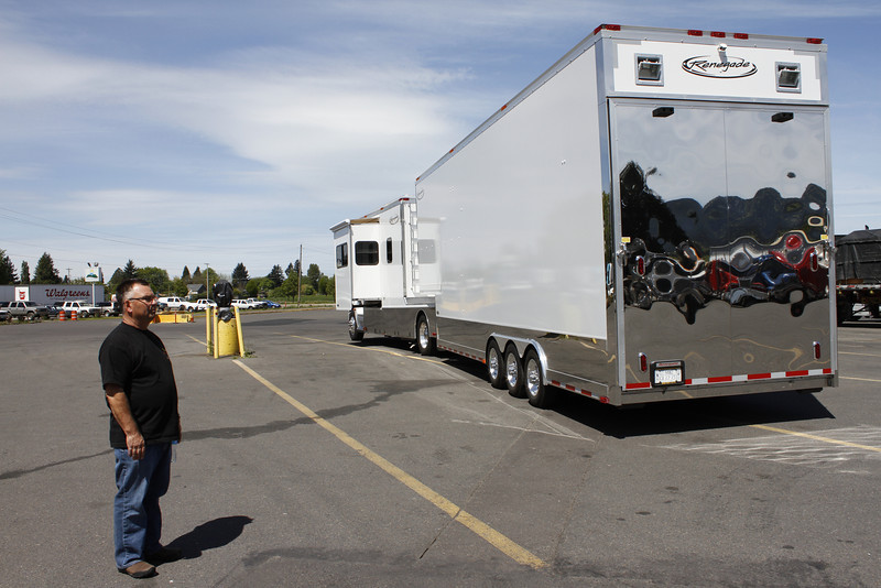

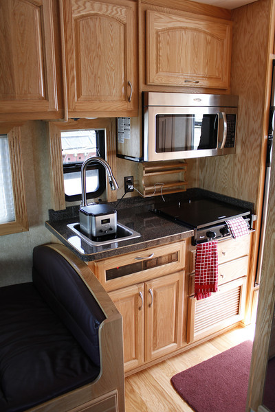

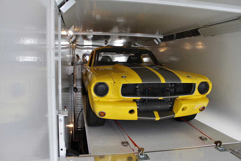

Stop playing!
Renegage motor coach with Garage.
