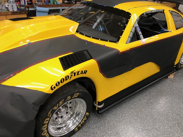

While waiting on the engine parts, etc I am installing a new
seat, moving pedals etc...I am 6'2 1/2" so need to open it up
I am also going to get the car wrapped to try and calm down
the yellow color so playing with paper etc to see what works
This is some progress
Bob
