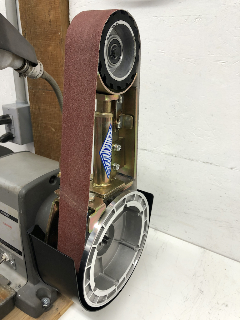

Third is the belt arm swiveled up

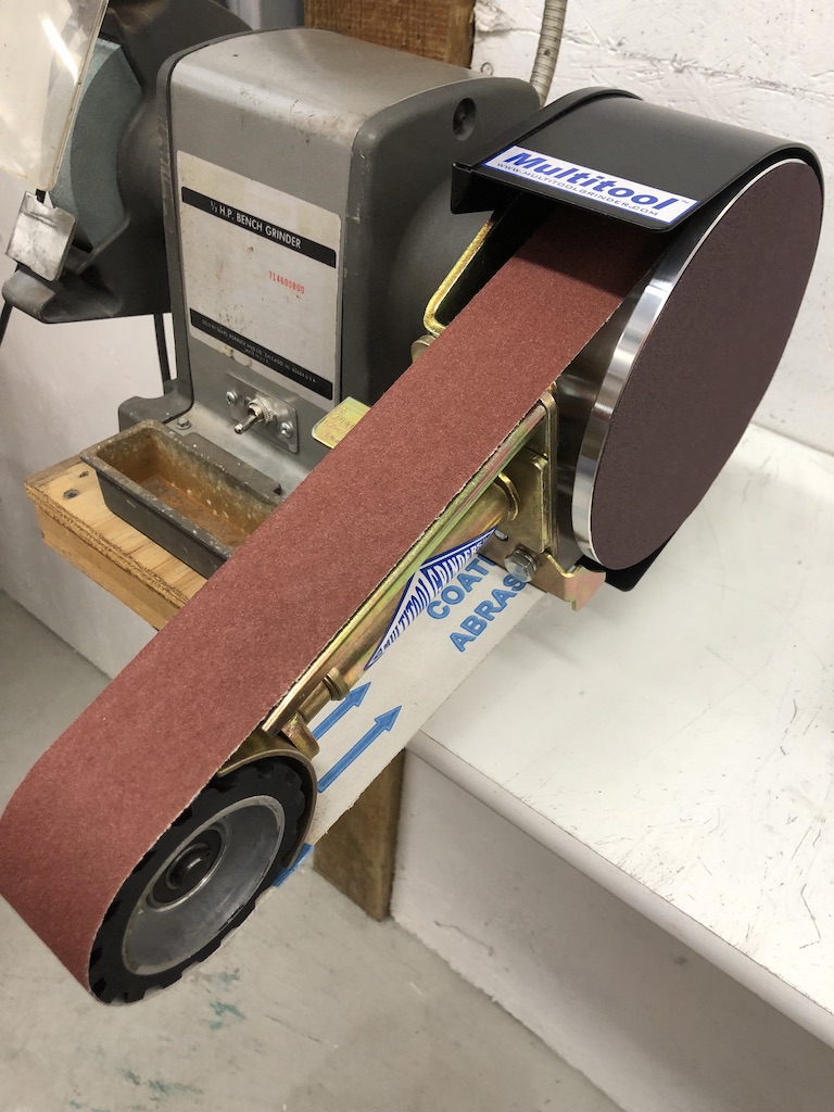

Fourth is the lower belt position

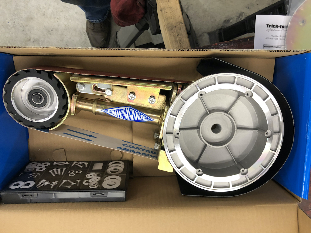

Last is what came in the box minus the disc abrasives and outer plate. It comes with a belt and a disc abrasive.
