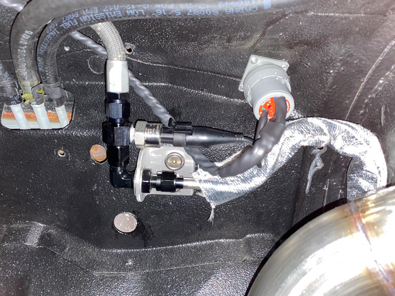

My fuel pressure sensor is in the y block 12” after my dual pumps. My e85 se sir is up by the fuel rail. I didn’t want to restrict fuel so I also have a y block at the firewall from my 1/2” feed. Two -6an going off it to each fuel rail and the drivers side rail I have my e85 sensor in line
