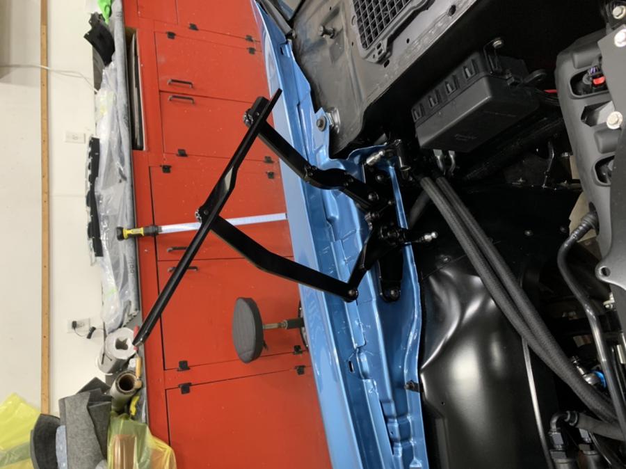

I'm looking for for a relay and socket that clips onto the GMPP Fuse box tabs that the mounts on page 2 of this thread are using.
Does anyone know what the tabs were used for originally?

Stan, just saw this and wanted to post it up for those that might still be looking for them.
https://www.summitracing.com/parts/sum-900485

Nice, I couldn’t find them so I made my own. This is the only pics I have handy....
