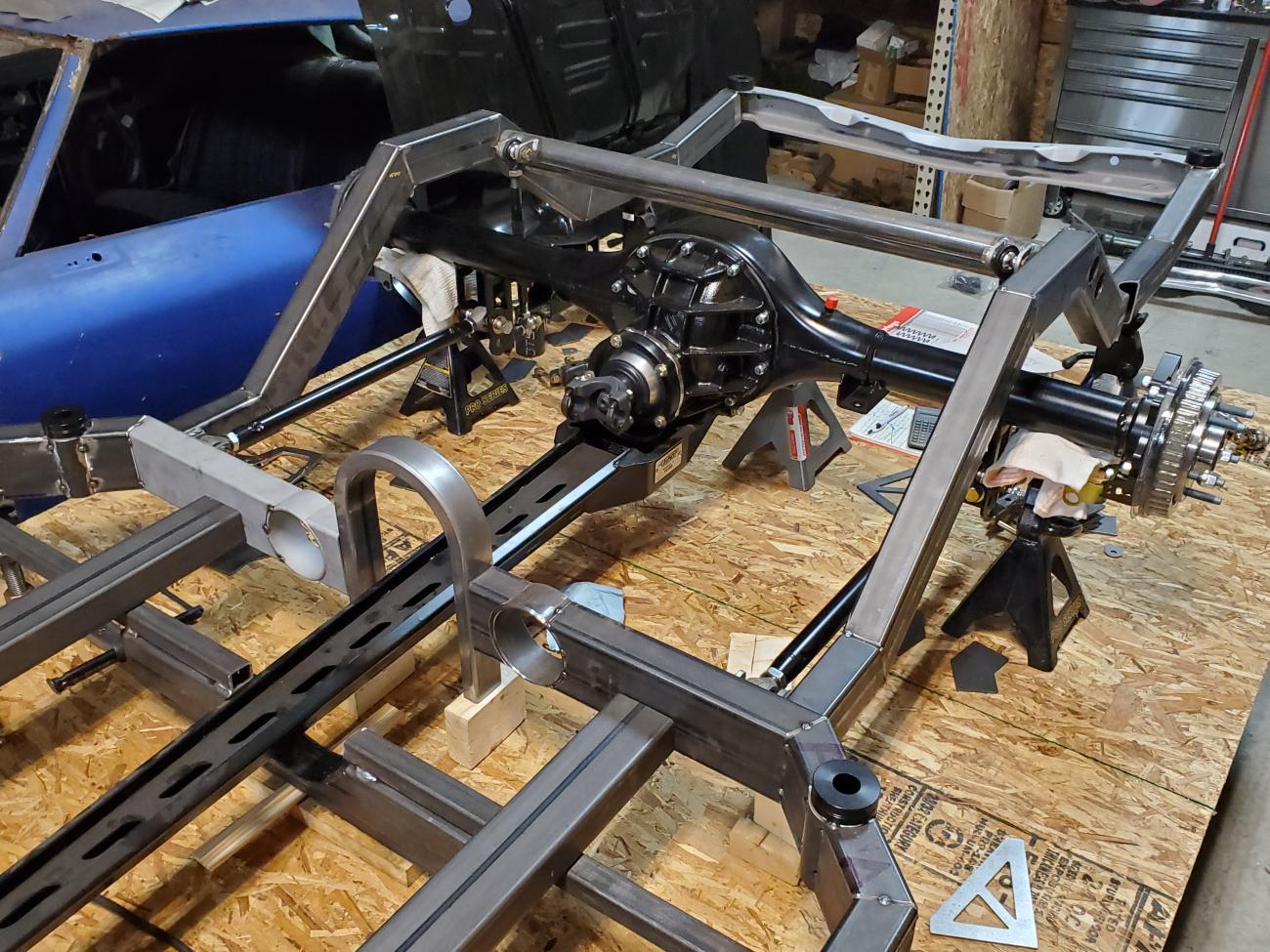

I literally just assembled mine yesterday and went with option 1. I just couldn't see the gear oil sloshing enough to lube the bearings.

I'm using the speedway engineering floater.

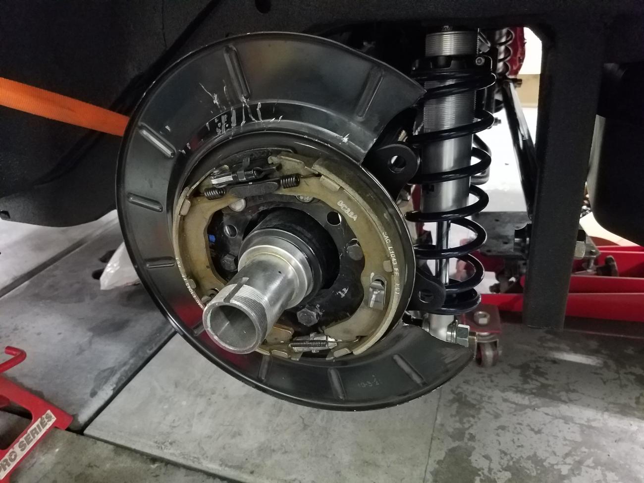

I decided to go with option 3, sealed C7 hub on a SpeedTech full floater built by Dutchman. There's an inner and outer axle seal in each tube to keep fluids from leaving the center.
