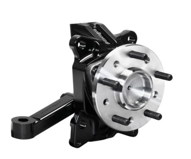

I decided to go with the NoLimit rack and pinion set up for the front and utilize the stock cross member. Maybe later I'll buy a fancy aftermarket one, but for now, this should help. I do need to get springs, and have looked at hotchkis stuff. I'm also looking at the aftermarket wilwood spindle for the C10 but I've read that it's based on Mustang II stuff (true?). So for now, springs, rack and pinon, and likely a bar in the back.

The Wilwood C10 spindle is not a Mustang II design. It does use a bolt on steering arm but the whole setup is truck specific. Keep in mind it is laid out to use a specific brake package, so you cannot reuse any of your existing components.
