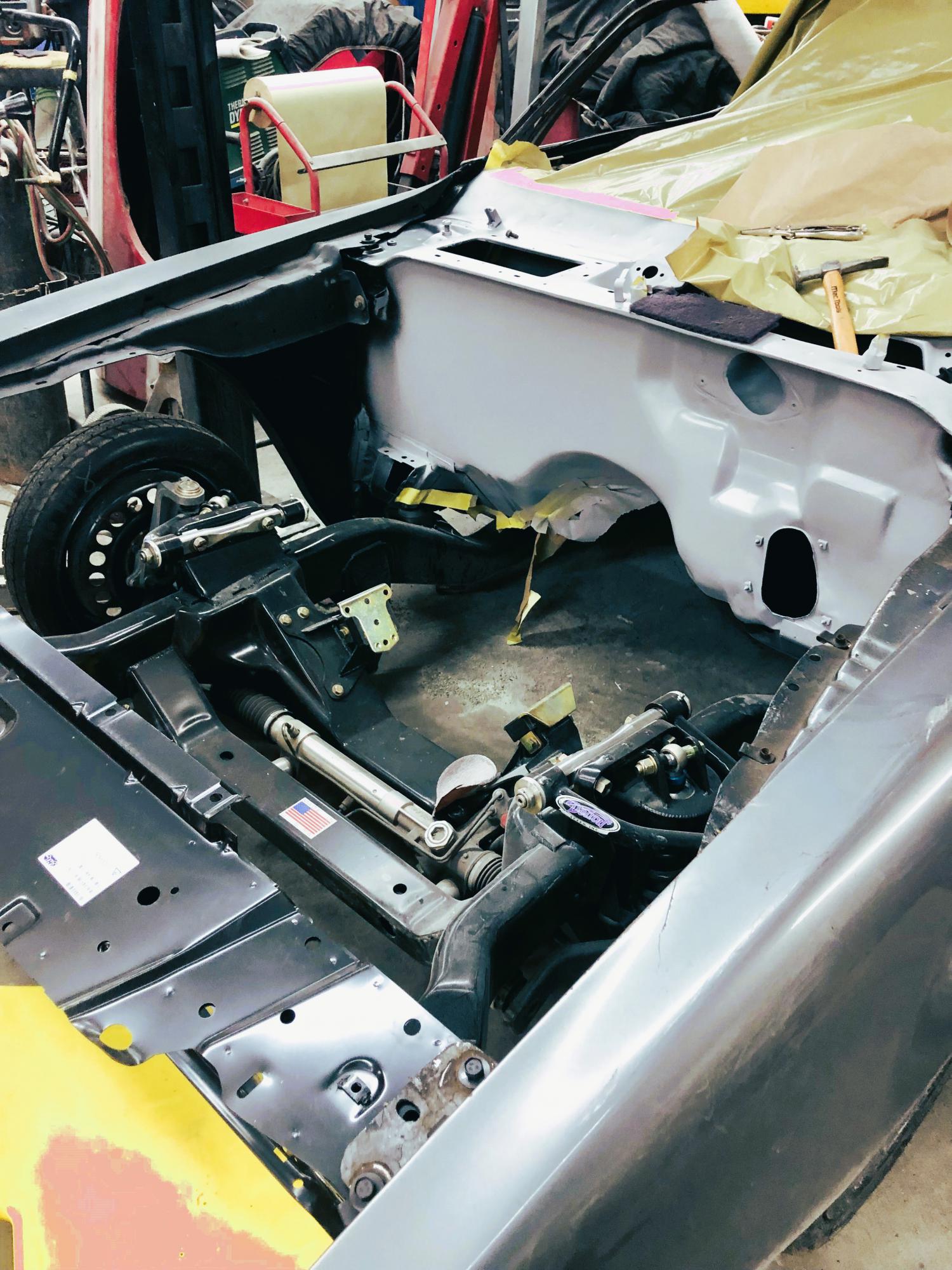

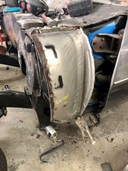

Been a while since I updated this. Stopped over once or twice between this post and the last. Started burning out some old bondo near the driver side door. Wasn't a lot, but enough.
When it was originally hit back in 1981 - looks the body shop salvaged the original door. In the process of their repair, they grinded a bit too thin in a few spots and instead of spot welding, grinding smooth etc., they went straight for the bondo. You can kind of see what I'm talking about in one of those pics where I started grinding it out/burning.
Burning bondo out I can handle, door skin repair is well out of my wheelhouse. Leaving that task to the shop. Overall, there's no rot which isn't a surprise, but that shady door repair was.
Some more bondo near passenger side rear wheel well, some more above driver rear wheel. Passenger rocker panel is solid but slightly bent from a floor jack, need to replace that.
Ordered new hood hinges - wanted to salvage original but too much trouble for what it's worth in time. Ordered all new hardware for sheet metal. Silly me thought bagging and tagging every bolt, nut, washer 7 years ago was worth it.
Check out that door gap. Look better than the day I ripped the thing apart.

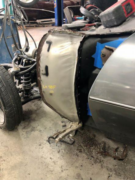

Entry 15: 12/27/2022

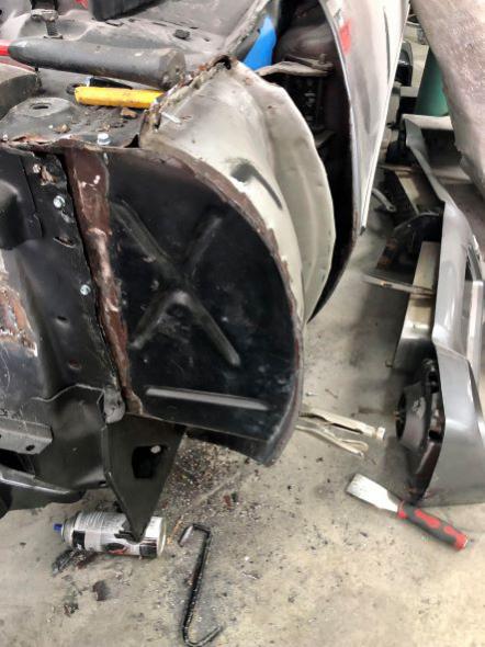

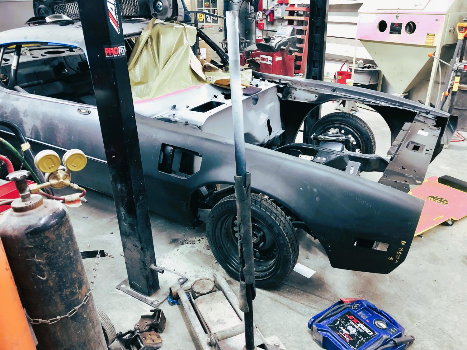

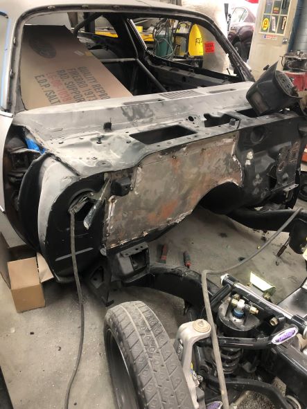

Started stripping to bare metal with a combination of razor blades and the DA. Started off pretty well until I got to the driver's side rear quarter and door.
Unbeknownst to me, when the driver's side door/cowl section/rear quarter was hit back in the 80s...looks like the repair shop salvaged the original sheet metal, fixed the dents and used bondo for repairs.
These are expenses I wasn't planning on. I was well aware there was no rust/rot...but silly me assumed the repairs from yesteryear used NOS/salvaged sheet metal.
Oh well what can you do. Ordered up a new rear quarter panel and located a salvaged door from another 76. I was worried about going too far with the DA and possible warping panels due to heat/my inexperience...so we won't have any full car in bare metal shots...letting the shop handle the rest
These are photos from where I left off last weekend:

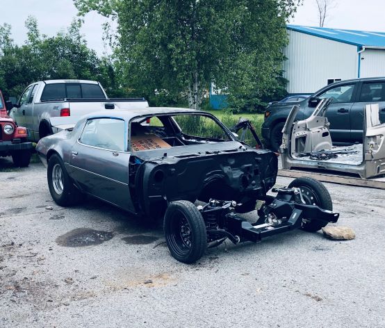

Entry 16: 2/2/2023

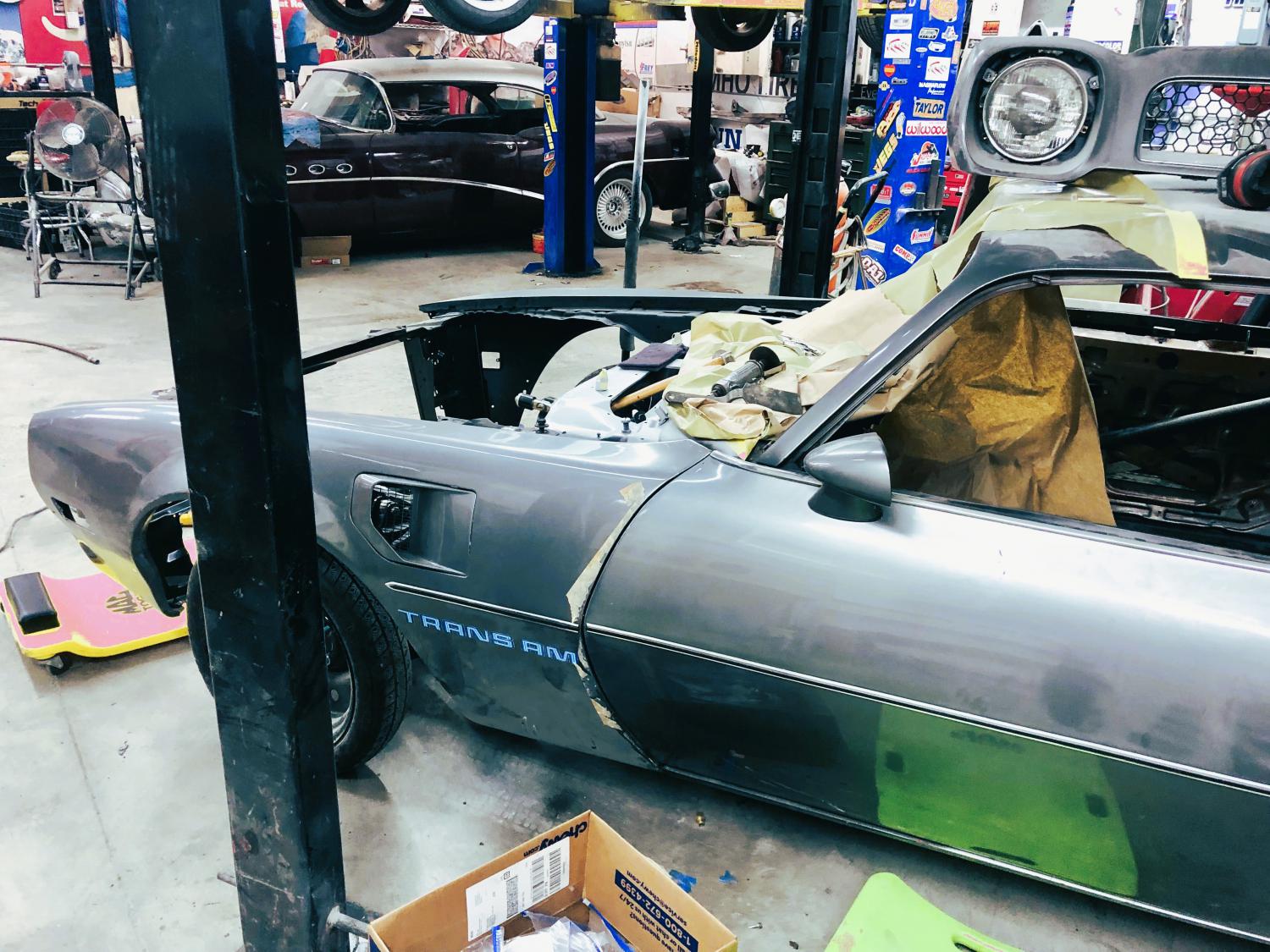

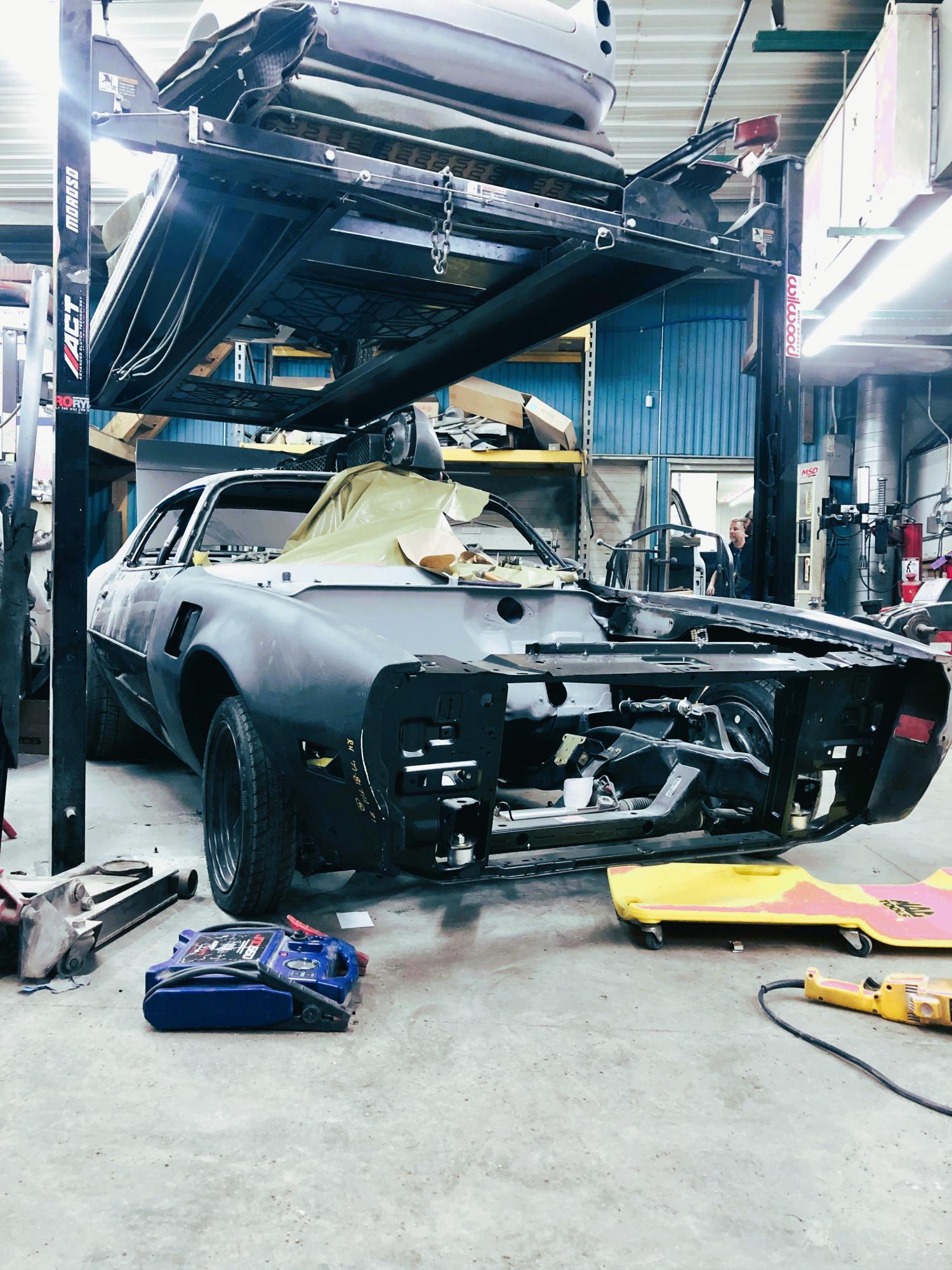

Stopped by the shop the other day; new rear quarter and door roughly in place. Some pictures below of that. I still don't know how to add an image correctly, where/how I can write, add an image and keep writing again. Whenever I add photos they simply appear at the bottom of the post by default. Also, how big should I have the photos? 600 x 600 seems about right...right?

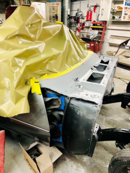

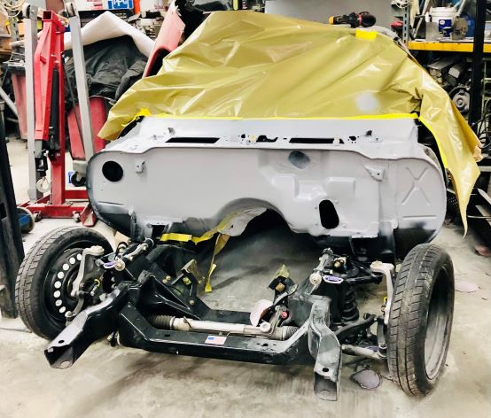

Entry 18: 4/29/2023

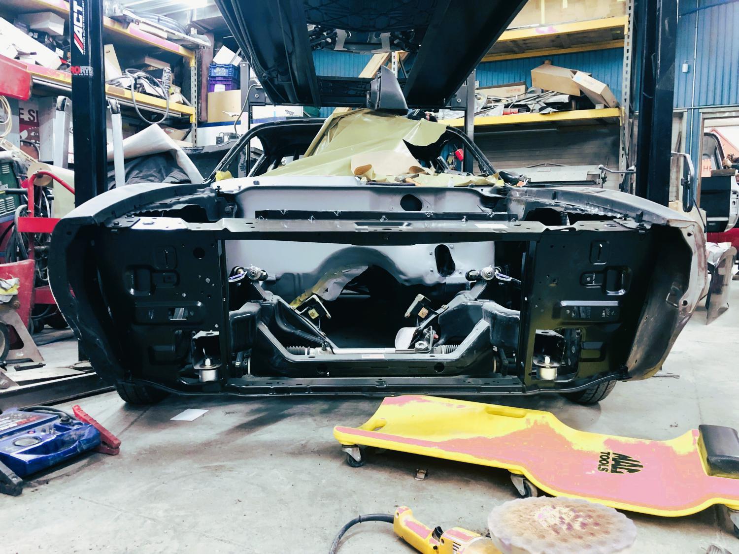

If you've been following along since the beginning, you'll remember that my original plan with this phase was to get the sheet metal back on the car and metal work wrapped up.
That soon became more involved and expensive than I anticipated. While the car was a 32,000 original mile car, 1 owner (my father), never saw snow...it had been in a collision.
Once all the paint was off, I was somewhat surprised when it became pretty obvious that replacing the previously 'saved' driver's side door and quarter was essential if
i wanted it done correctly. While a surprise I wasn't disappointed because this stuff happens when restoring a 48-year-old car. I also had the firewall smoothed and drivers side cowl panel replaced.
Through all of this I was hopeful that when it came time for bodywork to begin (filler, sanding, prepping for sealer, spraying in sealer), that I could afford to get it done all at the same point after metal work was done. This wasn't part of my original plan but getting the car back 'paint ready' was going to be comforting to know that that phase was done.
A big milestone for me. Would just need color down the road.

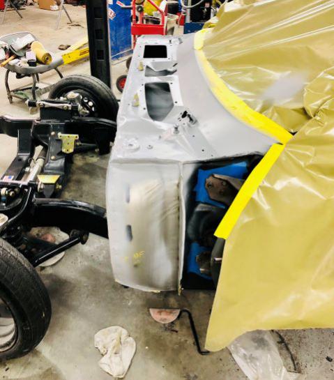

New plan is to get her back with all metal work done and the egregious body work areas completed (B-pillar to roof line for new quarter, and the hood).
I think I'm going to give the remaining body work a shot on my own. My uncle has a private shop a few towns away. I figure I can pick up block sanders, an air file, and supplies for under 1,000. If it's not good enough, I'll just sand it off and try again until it is or until I throw in the towel and decide I'm willing to pay approximately 15,000 for body work. Whatever comes first.
One other area that needed to be address is the package tray area along the bottom of the rear window. This was also a surprise. Car never saw snow and was only a daily driver for 1 year of its life which means this is all from hand washing and a compromised window seal.
Two other photos of the new quarter seams.
