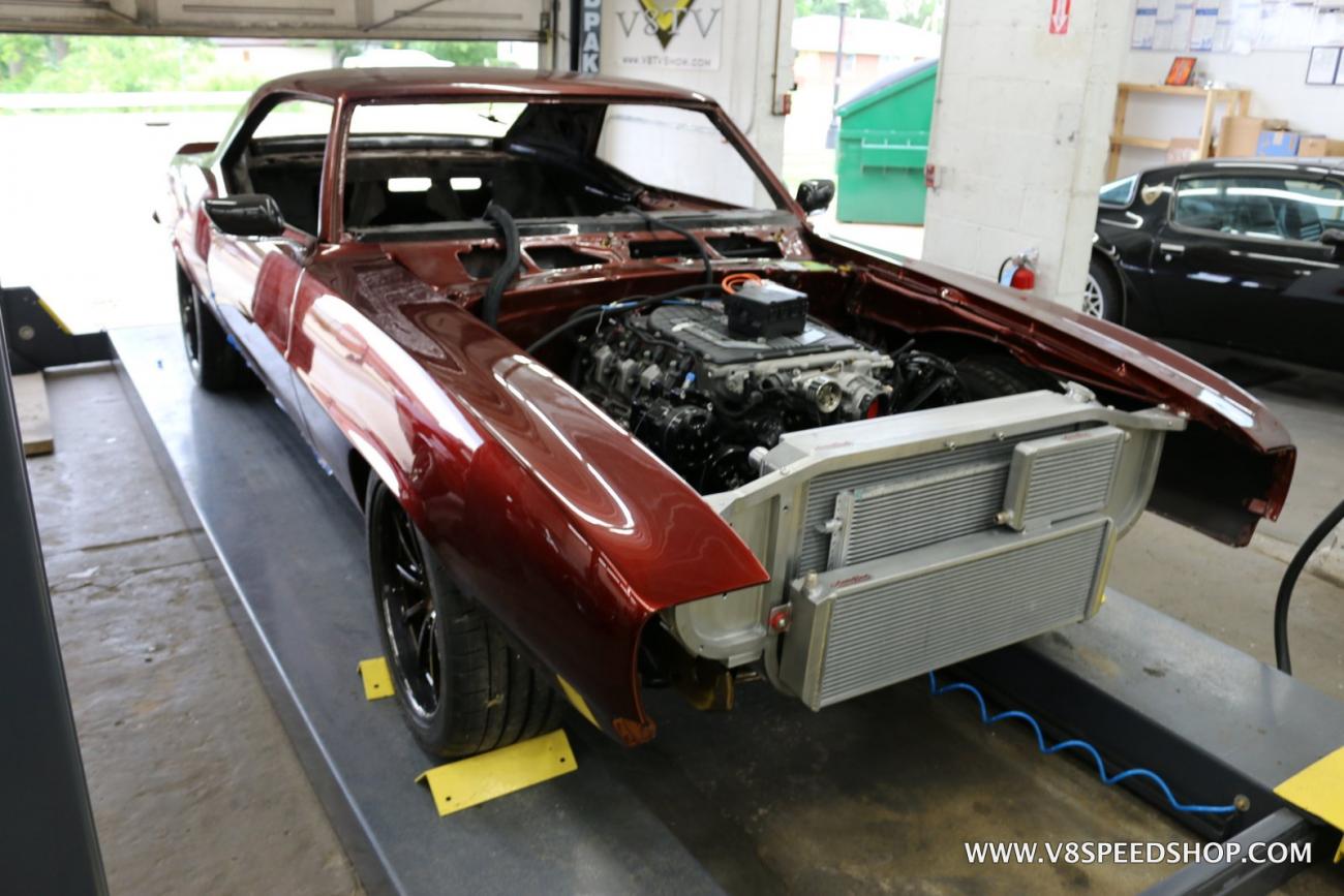

[attach]Name:  1969_Chevrolet_Camaro_DJ_2019-07-25_0016.jpg

Is that whole stack all Autorad? I have their radiator and core support I bought from some one before getting a LSA and I was thinking about getting their heat exchanger. What’s the small one up top? Transmission or Oil?

Man that Autorad setup looks killer. Love the car, nice work!

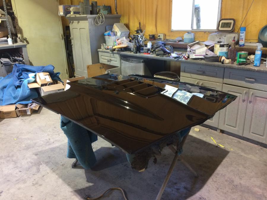

I did this low budget hood for Kevin.
Don
