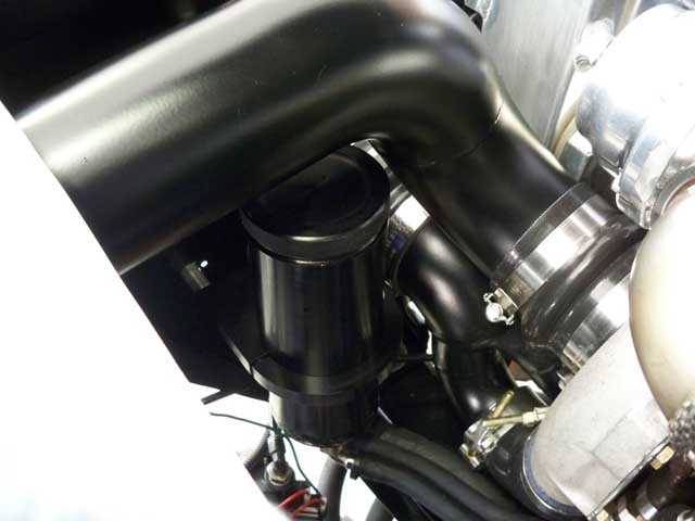

camcojb 05-28-2012 06:41 PM
Originally Posted by PhillySpeedNYC (Post 416956)
Yes its T in as the instructions suggested, not sure on the reservoir on this pump, its the same style pump all the rack and pinion guys are using.
I don't like the "T", it caused me and many others the same problem you're having. I eliminated the "T" and got a good baffled reservoir from Mike at Musclerodz and it completely eliminated the foaming and noise.

camcojb 05-28-2012 07:58 PM
Originally Posted by PhillySpeedNYC (Post 416963)
thanks for this response any chance you can direct me to a link or photo and explain what i would have to ask my shop to do for me? I will get this part and have it installed i guess
You'd need to ask Mike what he's using now, but mine was black to be more stealth and go with the color scheme I had under the hood. It's not just an empty tube, it's screened and baffled to control the oil and foaming, plus already had the extra fitting for the return line.
