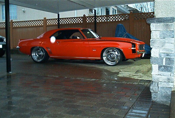

Sold my old wheels just ordered a set of 20" rally wheels. 20x9.5 rears and 20x8 fronts.

Man Sandro....It just keeps getting better and better.
Please don't forget to post new pics of your car when you get a chance (sunny day).

That looks really good! I always liked the look of aftermarket 17+ in rallyes. Good Choice!! Thats car is insane...

Looks good! You should post some more pics, maybe some of the 2 Lui's cars.

Sandro, I just installed the 17" Rallye Wheels on my car. I am real happy with how they look. I did not realize they were making 20" wheels now. Looks great!

Thumbs up 20s look great
We need more pictures and specs! Looks great - what size tires - what backspace wheels? Then of course after you get a chance to drive it any rubbing issues? Thanks - Jack

I think this is the only 2nd 69 iv seen with 20 inch all round!
that specific wheel also gives it that "tufff" attitude wheel!
Cheers Sandro its going to turn heads!
more pics please

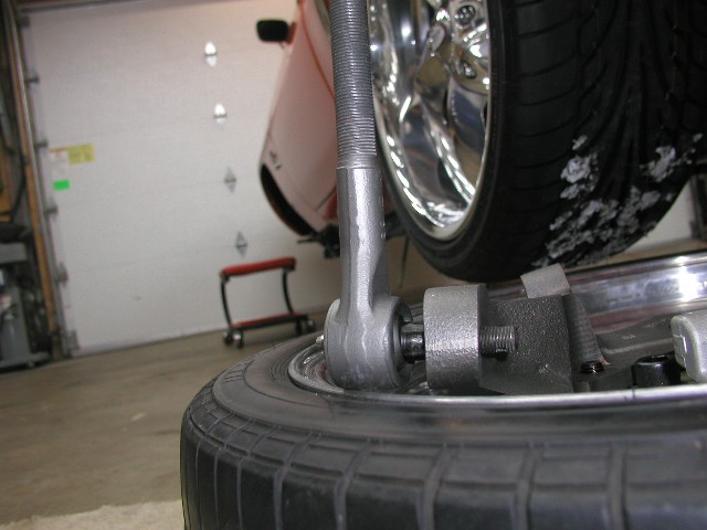

These rims r actually lui's with the red 68. I liked them so much I sold my wheels and ordered a set. The only problem is now I have no wheels . the tires I'm running r 285/30r20 and 245/30r20 or 225/30r20, Lui went with 225/30r20 in the front. his car looks awsome. The offsets I went with were 6" in the back and 5 1/8" inthe front. One of the resons I went with these rims is that when I installed drop spindles on my car it ended up putting my tie rod ends to close to my wheels, so I had to run wheel spacers. Now with the 20's it clears my tie rod end completey and in the rear my new rims r an inch wider than my old ones. every inch count's
