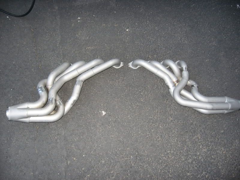

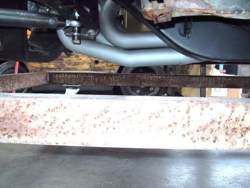

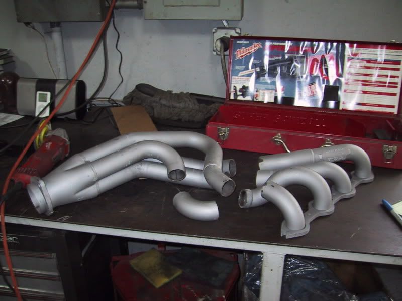

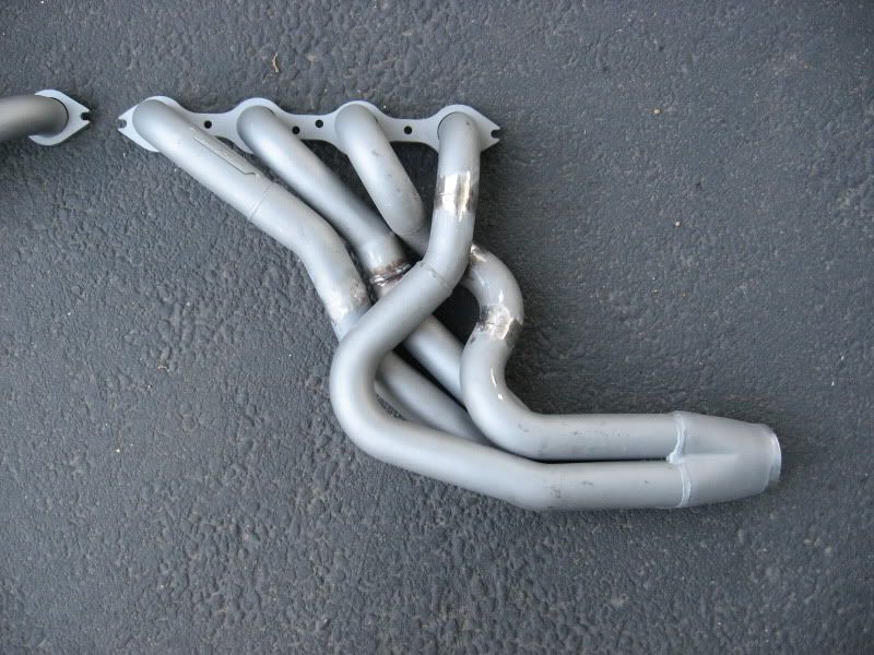

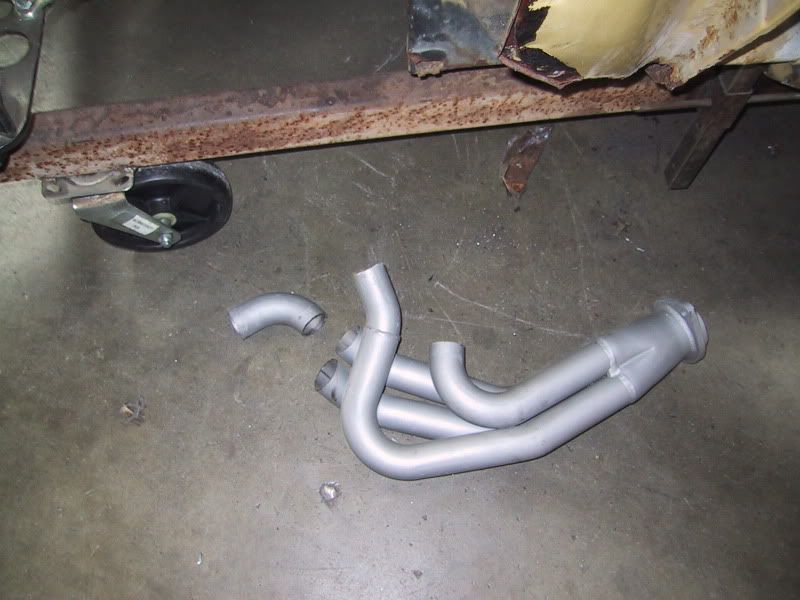

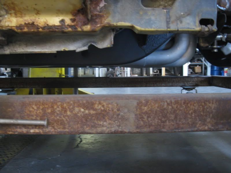

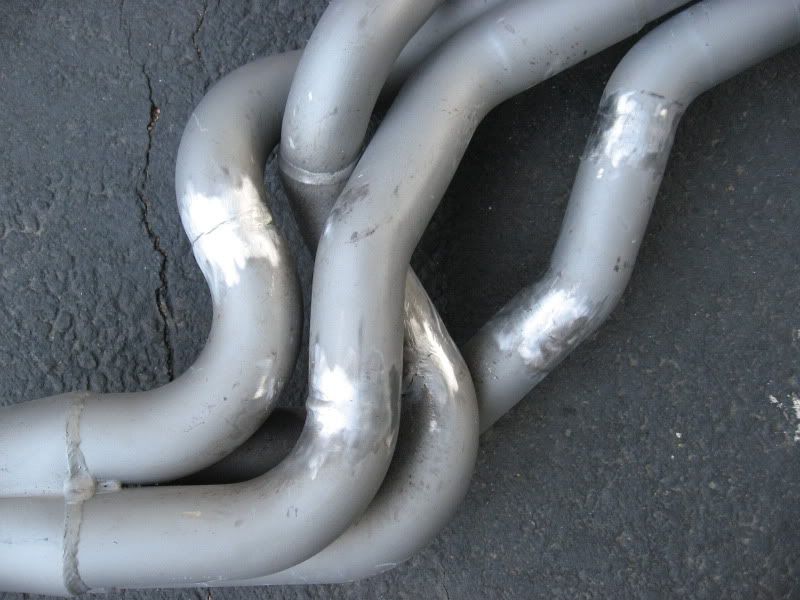

The Edelbrock headers are nice pieces, but since the car is so low, we could not have the header so low. We had to shorten the tube length and slightly change the angle of the collectors. We also changed the flange.
You can see that before we modified the headers, they were the lowest part of the car.
After they were modified, they are now about equal to the frame.

Tucked up nice and tight now!

Nice job on the headers, its a shame they don't come like that already.

Because the car is so low and the transmission and rear end are tucked up much higher than stock, the angle of the drivetrain makes the headers worse. They are probably good for most applications. Don't want to rip on Edelbrock. Modifiying their quality headers was still much cheaper than making them from scratch.

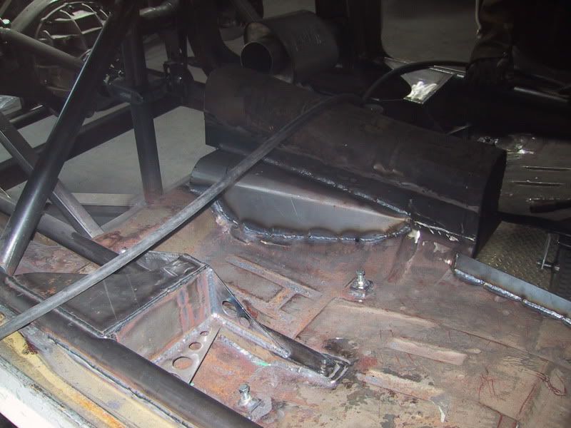

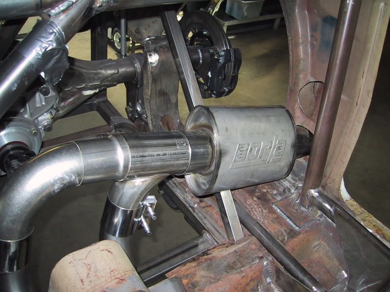

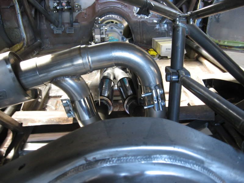

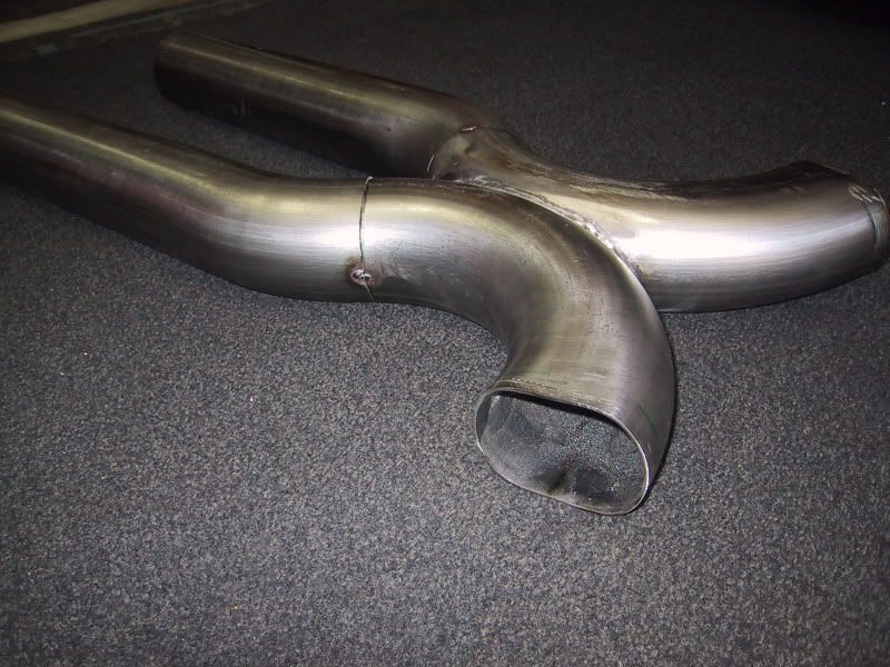

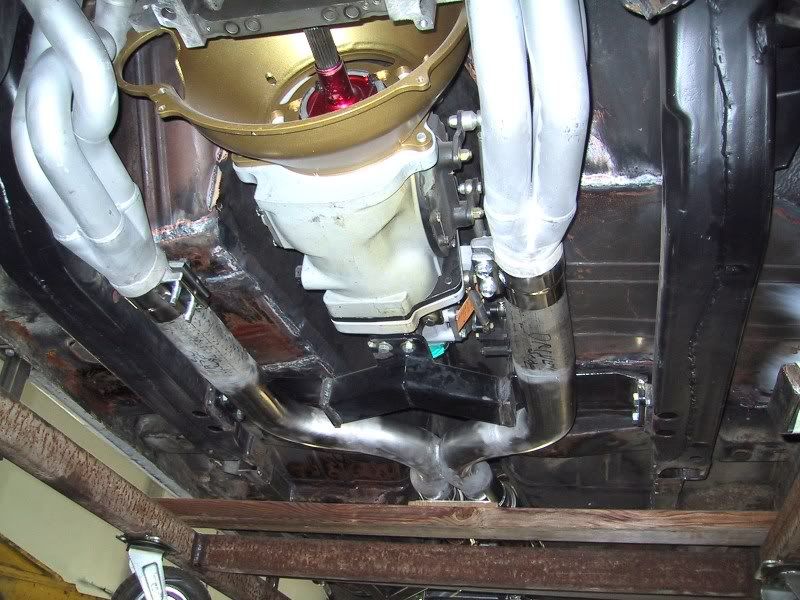

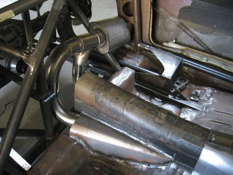

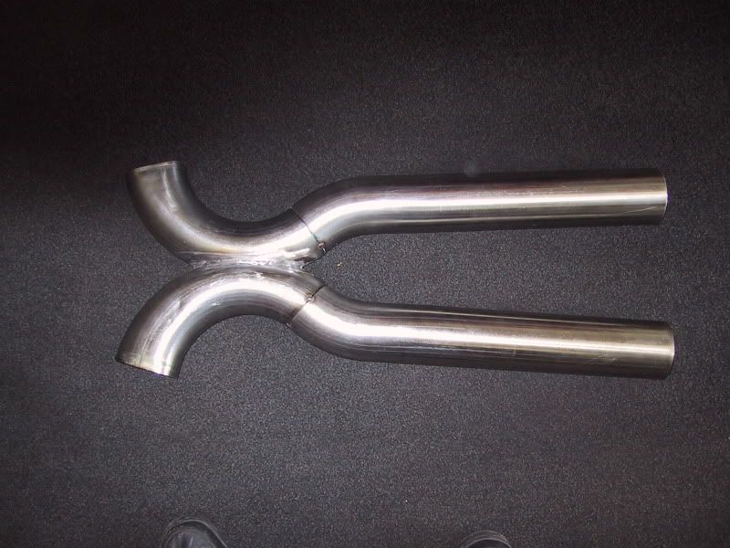

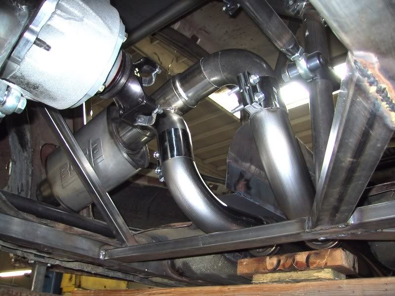

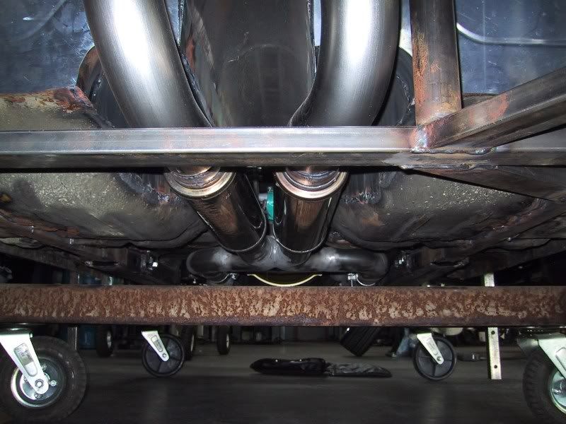

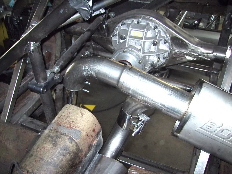

The exhaust system is just about complete. The edelbrock headers go into an all stainless steel pipe with a custom built cross over. There are two Magnaflow straight thru mufflers and then go into one pipe. After they merge into one pipe, the exhaust then travels thru a large straight thru Borla muffler. The goal is to get good flow and keep the car fairly quiet. The exhaust will exit out the quarter panel, between the door and wheel opening. I will show photos of that later. The tunnel had to be expanded for the exhaust.
