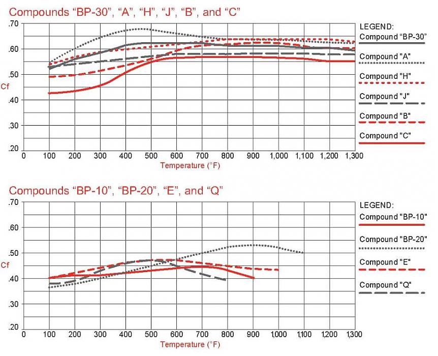

For conversation sake, let's use the Wilwood BP-20 pad & say you're working it in the 700 degree range on track on the front brakes. That puts that pad at .50 CoF.
* If you ran the same pad in the rear, it will operate at 150-200 degrees less temp in the rear & have a lower effective CoF number for the rear.
I attached the Wilwood brake pad compound graph for your review & a new chart showing all the brake calipers using a brake pad compound with a .50 CoF.
With the BP-20 pads, you'll notice your front brake caliper, using the same M/C, pedal & rotor would make 2556# of front braking torque. Assuming that is 70% of your braking, the total system would make 3652# of braking torque.
I'd like to see it closer to 4000# for your track days with slicks, but we'll need to find a pad with a relatively predictable torque curve in the .52-.55 range to achieve that. Once I know your rear system, I'll reach out to my guy at PFC.
