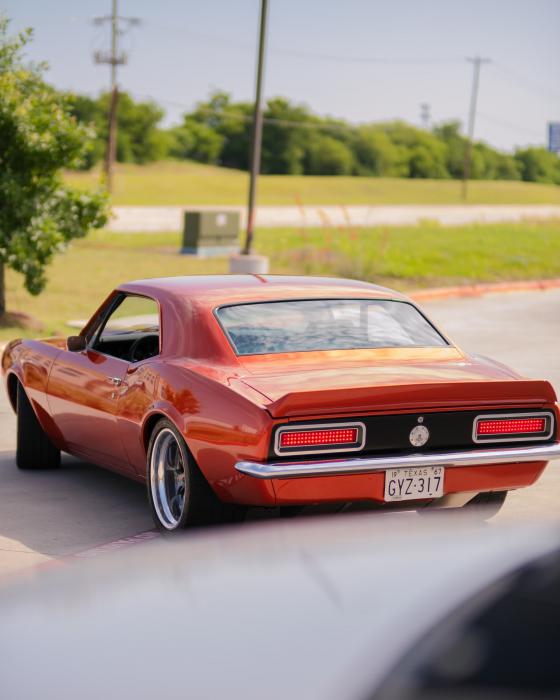

Well about 3 or 4 months ago i bought a 1967 Camaro from a guy in fort worth. Well Replacing a few nuts and bolts led me to ripping alot of the car apart. Currently the car is sitting apart and im trying to figure out what direction i want to take it.
I need some help with the steps of fixing this car up the way i want it. I stopped last month bc i felt like i was probably going to do things to the car that i would end up having to take back off so in essence wasting my time.
