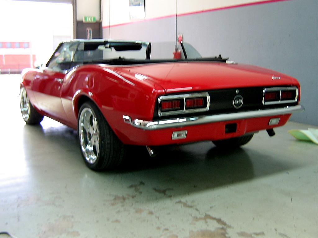

Old 09-21-2009, 02:13 AM
68LS1's Avatar
68LS1 68LS1 is offline
Posts: 361
Thanks: 46
Thanked 26 Times in 15 Posts
Smile Update
Boy those 9 months went quick. Well we started it up today, fired up straight away and it settled in to idle perfectly. Very happy about that, since I purchased engine & gearbox way back in 2001. Just some recent pics, now to get bumble bee & black tailpan painted, then finish assembly. Waiting on bumper bars to come back from chroming. Seats at trimmer already and has material now. Should go over to trimmers in a couple of weeks to fit interior and roof. Not much longer now, .

Talking Update, at the trimmers
Well car arrived at motor trimmers today. They want it for about 3 weeks. Really getting close now. Some pics from this morning.
Roger
