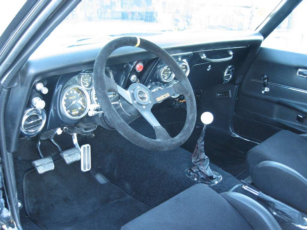

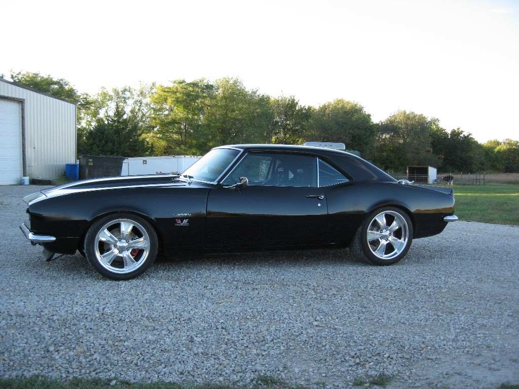

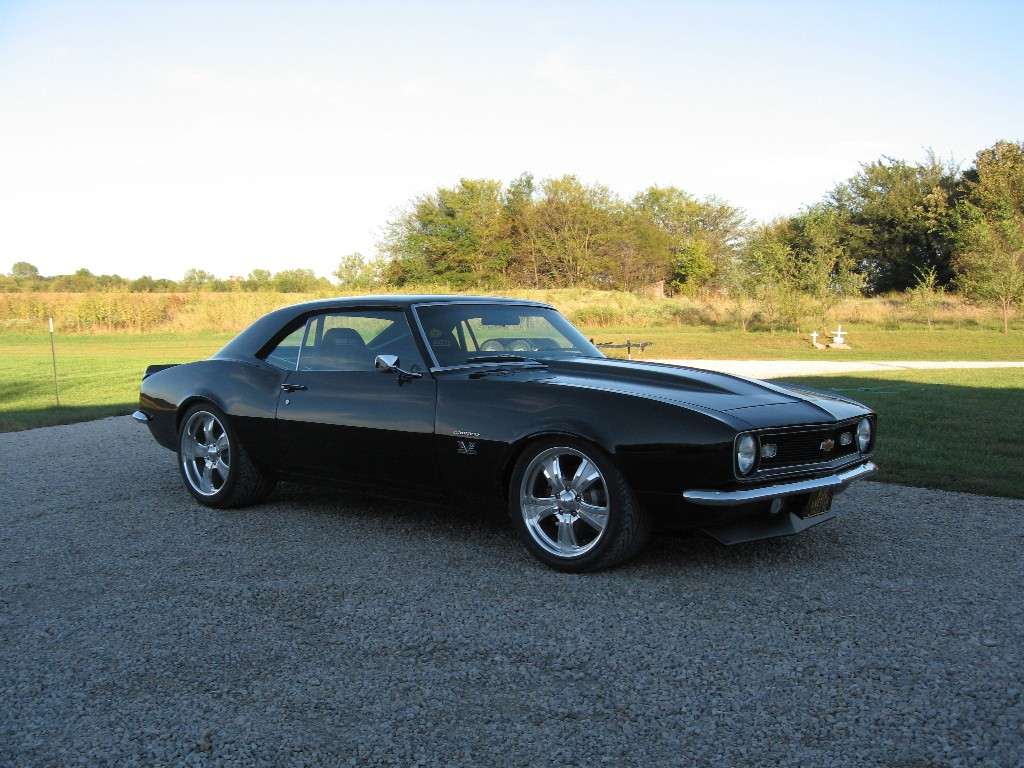

I have been busy putting the final touches on the car. What do you think?

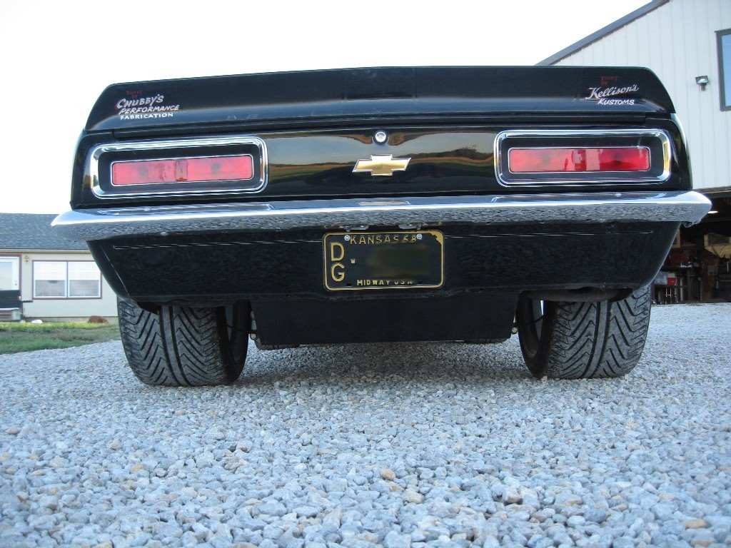

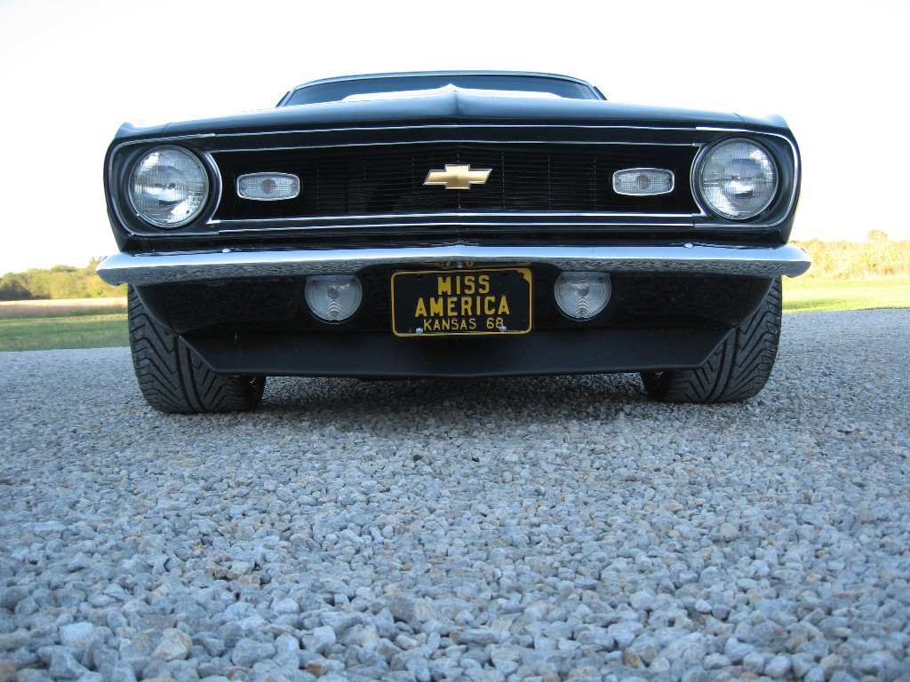

Some more shots

Dude...how can you name the thread "Big Block completion photos" and not include pics of the engine?
Ya' big tease.

Killer ride! I like the deep backspacing.

Sweet ride for sure. Any more info or specs on it?

Very nice "Camero"

Originally Posted by Birdman
Very nice "Camero"
I was waiting for someone to say that! LOL
Great looking ride.

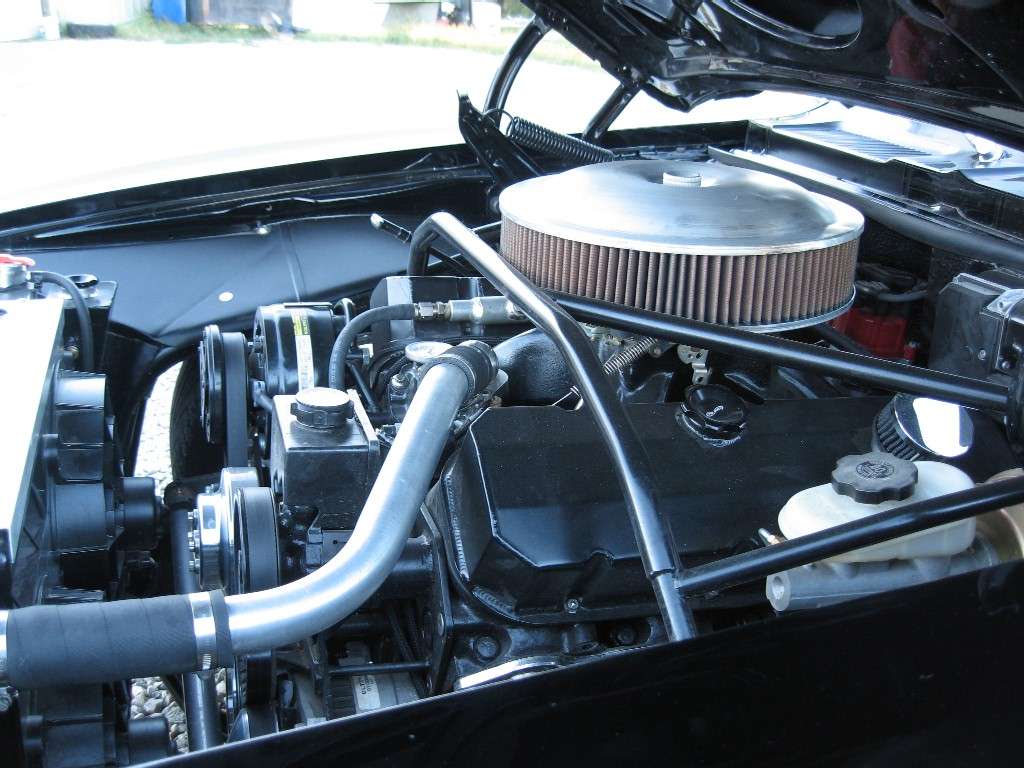

All business under the hood.

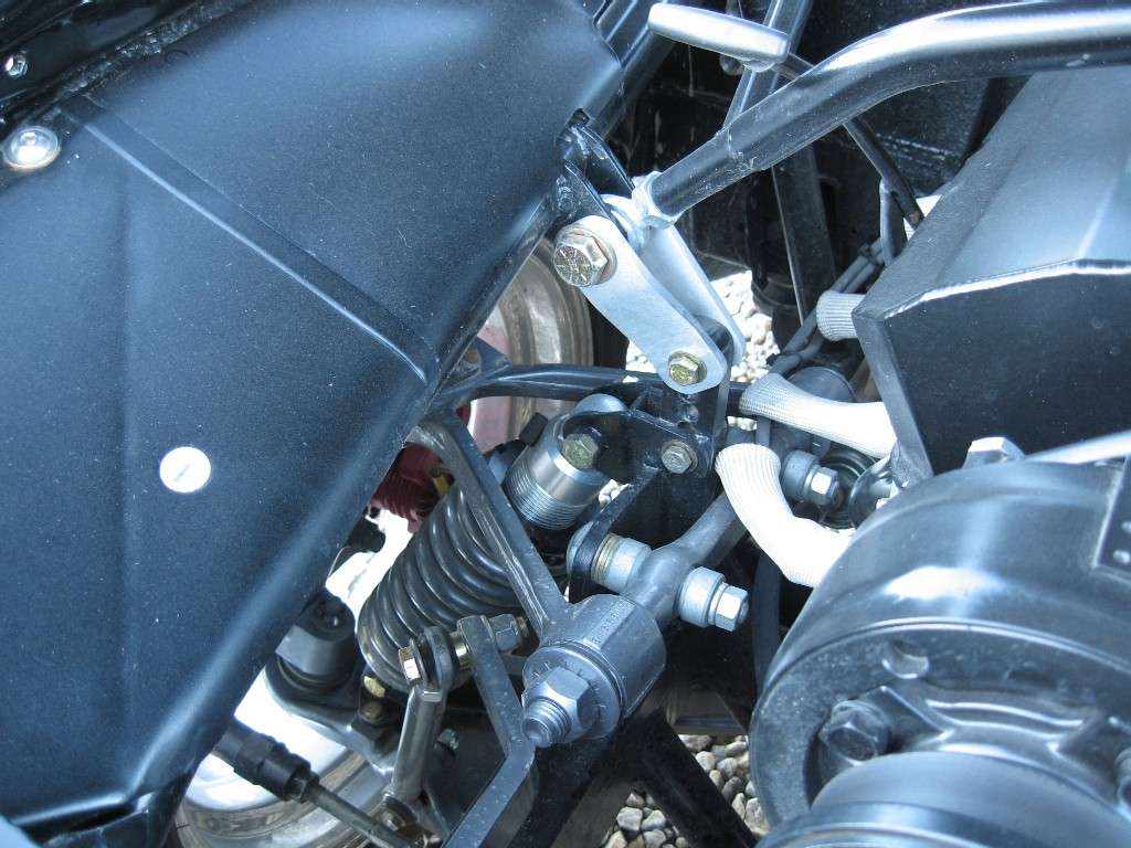

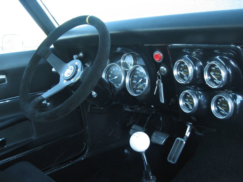

Started W/ rusted org. bigblock hull Every pc. of sheet metal goodmark makes was replaced but the roof.Frt. sup. Built a jig off the frt sub. Then built my own subframe using C4 corvette QA1 coil overs. Moved the motor back 5 in to clear C4 rack. Rear sup. is 4 link Like what was used on the mule. But shocks lay horz. w rocker arms like Foose camaro. Stock w 12 bolt 4.11 gears intro matrix wheels 19X13 W/ 10in. back space. Frts. 18X11 w/ 9in back space wanted the wheels to have close to the same off set. Tires are michs, 345/30 /19 rear & 315/30/18 frt. Quick flip fuel cap frenched in the left rear quarter . Like dale jrs . Mine was done in oct 06. great minds think alike.69 camaro park lamps in lower frt. valance used as driving ligths / high / low beam Sparco seats and steering wheel. TKO 600 5 speed Zoom clutch hays 40# flywheel ATS style hyd. clutch. Will tell more later snap tool man just pulled in the drive way. Later Scott.

That engine compartment and suspension looks killer, very sinister in the all black. Great job man, the car is SICK!
