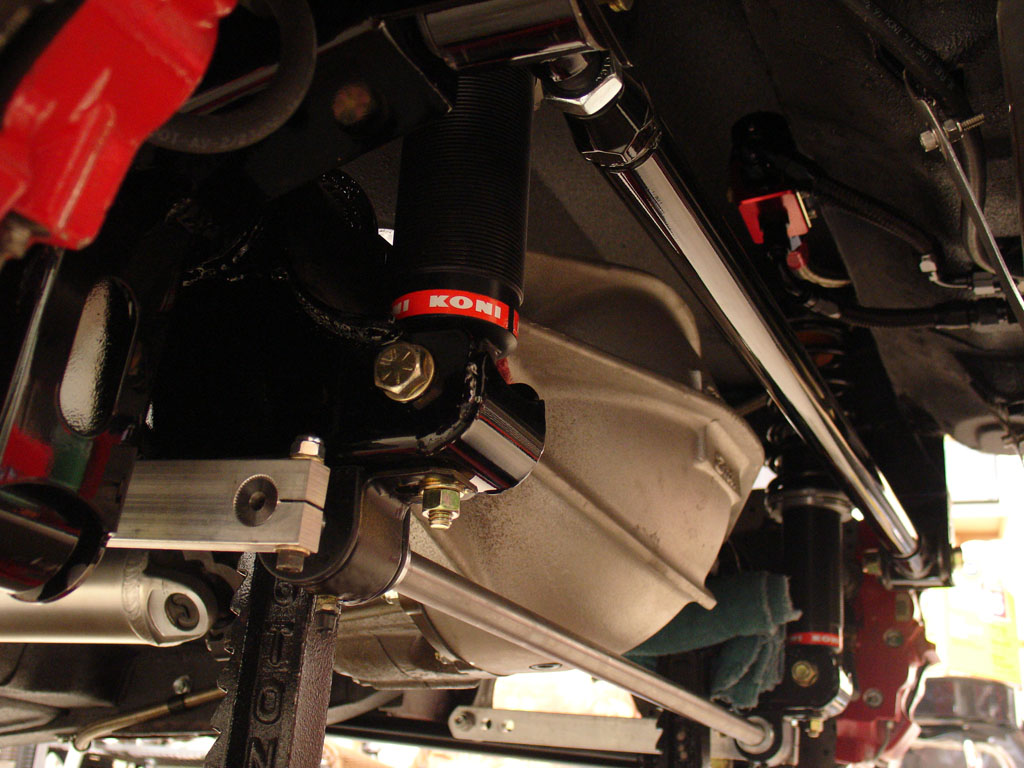

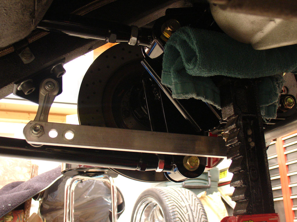

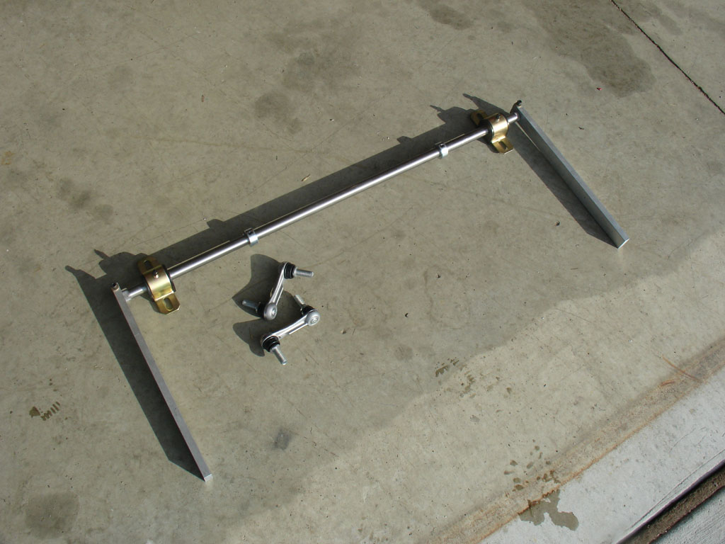

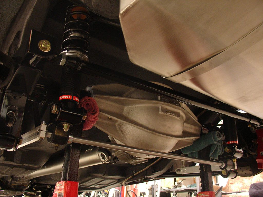

This isn't a huge update by any means, but thought I'd share some pics of the ATS splined sway bar because it's such a nice setup. I drilled multiple holes in the arms for some adjustability and made a pair of small brackets that attach the end links to the body. The bottom side of my frame rails are are solid steel that's about .250" thick, so I drilled and tapped 2 holes at 1/2-13 and used allen head bolts to mount them. They feel extremely solid and I have to believe the splines on the aluminum arms would fail before the threads would.

That loks real good, the only think that I can think of is it might be a better idea to use double shear endlinks, that way it won't fatige the aluminum as much.
