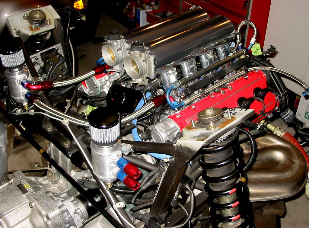

I also have a local guy who might fab one for me to add a third to the test. Here is the one he made for his Ferrari.
VAN, I trust you its the shipping companies I dont. I am in chambersburg pa . It is about 2.5-3 hrs from Pittsburgh.
