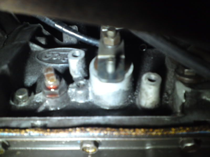

After the winter storage of my 73 Mustang i found it leaking transmission oil, beside the shifter link were i had a leak last year.. How do i fix this leak?

Your going to have to replace the band adjusting nut. It has a rubber type seal on the back side of the nut.
