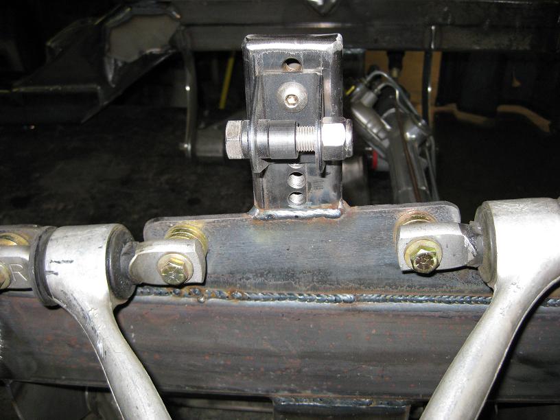

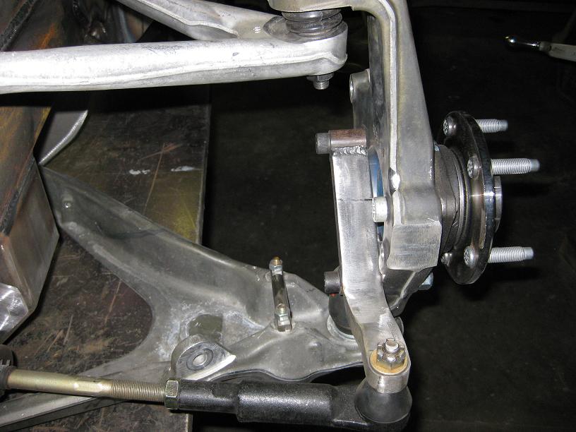

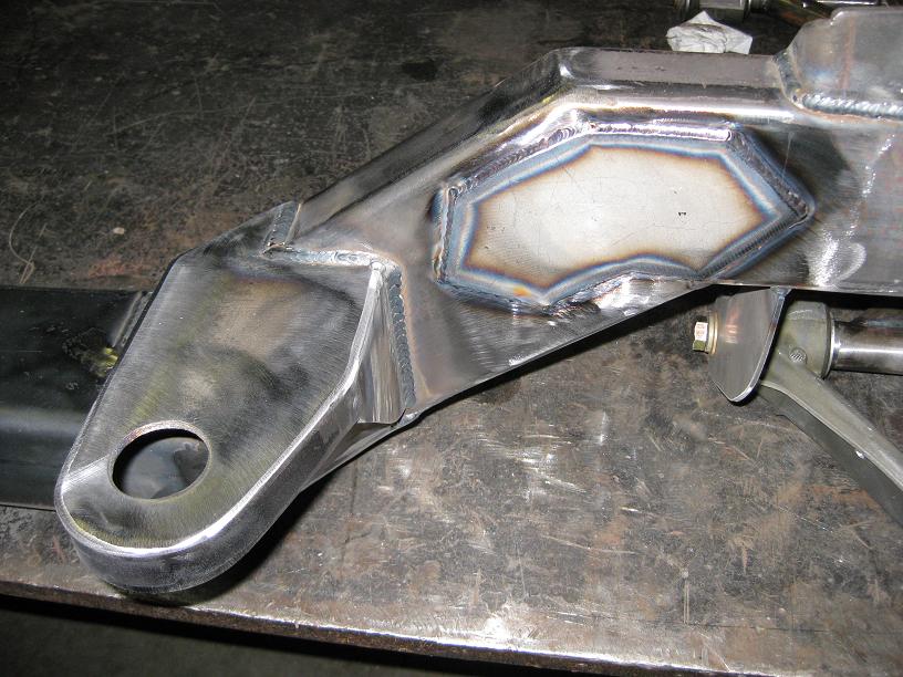

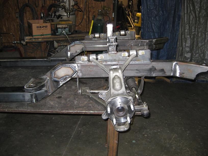

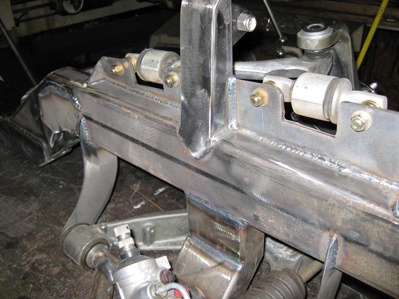

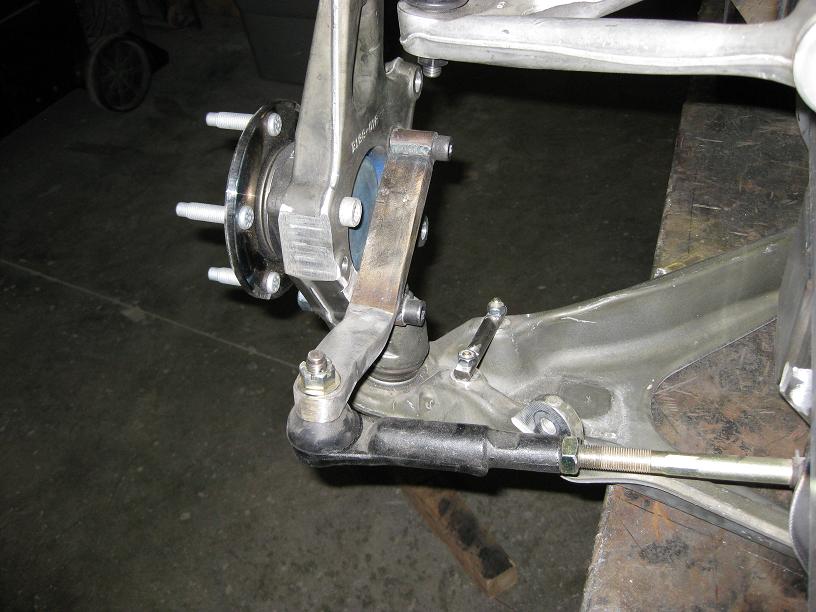

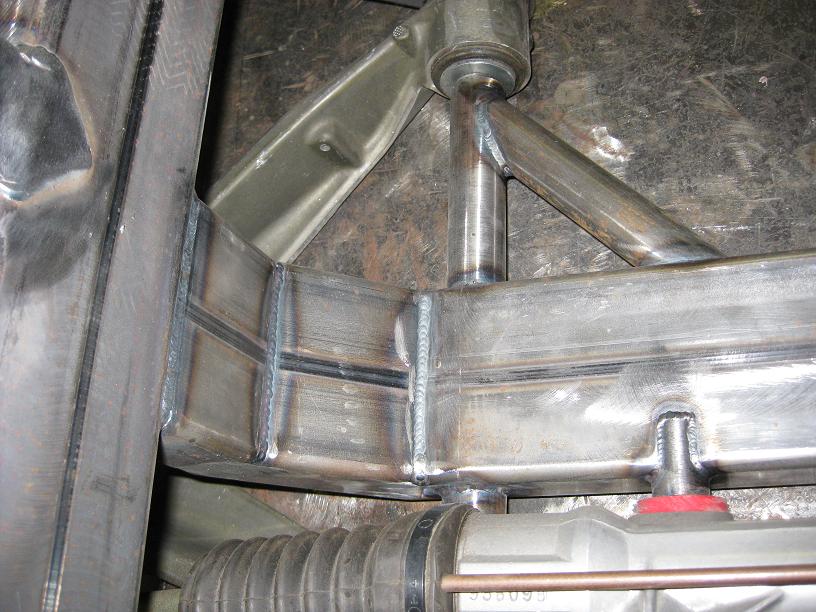

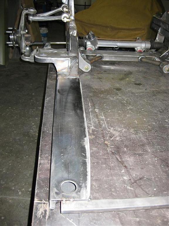

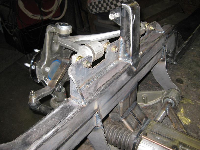

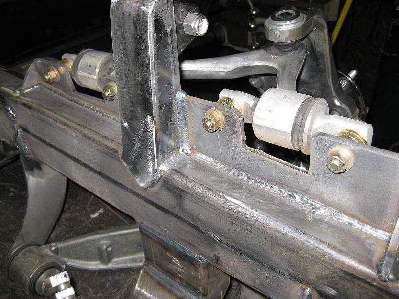

Yesterday it snowed 6 inches so i went out in the shop and fabbed up a new subframe for my next project car a 72' camaro. When the weather gets a little nicer i am going to get the shell media blasted and get started on the sheetmetal install. The car is a little rough right now so i am going to wait until it is in a little better shape to post pics...so far the only pictures i have are of the subframe. Scott

here are a few more pics of the subframe for the 72' camaro. Scott
