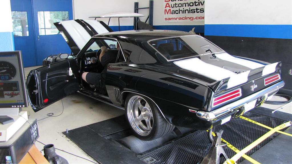

Finally got the car on the dyno. After the first pull the IAT sensor went out. Once we had that sorted out we started experiencing belt slippage issues, which I learned is typical with a ProCharger on a C5 bracket set up. We ended up installing a belt that was a 1/2" shorter once this was installed we fired up the engine only to here the impeller touching off inside of the blower.
Before the blower issue happened we were able to get 600hp with only 7psi of boost. This blower should easily put out 14psi and make between 700 to 750 HP.

600hp is pretty impressive! Im sorry to hear about the blower issue. How can the impeller be hitting the casing? Wouldn't it self destruct at that point?
I have zero exp with superchargers, just curious. I hope you get it figured out easily.

Not sure why it hit, lucky it was just idling when it happened, without taking it apart I can see a couple of blades missing on the impeller.
