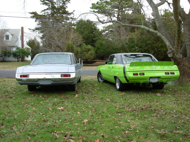

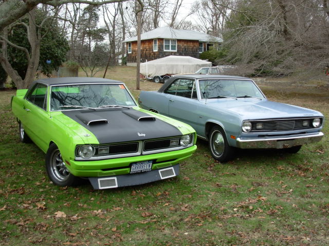

mr angry turned me on to this site.I also live on LI,ny.Im enjoying all the great iron on this site.Ive included a few pics of my 70 dodge dart swinger that I have owned for about 14 yrs now.I hope to have some better pics soon.I always had a vision of building this car to handle from day one,but in the beginning that wasnt so easy because it was hard to find people who were building these car for that purpose.Info was kind of scarce.I met peter bergman who owns a 71 swinger and he had the same vision only he already done some r&d.He gladly shared all of his info with me and then Id try some things and shared that info with him.We keep going back and forth as are cars evolve.Thats what is great about this hobby ,many friendships can be formed.I met mr angry through pete,great networking.Any way glad to be aboard .Ill try and get a spreadsheet together of my cars internals.Right now im in the proccess of revamping my cooling system;Howe alluminum rad,Spal dual 11" fans,with programable controller etc.Hope to run the last leg of the power tour this year from PA to NJ with Pete and Angry.Maybe we'll meet up.

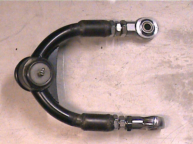

If I were to do another mopar it would probably be a duster.Shorter wheelbase 108" compared to 111",lighter and you can fit more rear tire.The e-bodies imo are probably the best looking styling wise of all the mopars and I think they have a wider track,you can do alot with this model.Yes there are a lot of over the counter parts now available for these cars and it seems there is more stuff coming out every day.If only someone would come out with a stock replacement quick ratio steering box for the a body.Alterk-tion,ARengineering and Firm Feel Inc make some nice stuff.
the stuff I have is a combination of model specific and custom stuff.
1.04 chrysler torsion bars
custom 1.25 front sway bar w/heim joint ends,by sainer engineering
carerra econo circle track 500lb 50/50 front shocks w/home made nylon bushings,from 69 camaro(because of lower ride height)
FFI tubular upper control arms modified with fully adj. heim joints instead of bushings

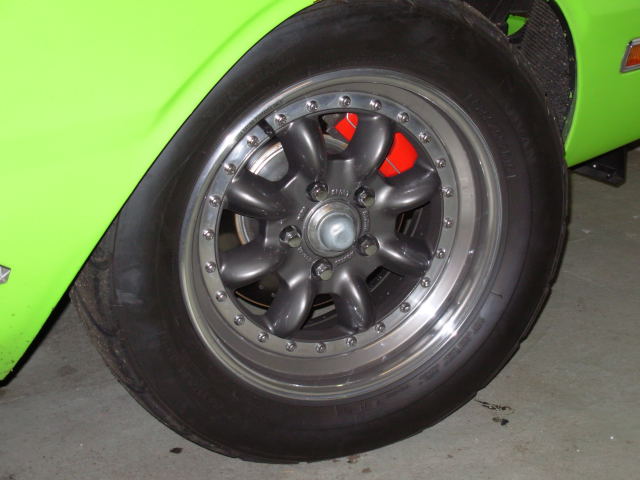

factory 12" rotors(I had them cross drilled and zinc washed)
factoty calipers

16x8 pannasport 3-piece racing wheels(15lbs ea)
255/50/16 yoki's ao32r
