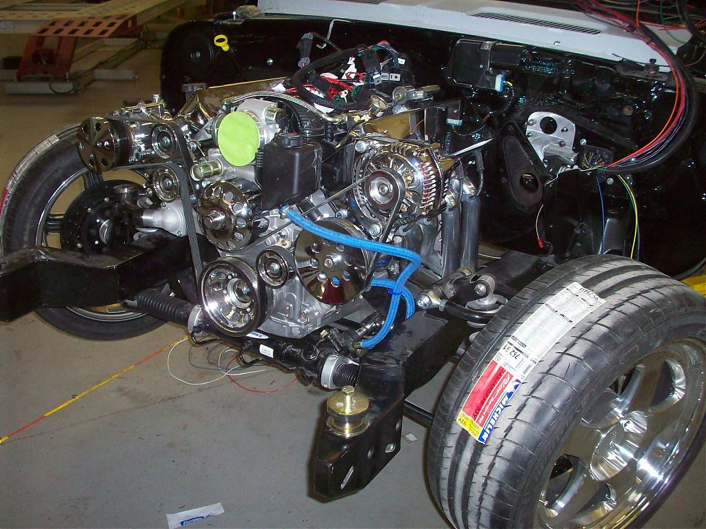

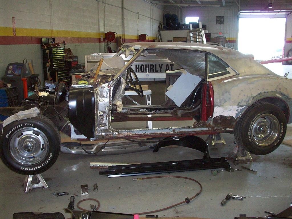

So, WTF am I building? Started out with a steaming turd I bought about 10 yrs ago, a black 68 Camaro coupe with a vinyl top and with a 210 HP 327 and a powerglide. Paint was all spidered and it had manual drum brakes all around, but the interior was nice, so I thought it was restorable. I didnt know squat, except for the fact that I wanted a Camaro, preferably 69 because I was born in that year, but on an impulse I ended up with the 68. Stripped it down and had it media blasted, and did the unthinkable, handed it over to Maaco for a cheap paint job and some rust repair. Left it that way for 5 yrs, swapped in a 383 and a TH350 and lowered the gears from 3:07 to 3:73. Then I got cute and had some guy my brother know add 76 Trans Am disks all around and then we put in lowered springs front and rear and put in solid mounts. The brakes were horrible and the car was a bigger rattle box than ever before, and now the tires rubbed constantly. So I ditched the car in a garage for 4 yrs, got married and had two kids and rebuilt our duplex loft in downtown Chicago from the studs in, and still made enough trading to tackle restoring my old heap. And in the meantime, guys like Detroit Speed and Alston and Art Morrison and Wilwood took off from where Gulstand and Hotchkis and Global West started out, and gave all of us a reason to breath life into these beautiful old cars other than concourse restorations. Gave her to Corpo Collision in Schaumburg, Illinois with a referral from a friend who restored cars but was too busy back in October of last year. Was just going to put in a front clip and get the metal restored and painted. They had a 57 Bel Air with an Art Morrison full frame about halfway done, and my imagination took off. The head guy there, Nick, has been helping me since, doing as much research and helping me handpick EVERYTHING down to billet washers. And yes, Im bleeding out. I should have got some sponsors. This is anything but cheap. About two weeks away from paint and a month and a half from getting her on the road after 4 1/2yrs.

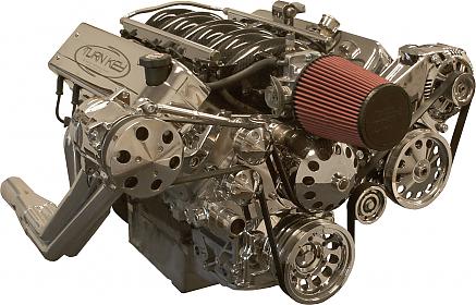

Turnkeyenginesupply LS2 w 520 hp and 500 ft lbs trq w polished front runner and carbon fiber intake.
Chris Alston Chassisworks Street Machine subframe w tubular arms,power rack,coilovers w varishocks,13"Wilwood G street Black Dynapro setup 4 piston,billet LS mounts.

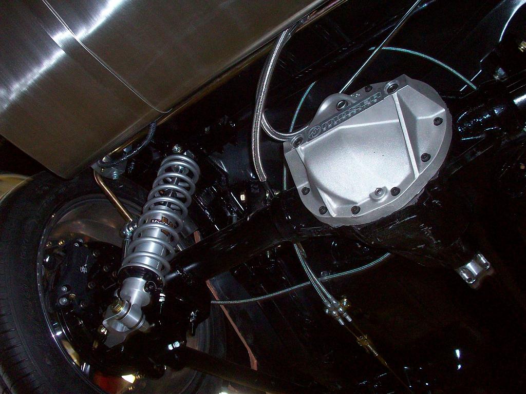

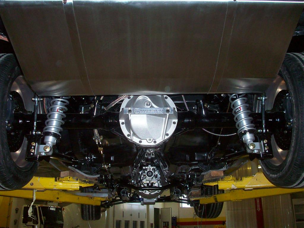

Chris Alston Chassisworks G bar 4 link rear suspension, subframe connectors, and Wilwwod Black Dynalite 13" setup 4 piston.
Fikse Profil 5 18x8 f 18x9,5 r, 245/45zr18, 275/40zr18 Michelin Pilot PS2
Hydratech Hydroboost, Wilwood Master Cylinder
Ricks stainless LS tank and Walbro 255gph pump
Ron Davis LS Radiator, w dual fans
Moser 12 bolt rear,solid axle,aluminum cover,373 gears
Tremec TKO 600, Blackjack shifter
DSE closeout, wiper motor,RS headlight kit,shift knob,Optima trunk mount

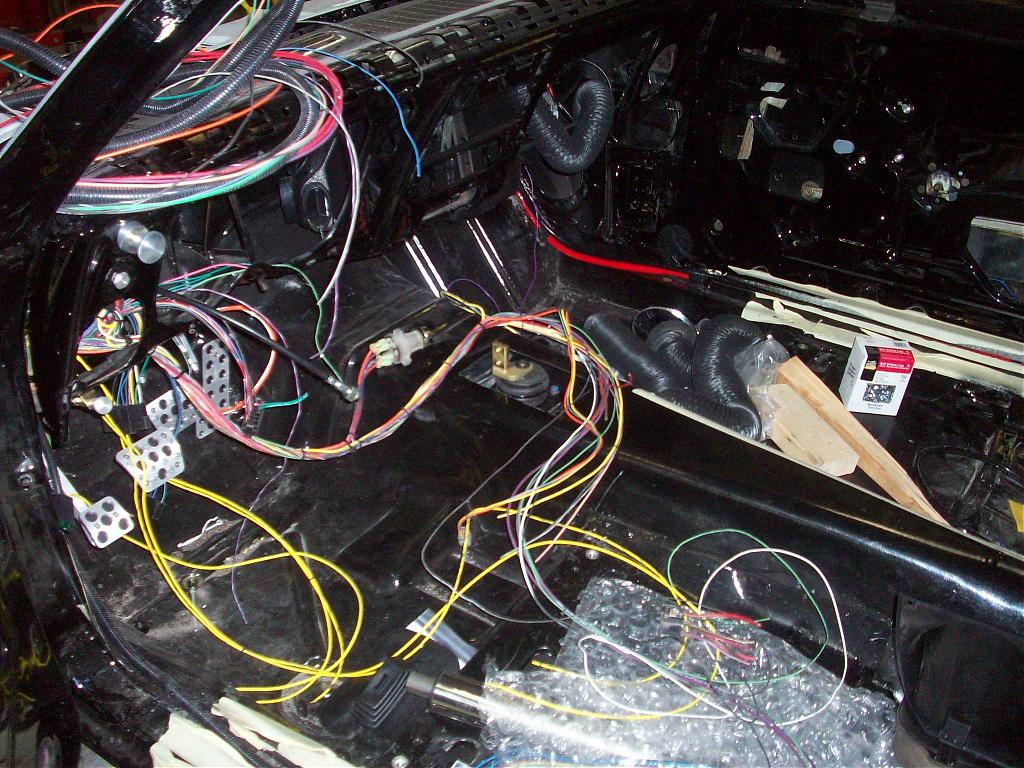

Painless 18 circuit 1st gen camaro kit
Anvil Auto carbon fiber front spoiler
Modo Innovations pedals and trunk popper
Fesler billet hood and trunk hinges,door jamb vents,strikers, and washers for engine bay
2006 GTO front and rear seats , removed from 3,000k mile car
Marquez doors,trunk lid, and package tray
Isotta Katiena wheel on a Flaming River stainless tilt collumn
Twist Machines billet adjustable 8" shifter (not sure if this is staying)
Ridetech 67/68 billet gas locking gas cap and vent
Vintage Air Gen IV
Always loved the look of first gen z28 stripes, going PPG black w white stripes on all brand new metal (except trunk lid and roof and firewall). Love the look of all blacked out cars, but also love the classic look of the stripes. Didnt want to tub it out, figured 275's were big enough, but it looks like everyones doing it now, so maybe I screwed up. Wife and I love the look of no front bumper, but if I park it once on the street here in Chicago, some chump will use his bumpers on my sheet metal while parallel parking. Life in the big city. Heres some pics of the project, and if any of you have any advice, comments, or criticism, Ill truly appreciate any and all of it, after all you guys are the pros. Plan on taking a few driving courses and trying out some autocross' ASAP, and just plain old cruising in it with my wife and kids. Midlife crisis calmed for now. BTW big influence on this car was Rockdogz 68 Camaro, Bad Penny, Steve Lenning's 69 Camaro,anything from Steilow, Fesler, Prodigy, Ring Brothers, and also Amy and Tom Craigs Z28.

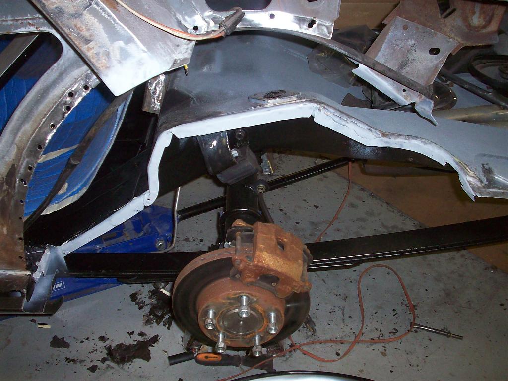

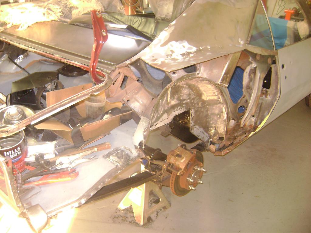

Cool project Rob! In the one pic you had the outer wheel well out - was that only for repair? Keep up the great work! That's flattering to think that my car had some bearing on your direction!
