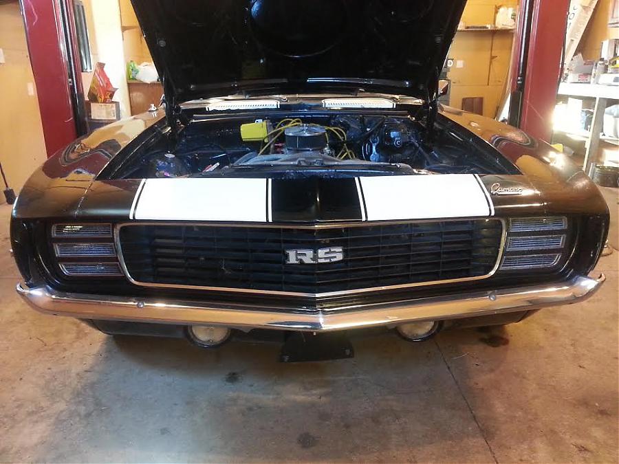

I know everyone likes pictures so here are some for all of your enjoyment to look at while you're helping me....lOL ;P
