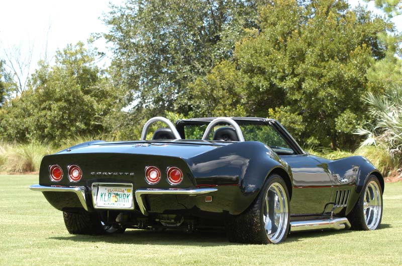

I meant to add that I have this car back in my shop right now:
https://lateral-g.net/mcdonald/
I sold it a number of years ago - the new owner put in a bowtie LSx 427, Auto trans..and different wheels. They had added an ISIS system that took a total dump and was driving him crazy, so I have it with me to put an American Auto Wire in and some other things.
I suspect this had "some" influence on my wife's thought process.

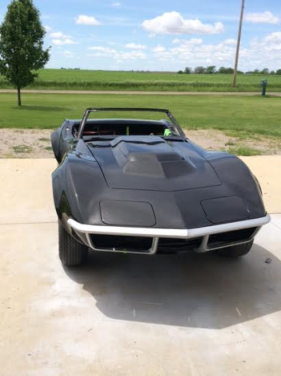

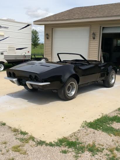

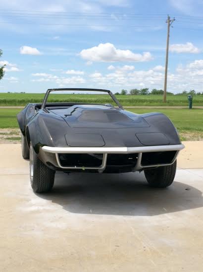

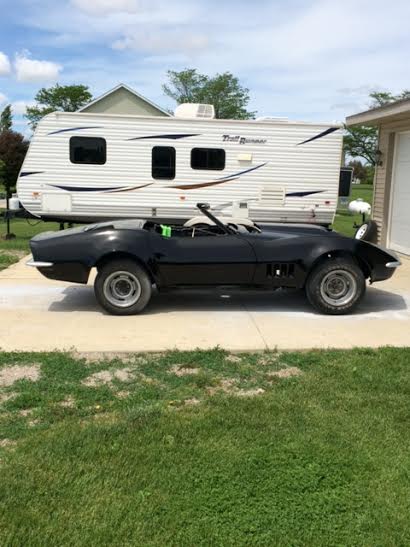

Well...its all over but the color sanding and buffing. Took me four days of paint time starting with the jambs - then the main body (sans doors etc) then the doors, hood, deck..then finally the bumpers. I sprayed it using Valspar and their 4400 clear. I'm very pleased with it - all of this over valspar epoxy sealer.
There are a lot of things going on here - I fitted 2012 Camaro side markers and selected a smoked out version. The bumpers are fiberglass from Custom Image Corvette that I fitted to a 1/8" gap all the way around. It also has the CIC 4" rear and 2" front flares...
Anyway, she is happy with it. This color black is absolute total black. Not another tint added.
