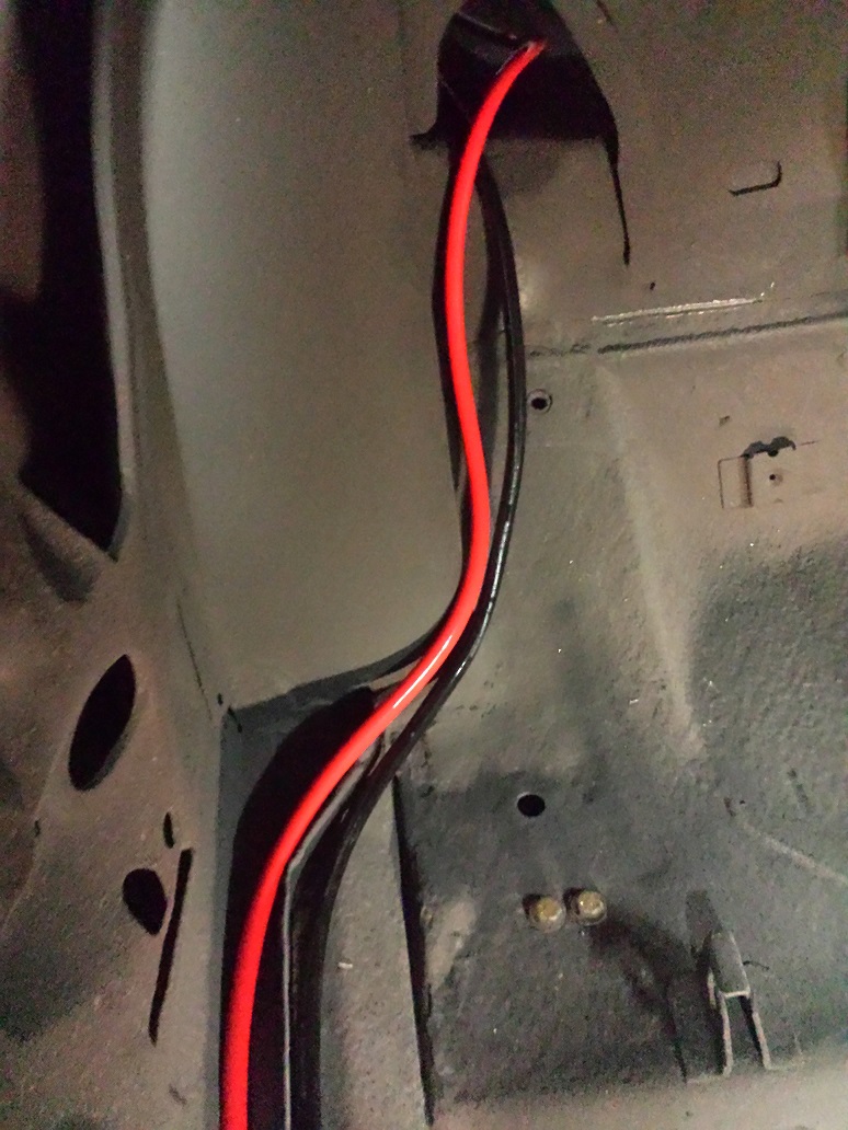

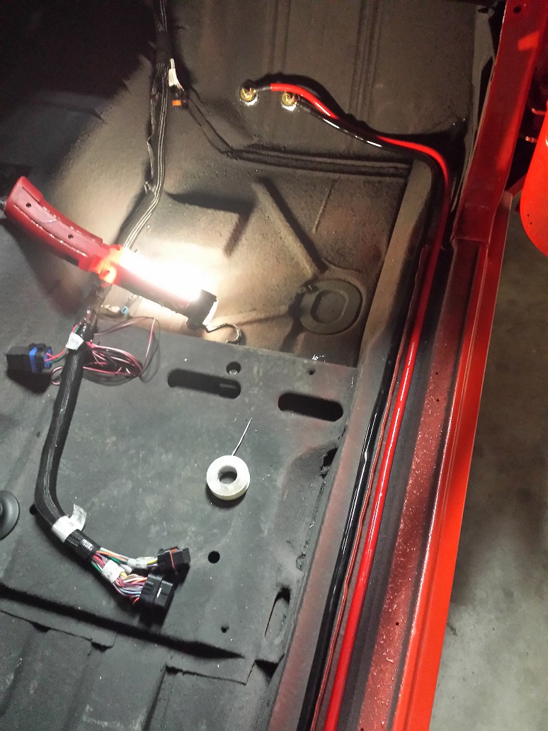

Is this a good place or am I going to run into issues. Just want to check before a bolt them down.

That's how I ran my cables too. So far no issues.

You just use cushion clamps to mount them?

Yes.

Remember that stuff vibrates -- thus RUBS -- constantly while the car is in motion. On a Yacht - you must anchor wires every 6 inches... I pretty much use the same rule when doing automotive. The LAST thing you need is a hidden cable shorting out.
IF there is any metal near the piece (hot wires) I wrap the hot with extra abrasion protection. I also never just pass hot wires thru a body with or without a grommet. I use bulkhead fittings like the ones shown in picture.
Also -- not sure why you're running a ground cable like that. The body and chassis are "ground" --- so you could have saved yourself a lot of cable by just running the ground from the battery to a good spot (clean metal with star washers or a good welded stud) as close to the battery as you can (making it all look good and having some flexibility to move the battery with still being hooked up etc.
I then add a short piece of ground between the motor and chassis.... remembering that this needs to be able to handle 200+ amps... If you don't think you have a good enough contact between body and chassis - you can also add a short ground strap between the body and chassis.

I got the kit from DSE. It came with enough to run both full length so I figured I would do it. I was also going to ground it to the chassis in the back.

I have this kit coming as well, and was planning on running both positive and negative the full length. Being a uni body car I figured it was best, I am very weak in electrical knowledge, can anyone chime in on the matter. Is this normal practice or a waste of cable. Like cywlie said the kit comes with enough cable to do this. So no extra money is spent. Interested to hear what everyone else does too. thanks

A shorter ground is a happy ground. It is best practice to make the grounds as short as you can.
