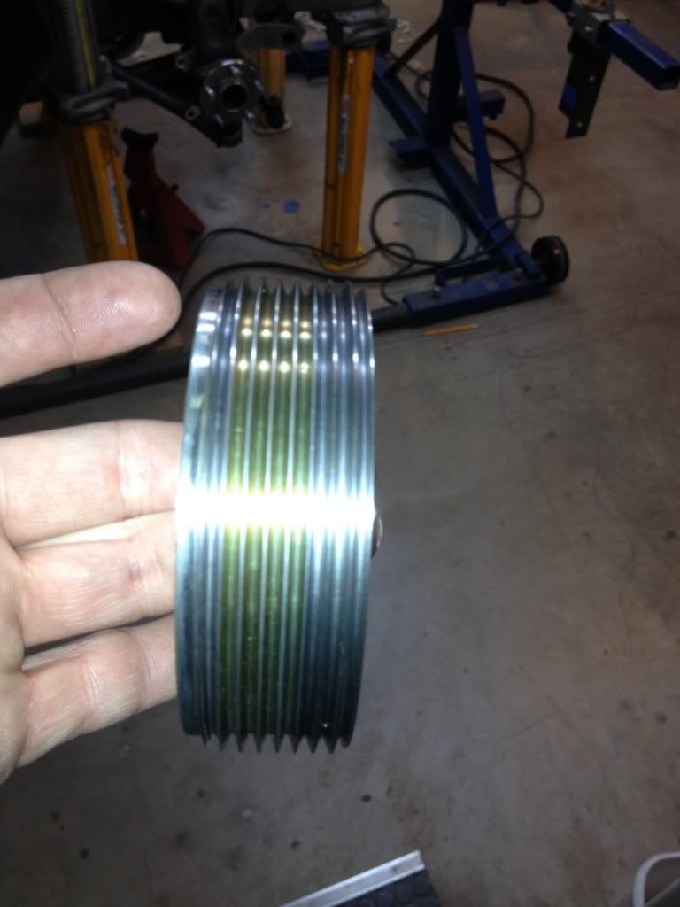

I Thought I had everything figured out for my set up a ls2 with a 2.8l Kenne Bell supercharger for my 65 Chevy II with a DSE Front clip. I tried to modify my original set up which was for a truck. This did not work because the belt was way to long and I was having a rough time lining up the pulleys. And when I went to fit the A/C on it hit the inner fender panel. So I modified the Kwik A/C bracket and I could not get the belt to run true. (see pic)
So I searched the internet and went through numerous magazines with no luck. Then I found Turnkey engines and talked to Paul. He has been working on my set up for about 3 weeks now. Since I had the Truck snout on my SC (which is the same as the 2010 Camaro snout) we started off by trying to run 2010 Camaro accessories, but this would not work because the Low position of the Alt would hit the cross member on my DSE subframe .
So I had my SC at Kenne bell at the time for a liquid cool upgrade and had them change the snout to a Corvette snout (shorter). Now we are trying to fit the Corvette acc but it is turning out that he area between the fender panels are to narrow.
I am at a loss now not only with my situation but my wallet. I really need some kind of help to get me back on track. I there is any shop or vender that can help please let me know!

Ok, This is what I came up with! I got the 180 amp back and found an 8 rib 1.9" pulley. Just finished up the sd7 8 rib pulley. Prw water pump, and Alper Motor sports p/s alt/ bracket, Kilby enterprises alt pulley. and Turnkey blower snout support. Oh and my custom a/c bracket.
