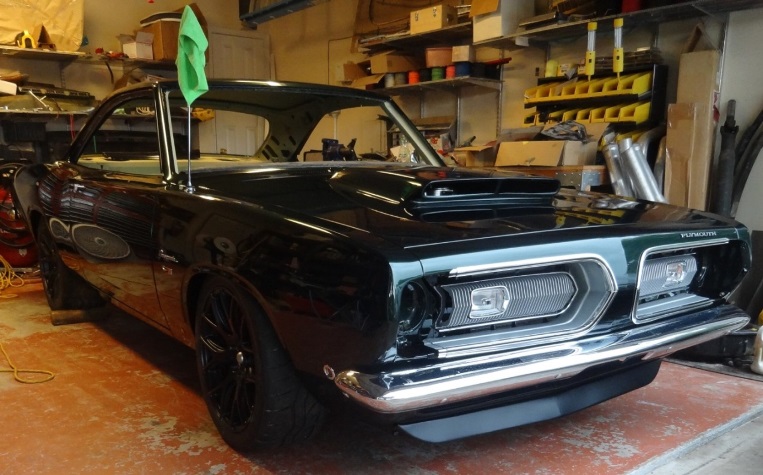

dukeboy... keeping the factory power steering? What suspension changes are you planning on?
Hey... that looks like a '69 Barracuda hood. FYI - They use the same hood as a '74 Dart if you did not know.
