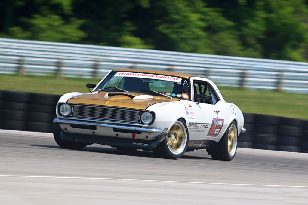

Larry Woo has this on his 68 and it looks very nice.

His fenders are widened and he has an aftermarket subframe.

Yeah, Larry also has some really nice custom fabricated inner fenders that tie all his other mods together.
This is not done easily on a first gen! I have a 275 rival on the front of my 67 with a DSE sub and a lot of fabrication time was spent on my inner fenders to make them fit and not rub.
