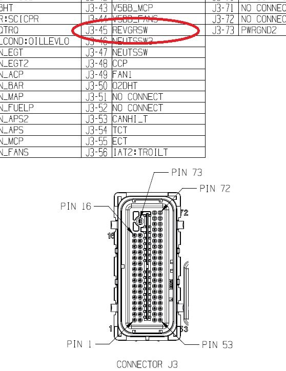

If using an LS engine & OEM ECM, you can add it the circuit to control the solenoid. Program the ECM for manual trans. That is what I did.
E67 ECM
Scot
86 Monte SS
LS2/T56 Magnum

You can have the brake activate it. Or you can use the ECM to activate it. I prefer ECM method.. since it's tunable (unlocked and locked parameters) by vehicle speed. But if you don't have a spare ECM pin laying around.. brake power and a ground to the other wire works well. We did both on Glassman's car. He's running ECM controlled now.
