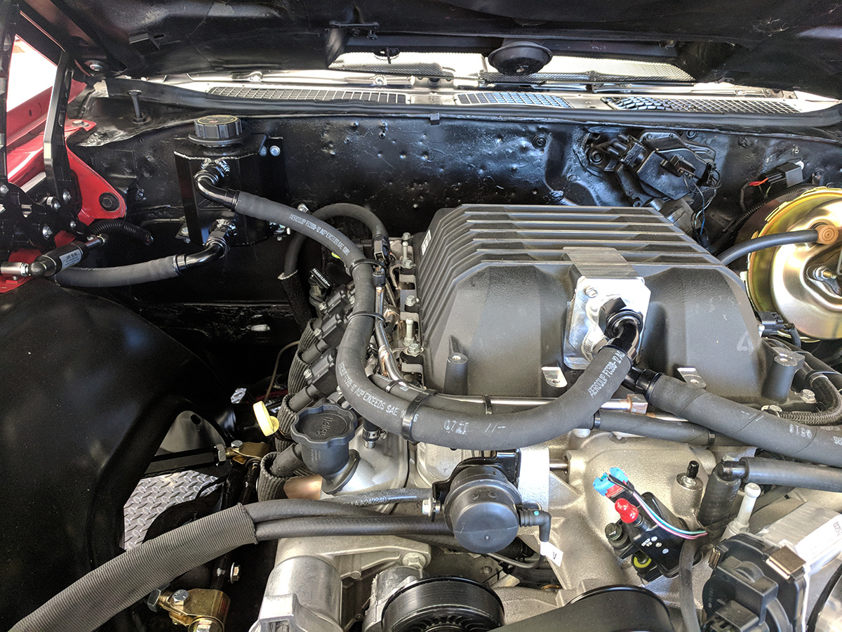

Old 06-18-2018, 08:25 PM
This guy built mine custom . https://www.facebook.com/paul.revaitis
here's a picture
