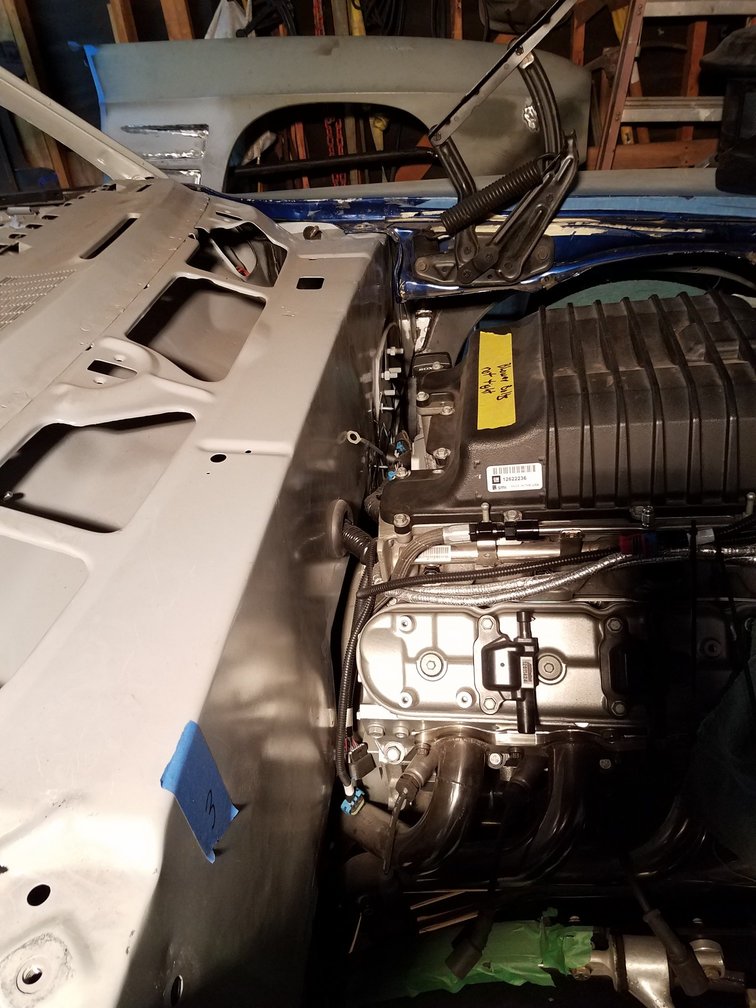

Here's a pic of my GMPP LSA harness running through the firewall.
Man that looks clean!! What size grommet is that and where did you get it?
