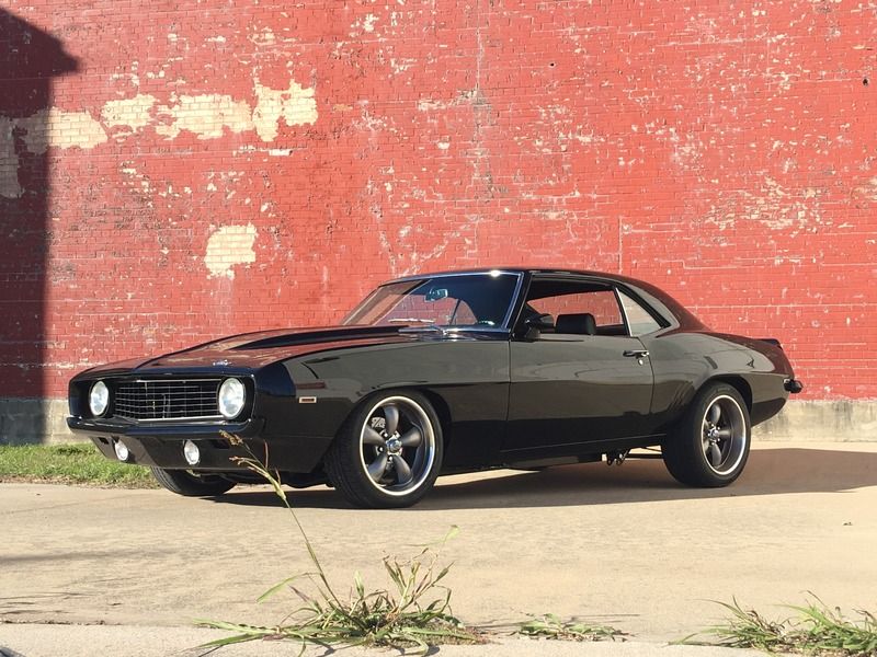

Here's my starting point and a pic next to the Viper
