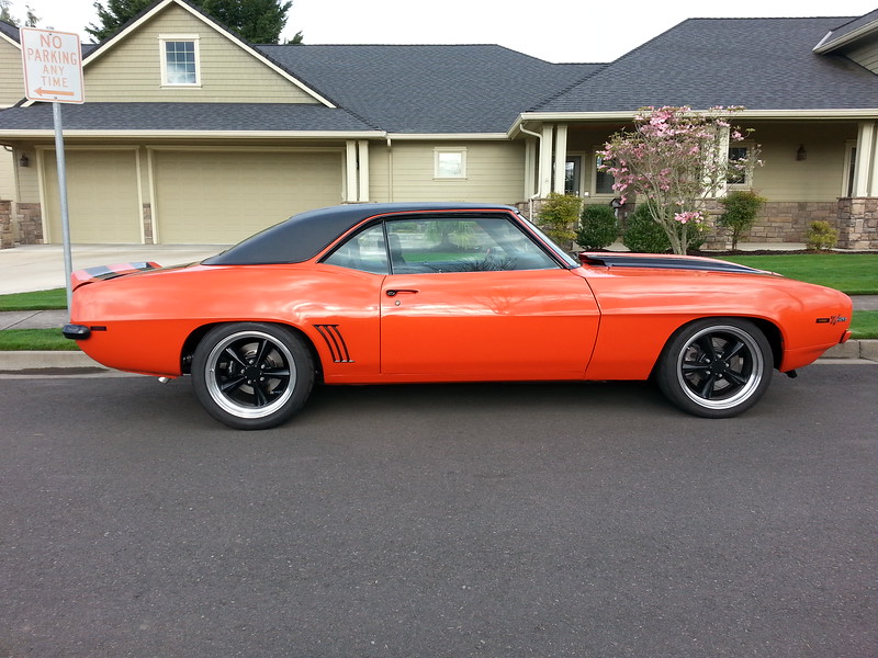

Joe,
My car was painted prior to my purchase in 1989 and I do not know who painted it. Best I can figure is they used a slightly texture rocker paint. Not sure on how they prepped the trim either, guessing scotchbrite scuff. It has held up pretty well.
When I had my wheel centers painted, I think we ended up using a VW rocker paint that matched texture and satin sheen quite well.
I need to replace the worn out drivers side mirror, my plan is to scotchbrite it and hopefully use the POR 15 Top Coat aerosol I have left over from painting my control arms.
I was very pleased with how the POR 15 sprayed out.
I know Mark used Cerakote on Hellfire's trim, he mentioned it chipped easily which surprised me as it appears to perform very well on firearms. Possibly the base metal deflects beyond the elasticity limits of the Cerakote. Charley may be able to provide more info.

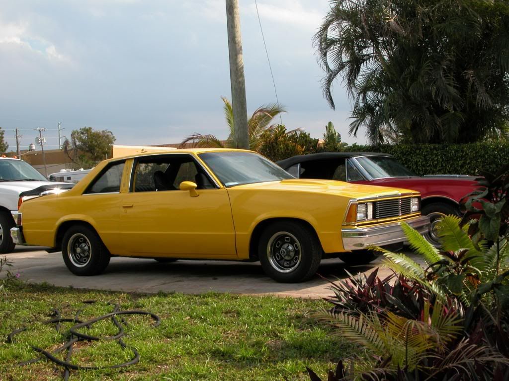

IMO you have to be very careful when changing the car from stock brightwork to blacked, body colored or eliminated or else the car can end up looking kinda "funny" in a bad way. Sometimes color has an impact on that as well. As an example I'll use my 81 Malibu. I'm colorblind so I'm limited on what colors I'm willing to paint my cars. I've had mostly red cars all my life but can see yellow so I did the Malibu in Audi Imola Yellow. Small yellow cars look ok but as the cars get bigger the vast expanses of yellow needs to be broken up by trim, vinyl tops, convertibles, etc. or it's just too much yellow. On my Malibu I've kept a Landau top to reduce the sq ft of yellow.
I mention the color because your car's pretty big so removing the side trim is going to have a big visual difference on a slab sided car like that.
You can see in pic below without black Landau top how a slab sided all yellow car is too much yellow. Besides the roof I'll use a pinstripe and some emblems to break up the yellow.
